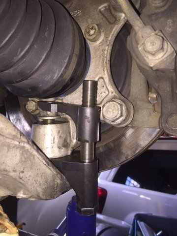

On a C5 left rear lower ball joint.
Got the Kent Moore Ball joint removal tool J-42188-B fully torqued and the ball joint won't budge.
Would appreciate any suggestions on how to remove the lower control arm without damaging the ball joint.
Thanks
Left Rear Lower Ball Joint

A big hammer to strike the control arm. The vibration can help loosen the ball joint from the spindle.

I use a 6lb sledge to wack the hell out of the knuckle where the ball joint comes through. Usually after 2-3 swings it pops loose.

I used PB blaster lub waited 15mins and put a torch on the spindle, both pop'd out in 30 seconds. Of course the ball joint tool pressure helped.
If it hadn't worked, the 6lb sledge was next
Thanks
