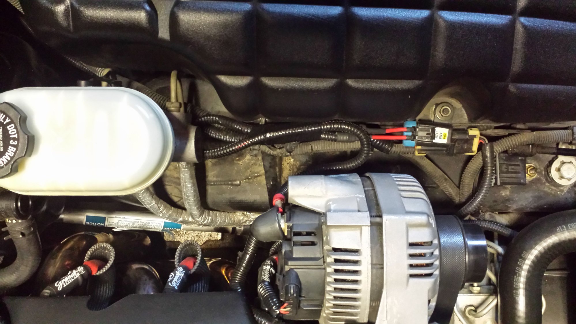

Posts: 113
Likes: 6
U can run it either way I personally ran mine through the rockers so I could use the ground for the 12v fuse part on the ground by the alternator and head lights. Then looped it to the alternator (+) ....looks really clean that way...I'll see if I have any pics to show if not I'll take one when I get back home tomorrow

Old Jun 9, 2015 | 07:57 PM
rodsvet's Avatar
rodsvet
Joined: Sep 2008
Posts: 660
Likes: 17
From: Tustin California
I think I will copy the way you did it. Thanks for the pics, it makes it easier to picture what to do. Rod

Old Jun 15, 2015 | 09:30 PM
rodsvet's Avatar
rodsvet
Joined: Sep 2008
Posts: 660
Likes: 17
I bought the Casper's hot wire loom for $49. It was totally a plug and play deal. I followed C.Whites idea and ran it through the rocker panel. At start up it idles at 62 lbs.. Keeps a constant 59+ at freeway speed. Drops to 55 at full boost momentarily and then recovers to 58-59. My sending unit for the boost gauge may be a little off after 6 years under the coil cover. It's an excellent upgrade if your supercharged, and even it you're not. It took 1 hour and two silver bullets start to finish. Rod
