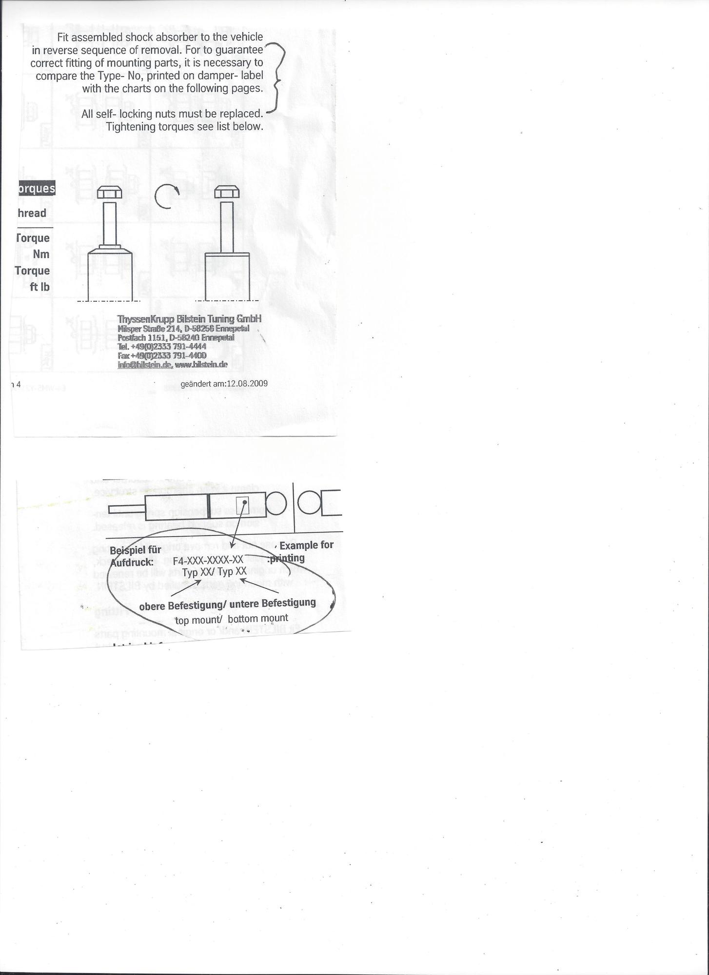

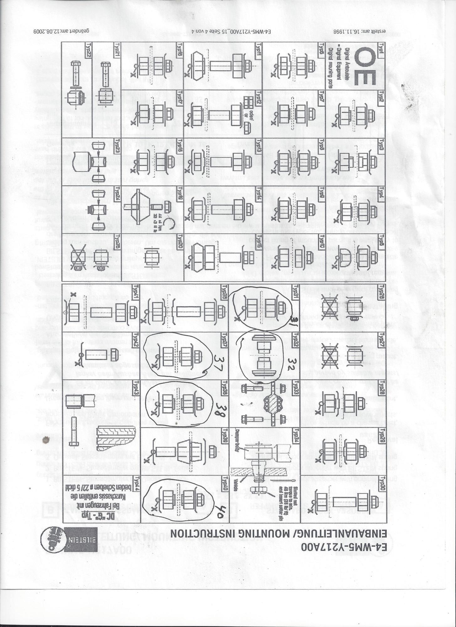

I am putting on some DRM Bilstein shocks on my C5. On the rear shocks, which way do the washers go. I will attach part of the instructions which shows several variations on the way the washers go. I did the right side and did it like number 32 but then realized it could go other ways so I don't want to do the other side until I know which way is correct. The instructions say to use the type listed on the shock but my shock does not show a type number.

32 is correct. The little steps on the bushings face together on each side of the mount and the washers are mounted cupped towards the bushings.
