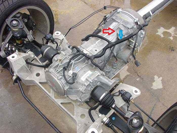

During this I noticed a "vent" line hanging down. With flash light and mirror I tried to find where it came from. No joy. One pic shows it hanging with both ends indicated. Second pic is where I pulled it on garage floor. Both ends are cut at an angle. The "T" connector is attached to Check valve.

Bad, I finally found where the line connects and got it connected (lot of fun). I have inserted a pic of a rear end with the body removed showing how it attached and routed. Red arrow shows where it attaches to the top of the tranny and the blue arrow shows the position of the check valve. VH
