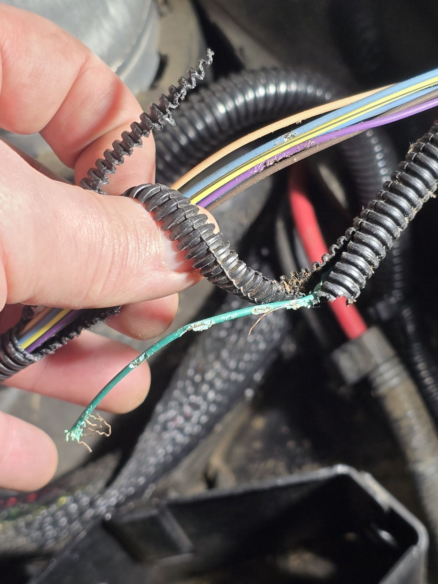

I think I found the problem, lol. Pulled the battery shelf to check the ground and found a whole mouse nest up against the ECU. They chewed through the TAC harness sensor 3 ground going to the PPS. Opened up the wheel well to pull the cable and found a corpse (and sucked a few more up with the shop vac).
TAC Ground
PPS Sensor 3 line (dark green)
Will have to fix this tonight/tomorrow and update.
