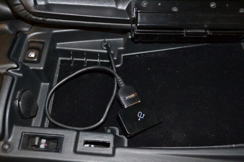

FYI... the stock stereo isn't all that bad... the speakers suck and so does the FM/AM... Cd's are a pretty good quality...but, IF you want to do a simple upgrade Dennis @ Double D mods a Forum vendor has a Kicker plug and play replacements for the speakers and you can very simply add bluetooth, to your stock radio... here are the components. He also sells the adapters and bluetooth receivers...
winds up looking something like this... I just leave the Bluetooth receiver in the console...
Along with some sound deadening is sounds pretty darn good. We love it and only spent about $200.

Thank you so much for the options!!! I may look at that in the meantime. I really was disappointed that this beautiful car had the same exact radio as my 97 1500 Silverado. The look I'm going for will definitely have to take some time as I will need to replenish the $$ for it. Double D is exactly who I was looking at for the double din bezel mod though. Nice work and thank you so much for the info! I didn't know of this other option.
Have a great day!
