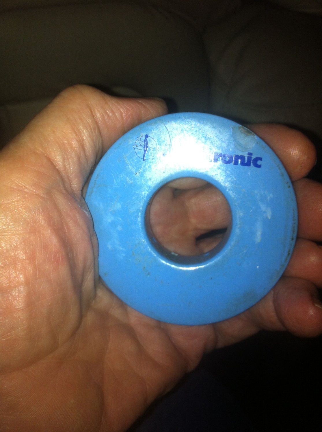

I used the magnet from Medtronic the purpose of which to disable my pacemaker. Worked great to reprogram TPM's PS - Tire dealer's machine would not do it.

Other than oem, most replacement sensors CANNOT be triggered with a magnet.

Just went through this when I replaced 2 back tires.
I bought 2 new sensors (gm part #25773946, $51.24). The original sensors were 11 years old.
The big problem is the old ones were too weak when doing the "TPMS training". The receiver could not hear them.
If you have a scanner radio, tune it to 315 MHz - you can hear it work. Put the round magnet on a (schrader) sensor tire stem, it will broadcast a series of pulses. This is the ID code.
I could use a $5 magnet from harbor freight to set them off. But it would not work on the old sensors (even though I could hear them on the scanner).
Then I bought the OEM magnet ($15 from tire rack). With that magnet, I finally got them trained. It worked in the morning when the outside temps were lower (around 75dF). It did not work in the afternoon when the temp was 100 dF. Maybe the sensor battery was
stronger early in the day.
Good luck.
