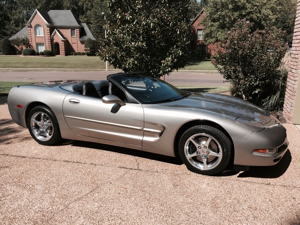

I just took delivery of a new to me '01 Vert, 21,000 miles one owner. It's perfect in every way except the a/c fan shuts off, or at least rolls back to lowest speed, when set to #3 speed. Positions 1,2,4 & 5 work normal. Thoughts on driver of problem. It is the standard control system, not dual zone.
I'm up to speed on C-3 systems, but this is my first C-5. Any guidance is appreciated.
