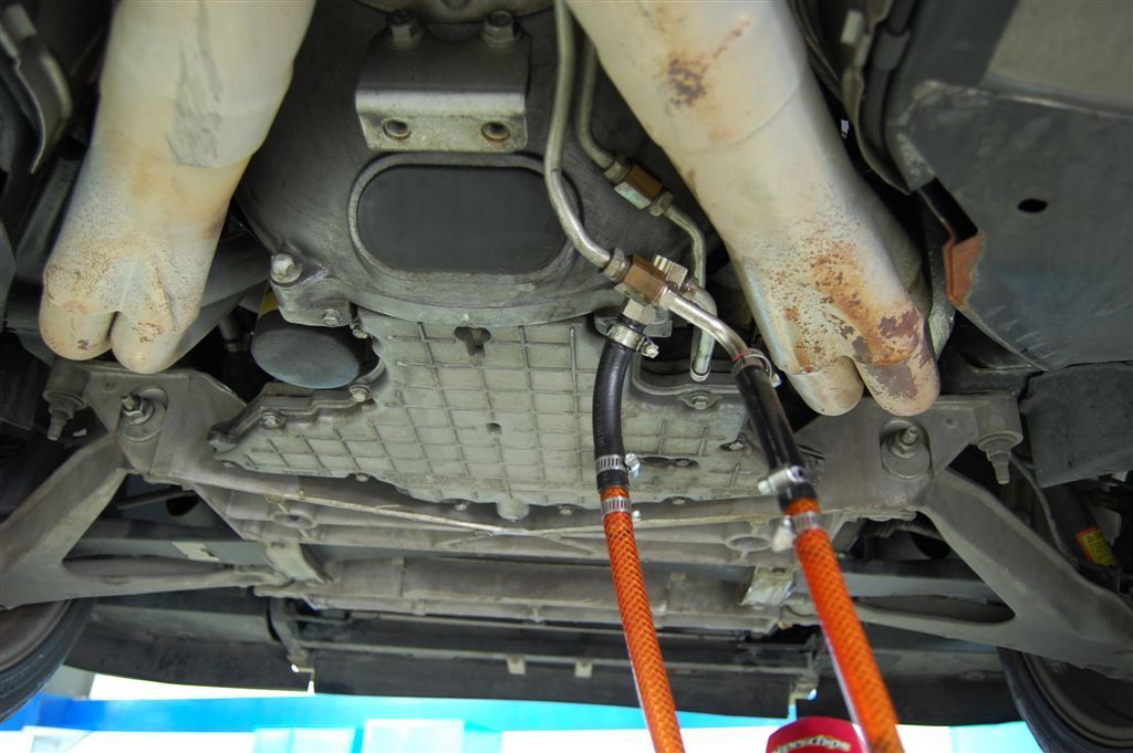

I just had the motor out of my 2001 auto. The Cooler lines run along the right side of the engine block and are bolted to the engine block behind the starter. There is a junction behind the bell housing where you could splice in a braided line or lines. Here is a picture of that area
that is the junction where the brass fittings are I was talking about
