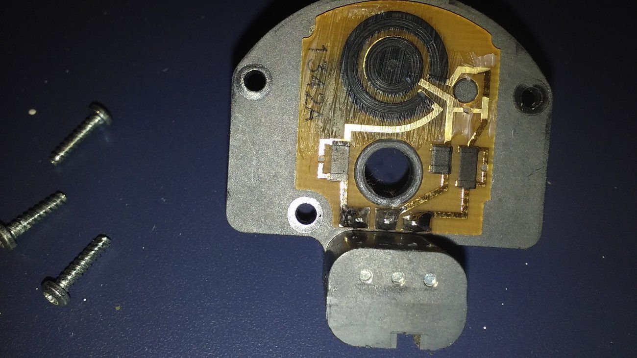

The memory contacts in the seat motor can become gummed up and then the memory function starts doing uncommanded motion or does not move.
If the contacts are becoming gummed up, a way to diagnose is to run the seat full limit back and full limit forward five or six times. This MAY give temporary return to normal function.
The fix is to remove the seat, remove the motor and clean and re dielectric grease the contacts.

I've repaired mine by cleaning the potentiometer contact surfaces. The OP may want to ensure the wires are still good in the door accordian area. Lots of threads on doing all this......
