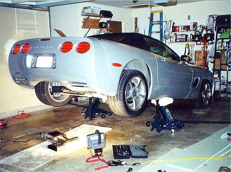

Your and my timing must be aligned w/ the stars. I just remove one of mine (muffler only) using just a floor jack and jack stands. Take your time and don't forget the jack stands.

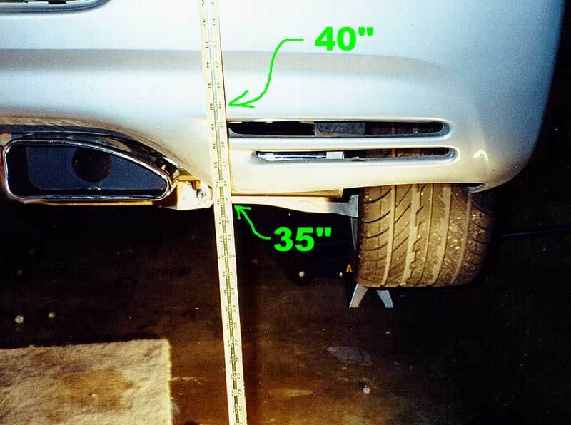

You'll need to get the bottom of the rear fascia quite high to remove the stock fatback intact. Be very careful - safety first, last and always.

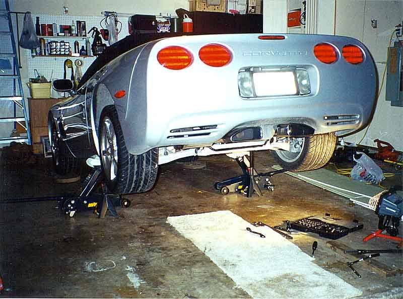

Wow, safety first... and that looks scary to me! Looks like she wants to roll.
That's another members car from years ago. Here's how I roll . . .

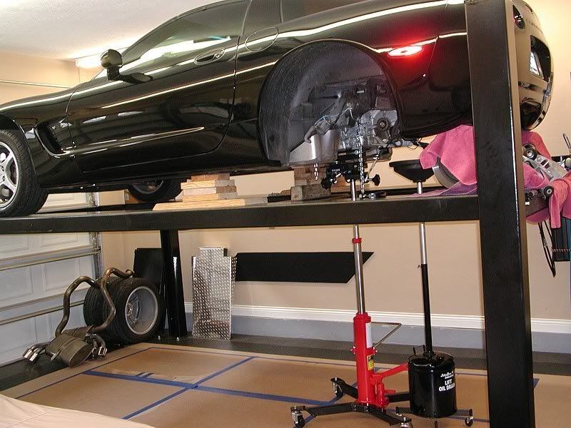

With a lift, you really shouldn't have any problems removing the mufflers.
