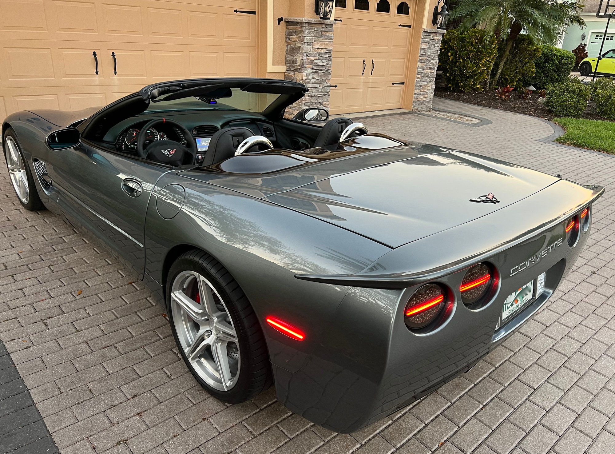

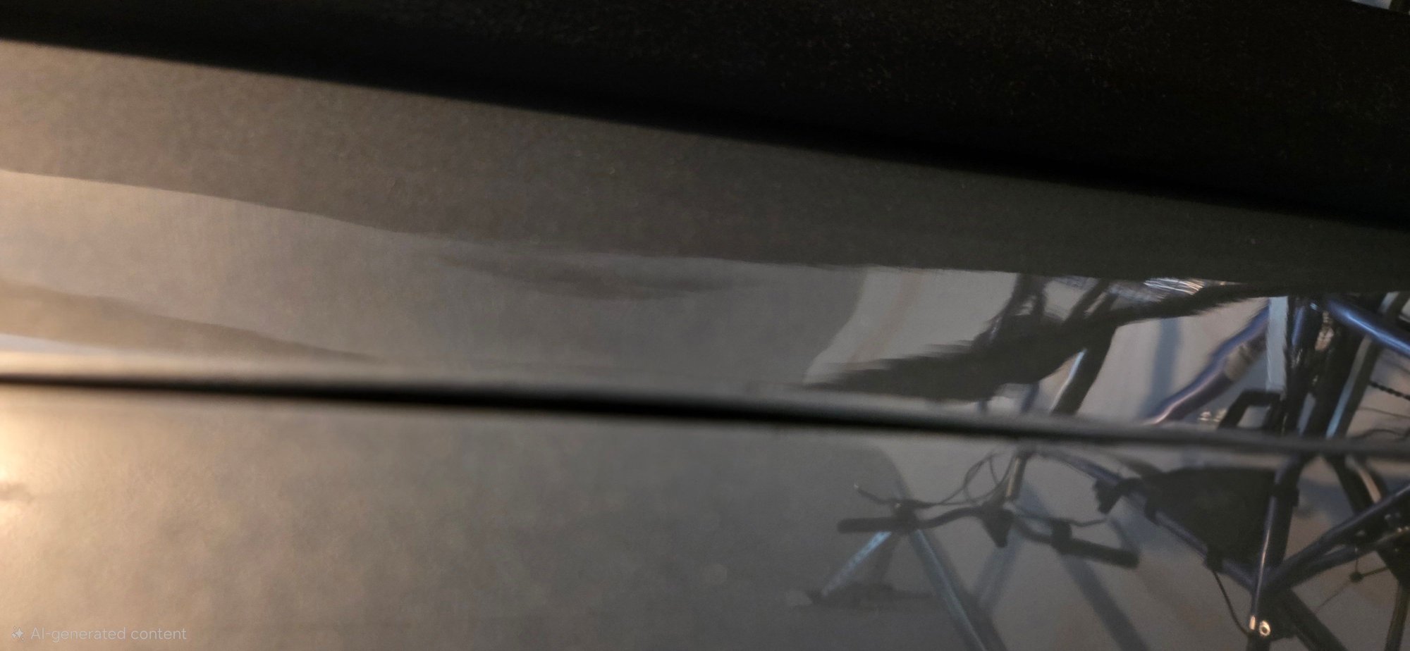

I noticed that the decklid between my tonneau cover and my trunk has a raised section in the middle. I know that this is due to the rubber support bumper, similar to the two rubber hood support bumpers, being pressed up too far. My question, is how due I adjust it? I opened the trunk and it looks like I can stick a tool up through a hole underneath the bumper, but what kind of tool? The front hood support bumpers have a bolt that you loosen/tighten to adjust. Does this bumper have a similar bolt and how do you reach it?

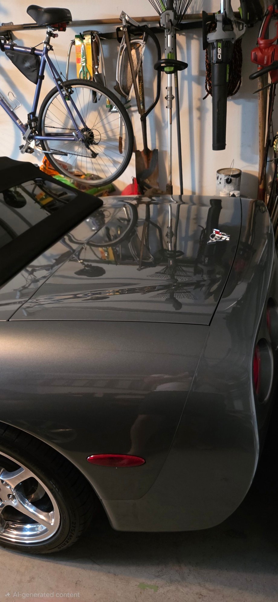

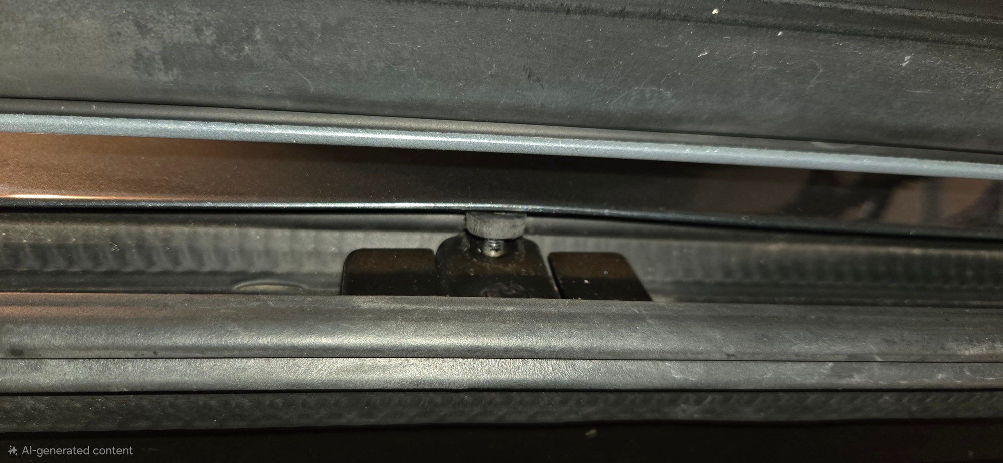

Thanks. Below are a couple of more pics that futher explain what I'm trying to accomplish.
The first picture shows the bolt/bumper that I need to screw down so that I can slightly lower the tonneau section so that it's even with the trunk. The second picture shows how it appears now with the trunk closed.
The issue is that I just can't get a vice grip or pliers and try to turn the bumper without ripping up the rubber. The ones in the front hood section each have a nut that you screw to either adjust up or down, however I don't see a nut for this rear trunk bolt/bumper.

Looks like a Allen key, probably adjusted from the top with tonneau cover open.
I would spay or with some kind of thread lube, make sure you have correct size Allen key and turn it to adjust. Mine is an 01

I'm the OP for this thread and I was able to make the adjustment to reduce the upward pressure by turning the post with an Allen key per the picture above. My original pics showing the slight raise in the rear section that lined up against the trunk have long been deleted off the host server but I was able to get the seams to line up flat.

Thanks for your reply and direction. It must have been an issue with this color C5.lol. which size Allen key? Also i have attached apic of the adjustment screw that i am trying to adjust.. BTW your c5 looks fantastic. I am going to have to up my game.
