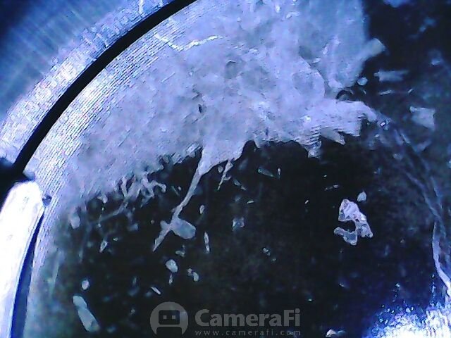

Well I found out that #8 piston cracked at the too by the ringland,and I've noticed coolant on the bottom of the oil pan.

Borescope revealed this...
Looks like a valvetrain problem with a valve kissing the piston.
