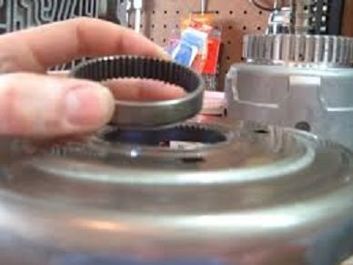

I'd think broken sun shell or stripped rear sun gear. The shell is prone to breaking or stripping the splines where it attaches to the rear planetary set.
I'm sure a 4l60 guru will chime in soon.
In the picture the piece he's holding should still be attached to the sun shell.
