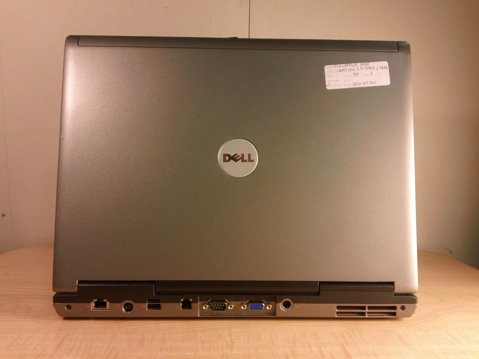

Here is the Tech Specs listed for the Lap top:
Model: Dell Latitude D830 Laptop
Processor: Intel Core 2 Duo T7700 2.2GHz
Graphics: Onboard
RAM (Memory): 3GB
Hard Drive: 80GB
Optical Drive: DVD Player CD Burner
Ports: 4 USB, Audio and Mic, Ethernet, VGA, S-Vide
Not seeing a Serial Port on the pictures of the Dell.

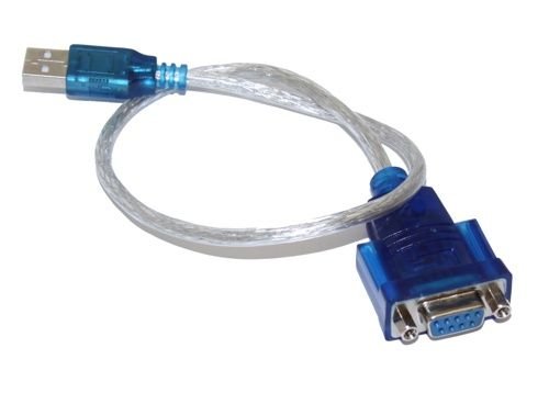

are you referring to these adapters ?
http://www.obd2tech.com/50-vehicle-t...er-4-in-1.html

that is the opposite of what you need: Here is a pic of what a serial port on a laptop looks like,
Here is the adapter that hooks the tech 2 to your laptop,
I have not hooked my tech2 to my car due to weather around here but I will as soon as it warms up.
From talking with others they tell me that a usb to serial adapter does not work properly. They do make a usb to serial port female adapter but that is what I have been told does not work well. I will go to the local dealership and talk with the tech there. I know that they no longer have xp laptops, have all windows 7 32 bit. I will let you know something tomorrow if we don't get to much snow here.

I just looked at the description pictures of the laptop you are looking at and the picture shows a serial port just like you need.

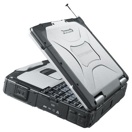

Cybermind's Avatar
Cybermind
Joined: Apr 2009
Posts: 2,479
Likes: 36
I just ordered a refurbished Panasonic Toughbook CF-30. These are military grade laptops that are almost indestructible. There are tons of these available and make the best garage laptop possible. Look it up on Google. You can pick one up for about $300.
I sent the seller a message and got a reply back this morning. Never noticed the Serial Port on the back of the P/C, I was looking at the sides for one !
I purchased it !
