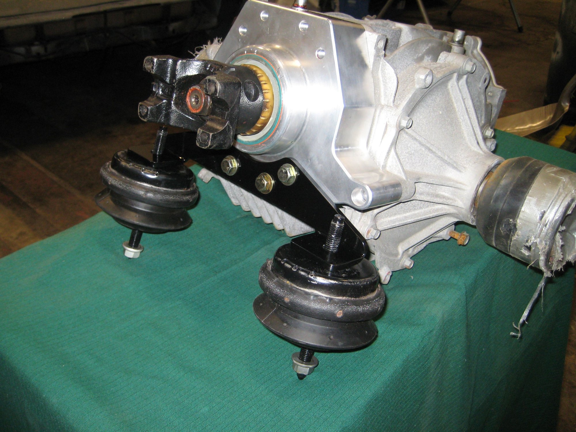

CHASSIS CONCEPTS makes what you need for $1,725.00. Check it out on their WEB page http://www.chassisconcepts.com/diffadapterc5.html
Sweet. Have anyone tried this kit?

Well, will you look at that... Pretty badass.
