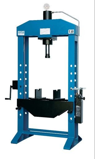

I used a Hydraulic Press to install mine but I don't see why it wouldn't work.
When I replaced all of my ball joints I purchased a used set of knuckles off of a wreck. Removed the ball joints using a press as pictured above and used a Hyd. Press to install them. I guess the only thing with a Press kit like that is to make sure it's all lined up properly before you use the impact wrench to press the ball joint in.
