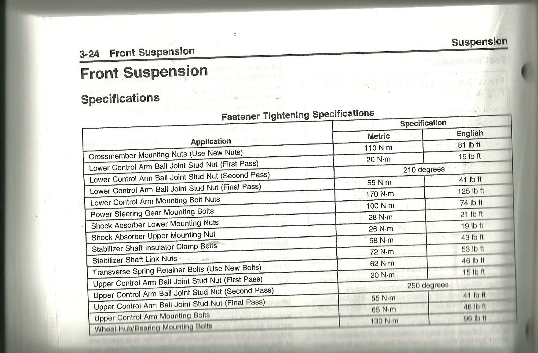

Since I do not have a Service Manual for this car, what are the torque values for the three hub bolts, lower control arm ball joint, sway bar bolts??
Appreciate it.

NealB's Avatar

Thank you NealB....interesting....on the lower ball joint stud nut...can you tell me what the book says is supposed to be performed between each pass? A bit at a loss as there is only one nut to tighten...???....not like I am doing a head bolt tightening sequence here....???
On the first pass you tighten it to 15 ft. Pounds.
The second pass in in degrees and you turn the nut 210 degrees.
Then on the final pass the torque is 41 ft pounds.

zachaeous: OK got it....wanted to make sure that by "pass" there was not something else that needed to be done in between...could not imagine what it could be....so better to ask.
Yes, what he said.
but the book says on the final pass to be sure torque is 41 minimum.
Maybe someone smarter than me can tell us why they say to go thru those steps instead of just saying 41 ft lbs

That is why I asked the question I did....does not make much sense to turn the nut 210° and then to the final torque of 41.
Like NealB...if someone could explain this to me as well......
Oh and I just put two dots on the nut itself; one at 0° and then CW at 210°. So wherever the 0° dot is when 15 ft-lb is obtained, I can put a piece of tape as a marker and then turn to the 210° dot...and then to 41 ft-lb.....still does not make much sense to me.

I asked the same question to my nephew who is a 30 year ase certified tech at the local Chevy store.
He said as far as he knew the 210 degrees is to make sure the taper is seated in the knuckle. Then the 41 ft lbs is to be sure that the nut has the proper torque.
I do remember on mine that the nut did turn on the 41 ft torque, but I do not remember how much.
