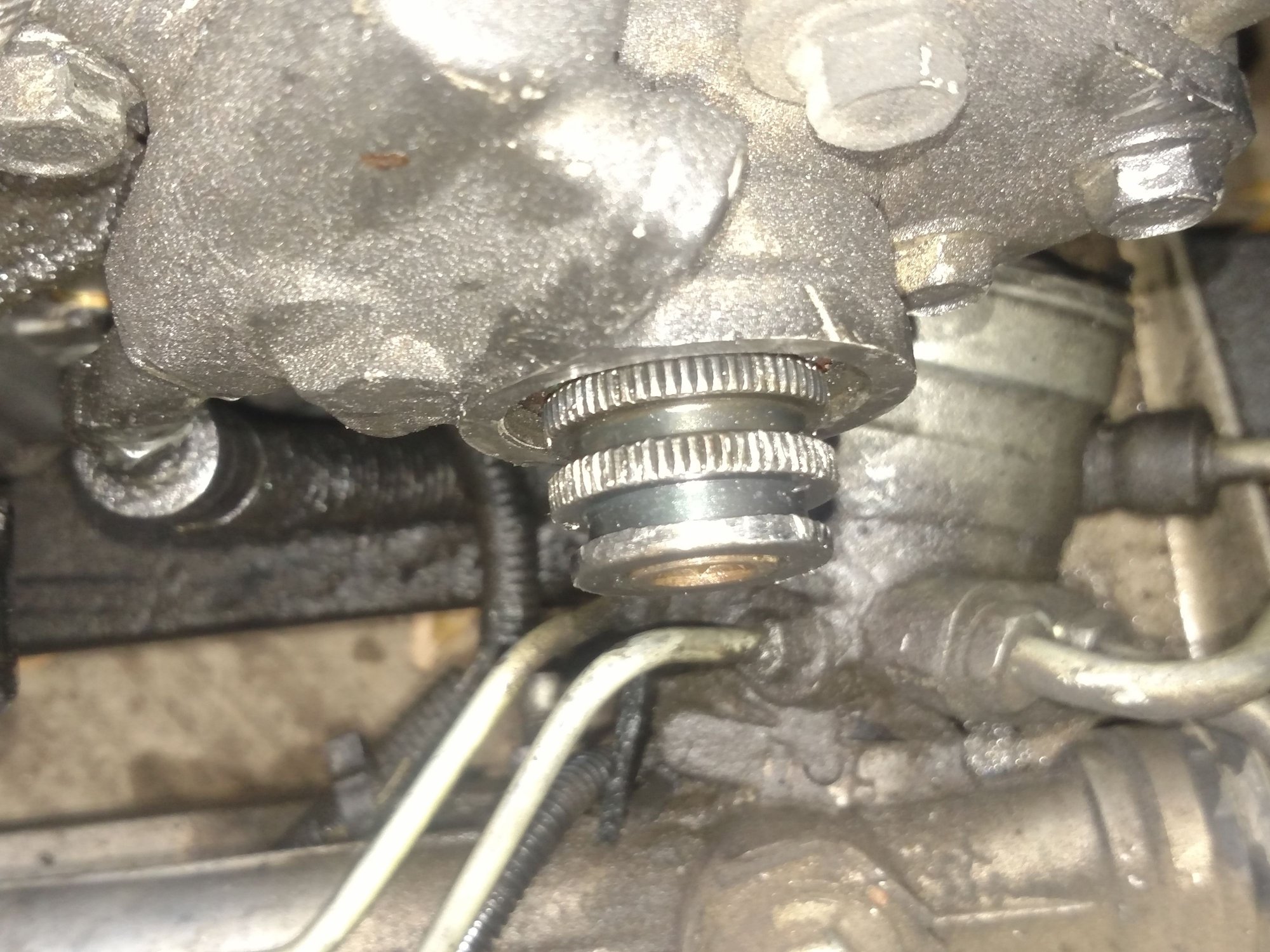

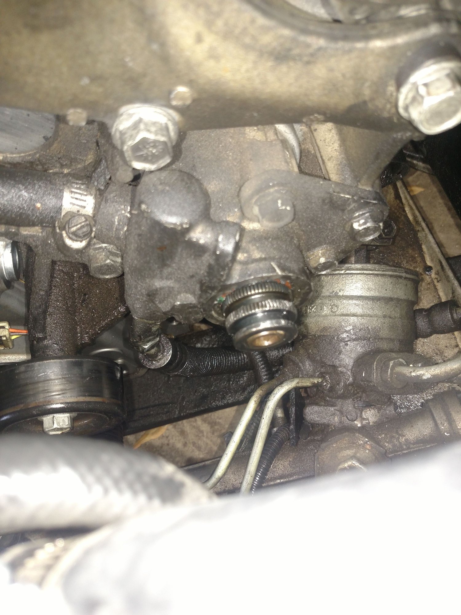

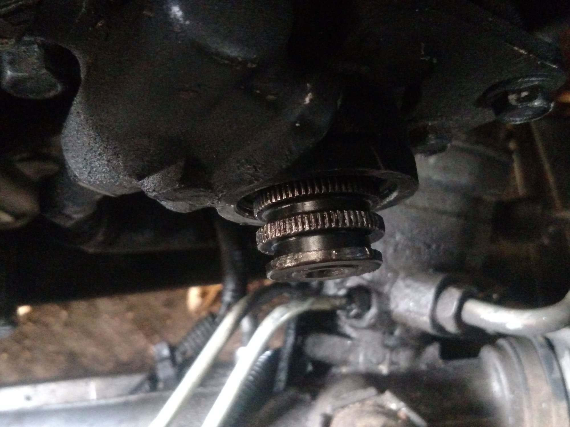

So last night my power steering pump pulley grenaded and took out the belt and reservoir with it. Something looks off to where I thought I just needed another pulley, but I see gear teeth on the pump itself, do I need a new pump or do I need to remove the teeth "they were pat or the pulley". At a lost. From a 97 Corvette with 75k miles

the piece you see on the pump shaft is the center of your pulley, you need to figure out a way to remove it... it would probably be easier to just take the pump off the car and do the repair on a bench... I also highly suggest the c6 pulley like patches mentioned that way this won't happen again

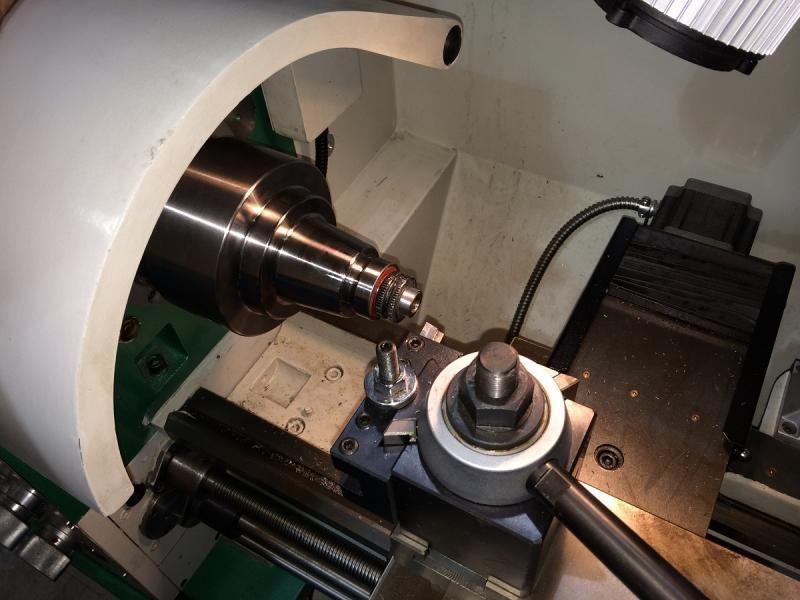

A puller wouldn't work to remove the teeth gears? How did you get it off, the stuff at your job ?
Put it on a lathe and turned it down until it weakened enough to push it off.

as far as the op's situation, a power steering pulley puller won't take off the hub internals because the jaws of the pulley will not have anything to grab onto... I would take the pump off, put it in a vice, and use a dremel or cutoff wheel to carefully cut it in half being very very careful not to cut into the pump shaft
The ring the puller hooks onto is still there. Before attempting to remove it the hard way, try putting using a standard power steering pulley puller onto that remaining hub and see if it will come off.

you're right it is still there, I was looking at patches' pic with the lip broken off and not the op's pic... try a puller first and if that lip breaks off then you can try the other method I suggested

Ok I'll try a puller first thing in am, that doesn't work take off and try another shop or cut myself, last resort buy another pump
Puller worked like a charm. When the pulley broke it destoryed the belt and reservoir as well. So right now I'm waiting on the pulley to come in.
