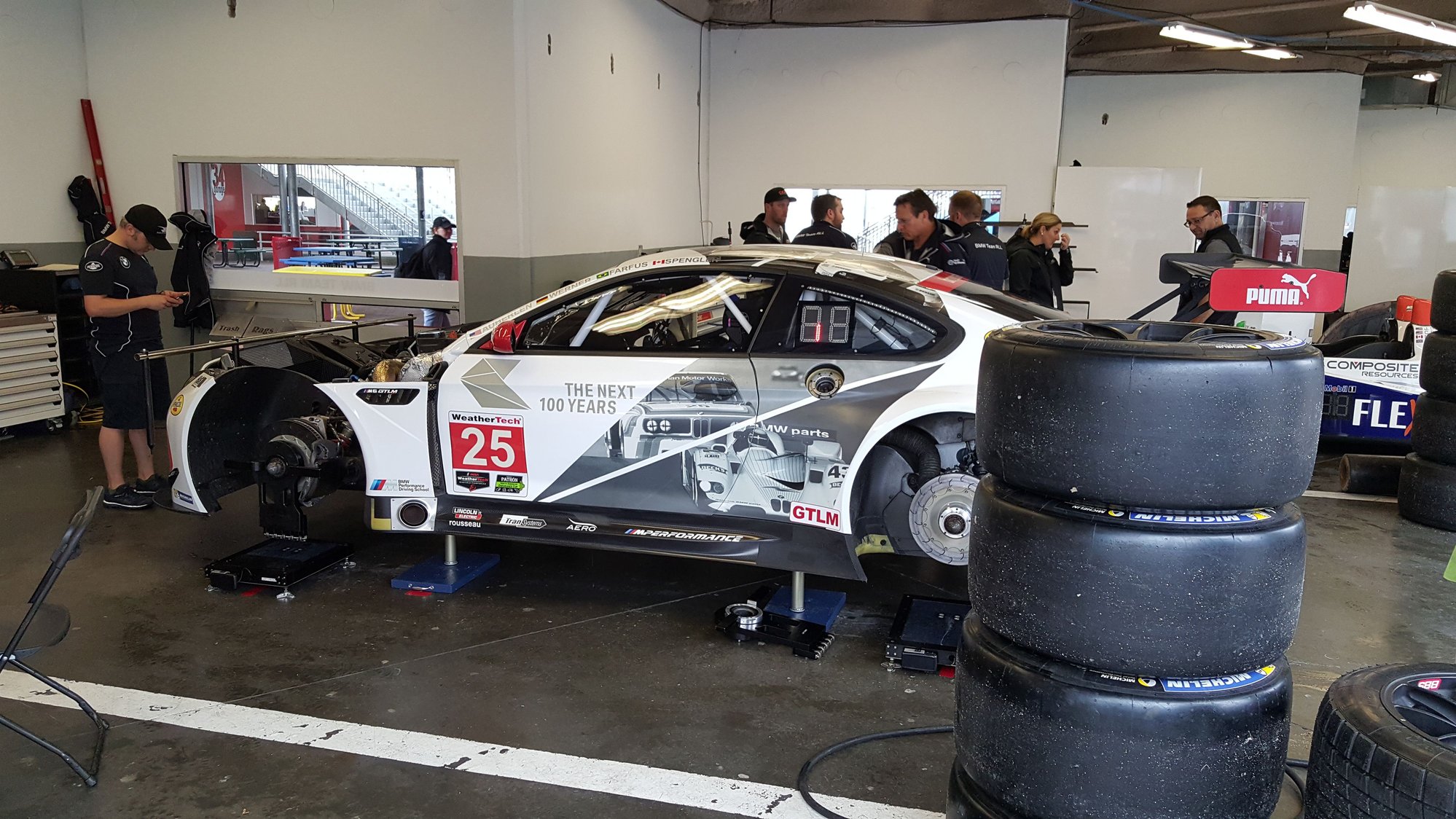

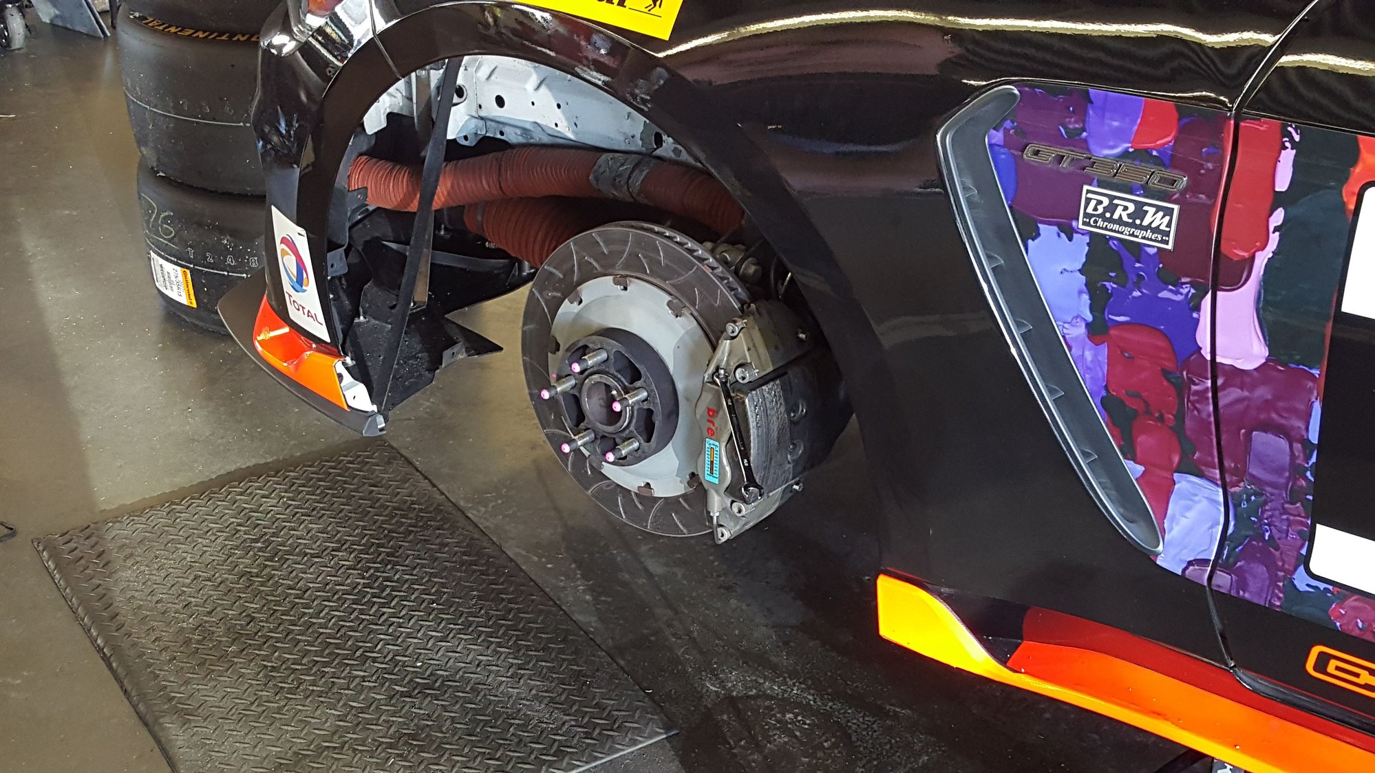

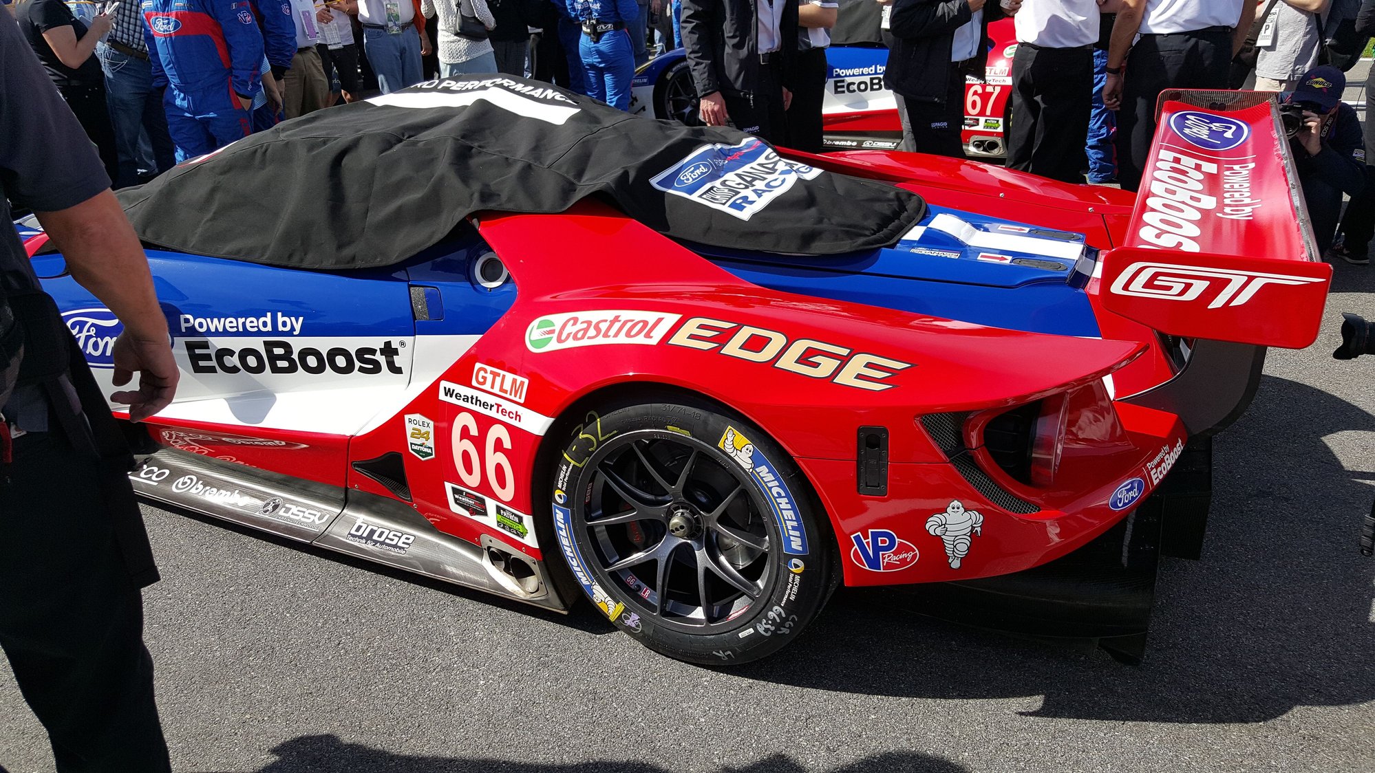

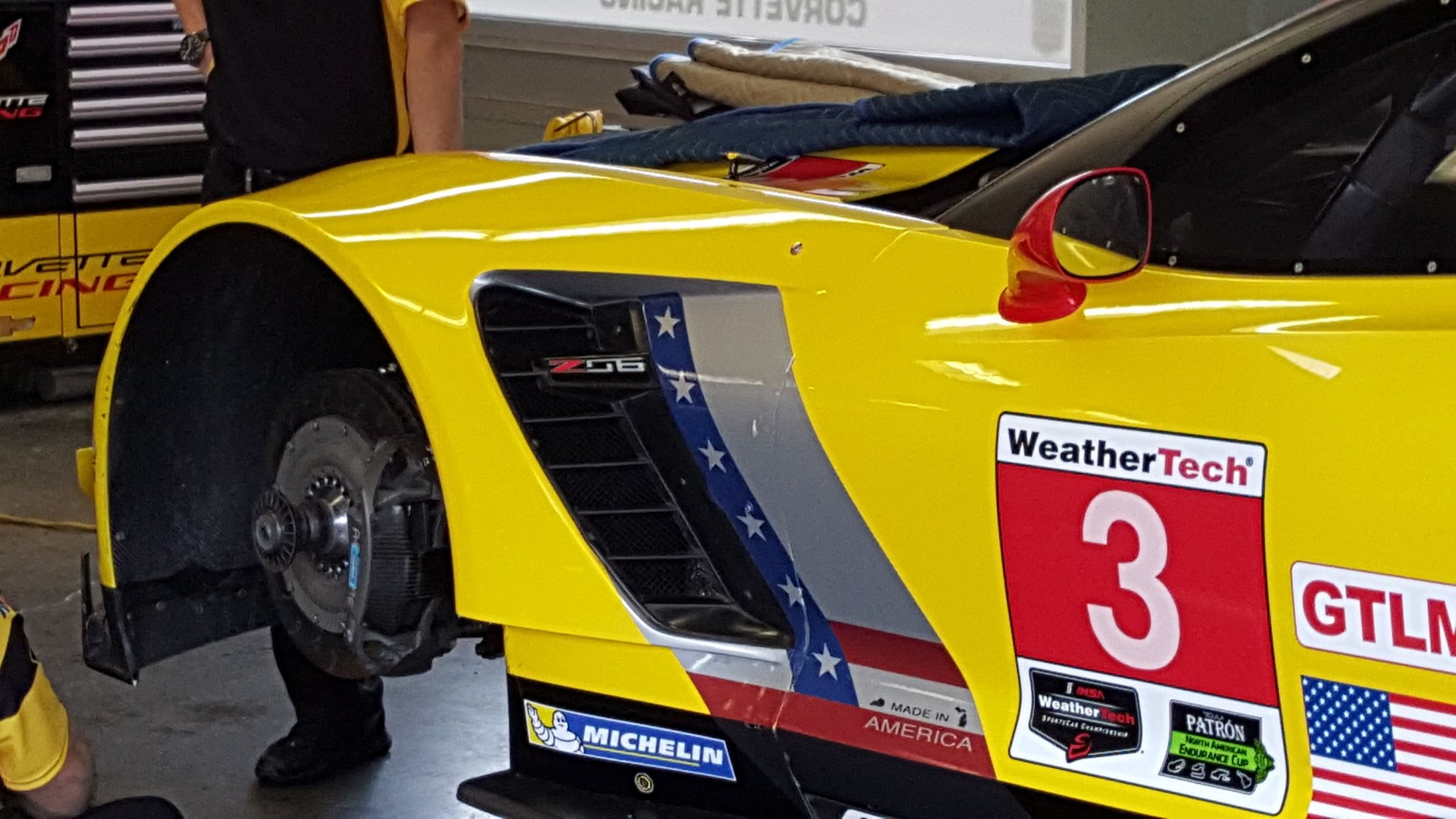

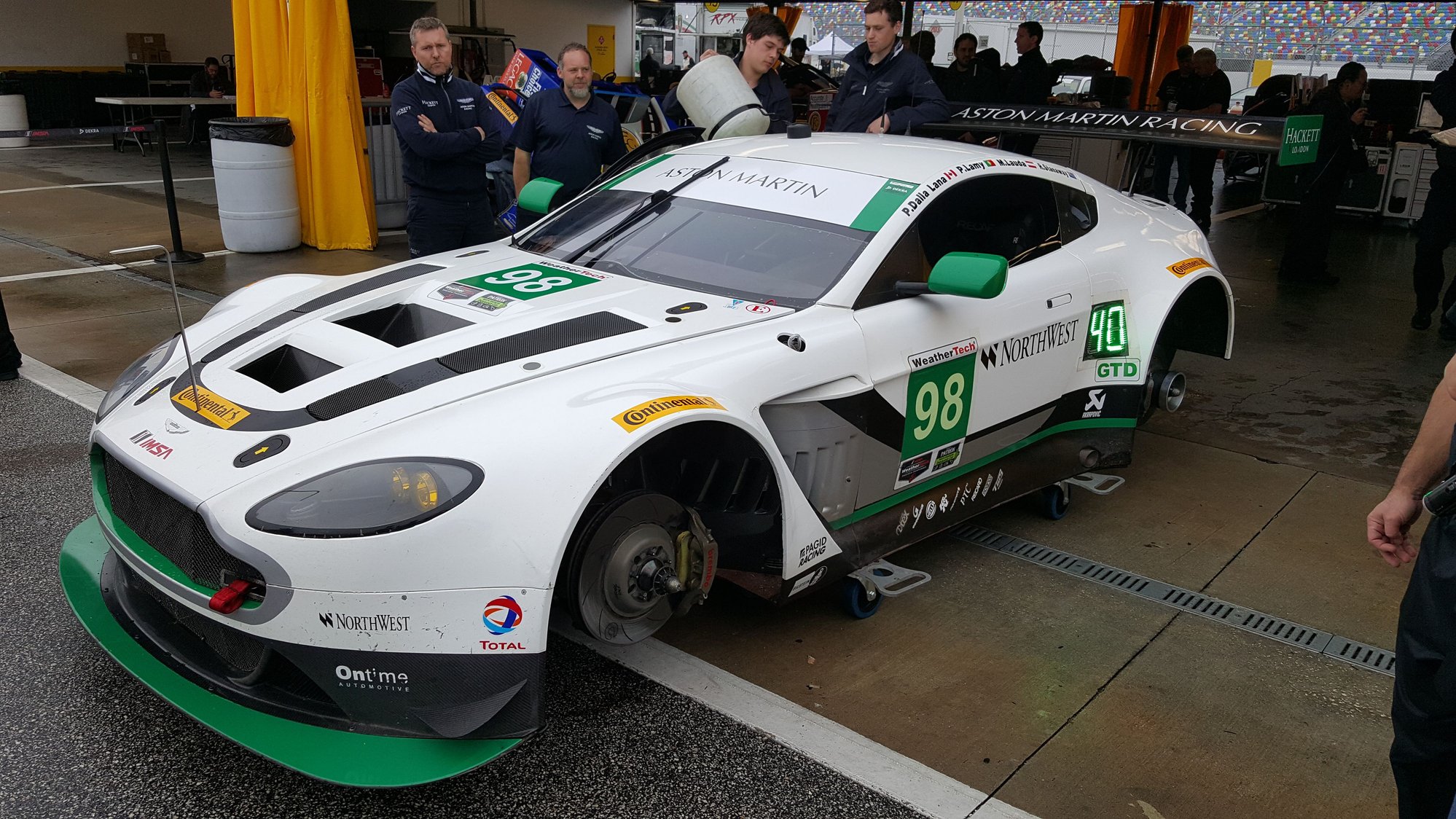

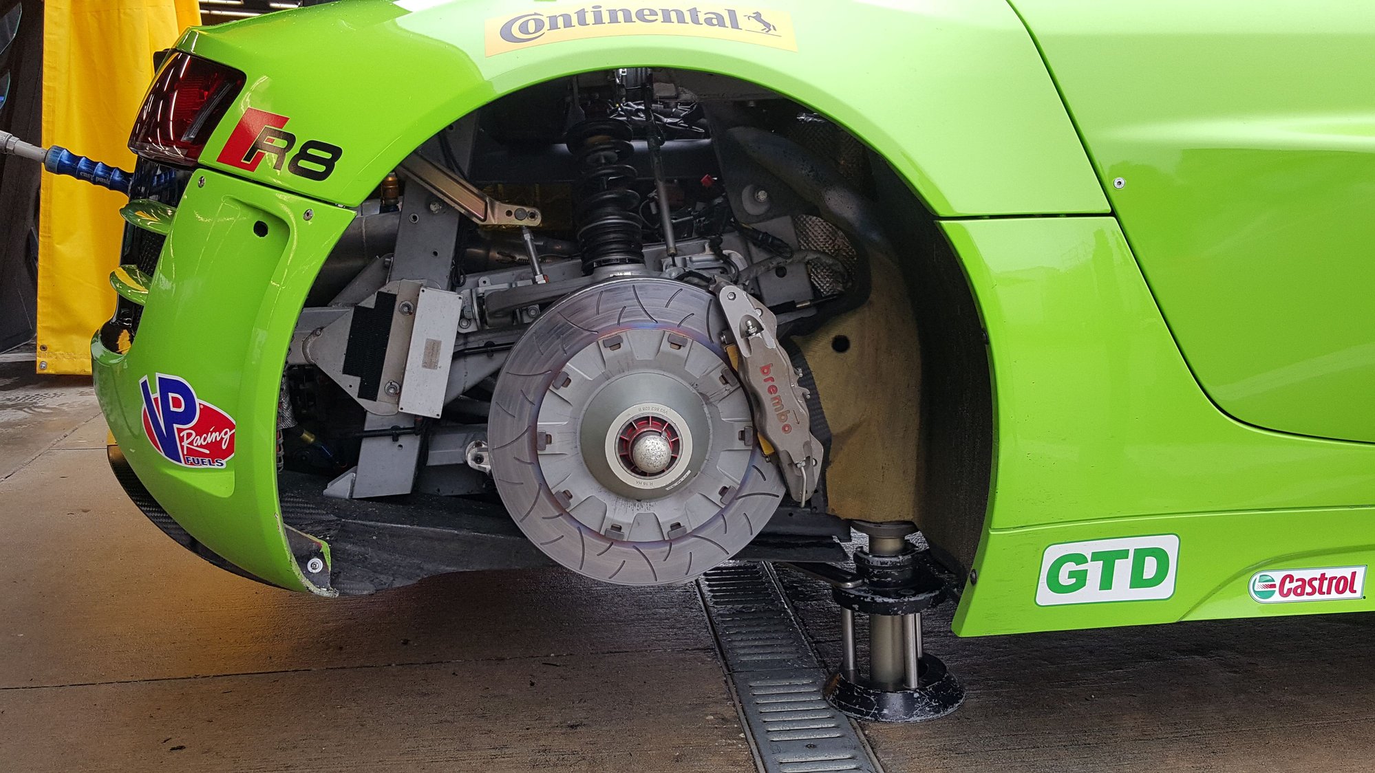

BTW, here's the pictures I mentioned. I don't have any pictures of Porsche (because I really don't care about Porsche). But I do have shots of a Corvette, M6, R8, Aston Martin, a GT350, and a Ford GT.
All racecars. None with holes. All slotted.
The ones that didn't have slots were running solid rotors. Only exceptions might be the vipers, but I don't have a good picture of their rims/tires. I have a few off angle shots and they look to have slotted rotors as well, which would imply that they take the drilled ones off the road car and put slotted ones on the race cars.
All the Prototype cars had slotted rotors.
If drilled rotors actually worked, then the "budget is no consequence" racecars would use them.
They're a gimmick, nothing more. End of story.
