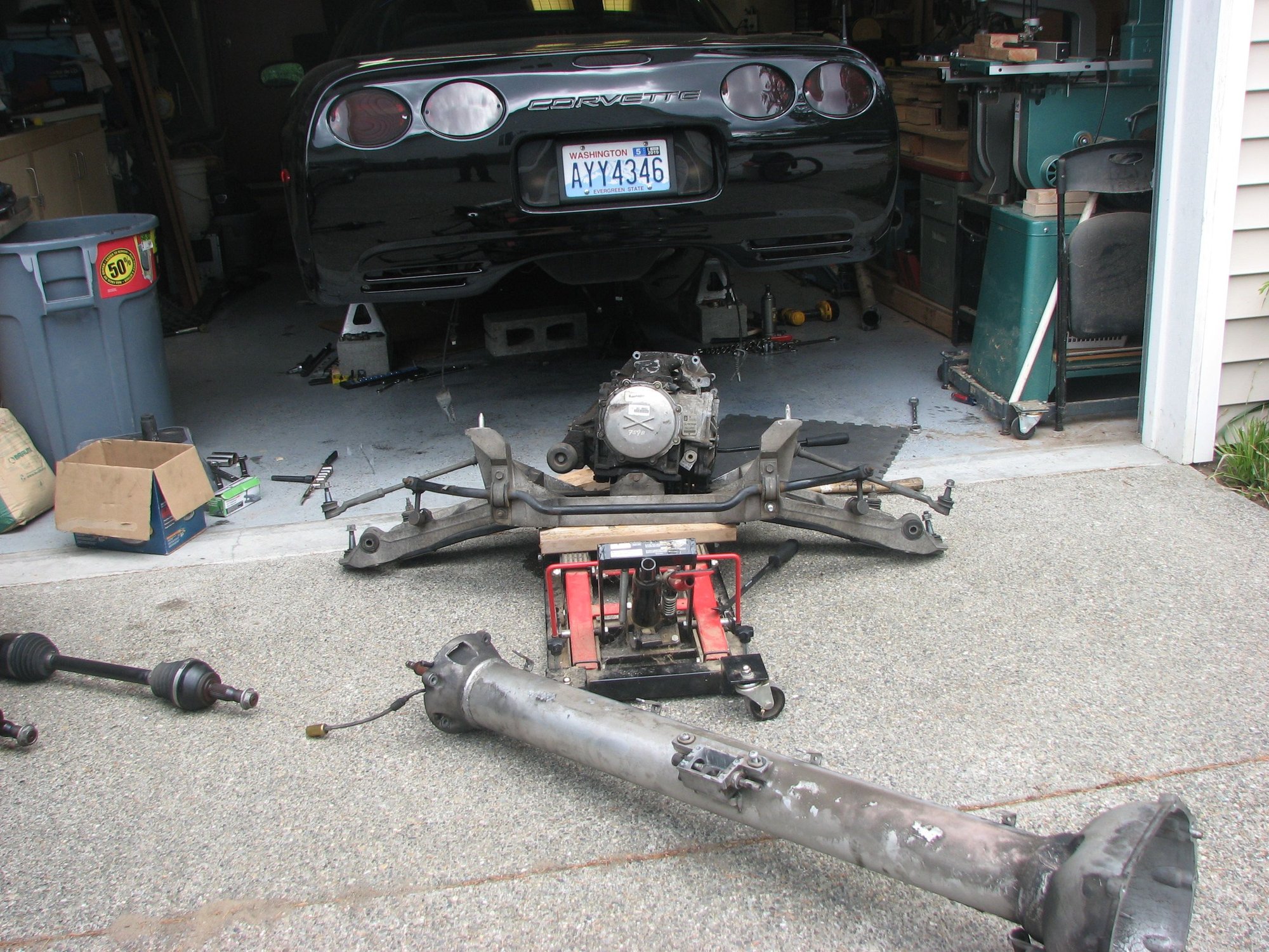

Yes, you have to pull it all out, or at least slide it back out of the way. Not really that difficult and no special tools either. replace all you can while you have it out; the slave and throw out bearing with remote bleeder, torque tube couplers and bearings, diff seals and diff mount.

cement blocks, must not value your life ??????????????

Car Rookie is right, but please don’t use cinder blocks with jack stands on top of them...
The task certainly looks daunting but it’s really not bad. If you don’t have an adequate set of tools/mechanical skill set, you’ll end up paying quite a bit of money to have a shop do it, unfortunately. It’s not difficult work, but it takes a lot of labor hours to get it done. Good luck!

I left the front wheels on and had them on race ramp blocks. I felt it was way safer and more stable than having the jack stands fully extended like yours. to each their own we both got it done and survived. the only thing I would change for next time is to put 2x6 on top of the cinder blocks to distribute the weight better. The job itself is really straight forward and only really uses basic metric hand tools. I took mine out in pieces took out the rear suspension with the diff and trans, then the torque tube. And put back together one piece at a time; torque tube, trans, diff, rear cradle, and then rear suspension as I replaced the rear suspension with one that I had powder coated and replaced ball joints and bushings.

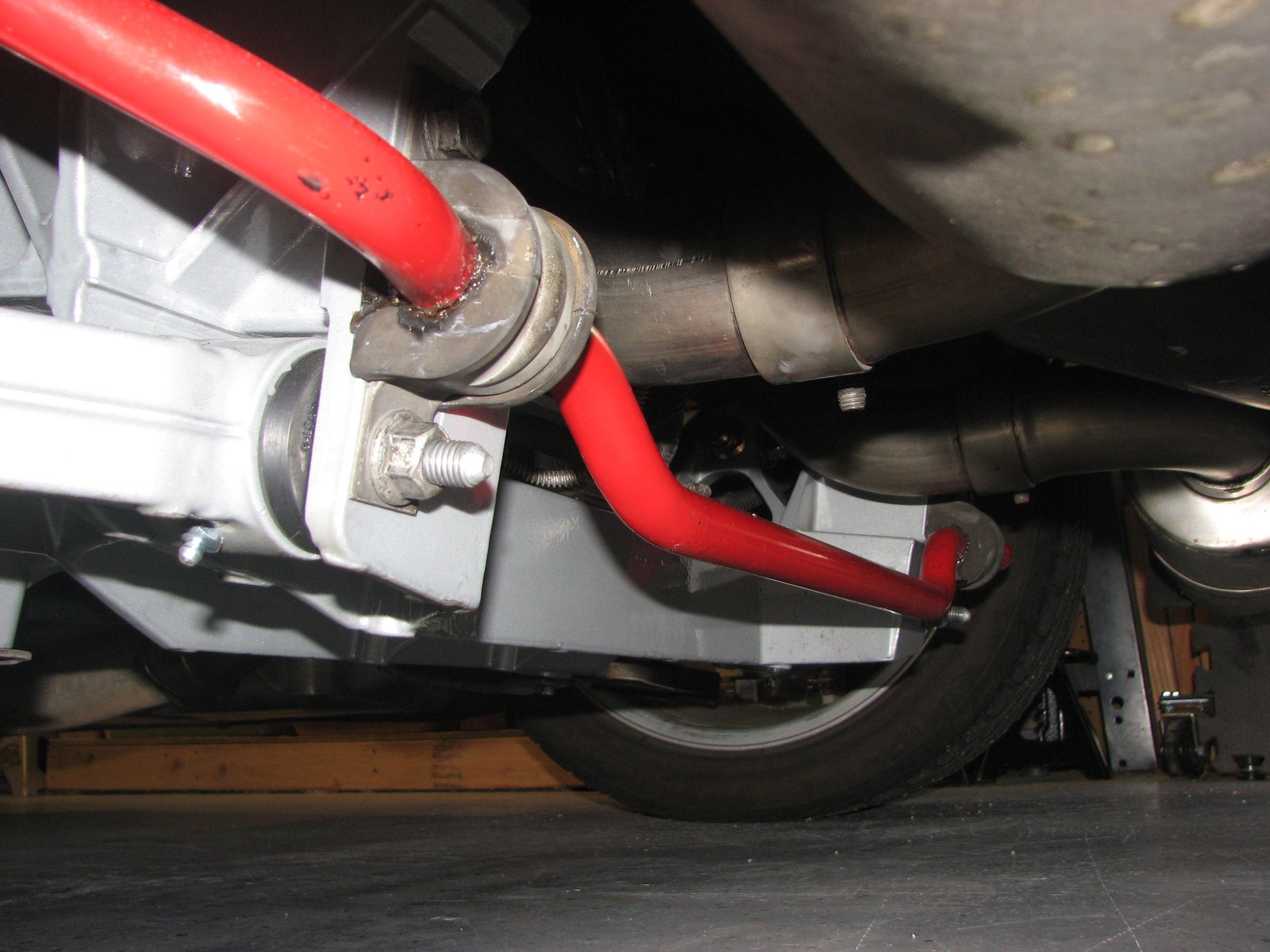

Car Rookie, did you paint your subframe? That’s quite purty!
Old Jun 29, 2019 | 04:11 PM
Car Rookie's Avatar
Car Rookie
Joined: Apr 2019
Posts: 270
Likes: 159
From: OLY WA
bought a used one and had it powder coated, so when I took my car apart there was no downtime.

there is nothing safe using cement blocks !!!!!!!!!!!!!! ( they have very little structural value unless staggered in in wall or such !!!)
