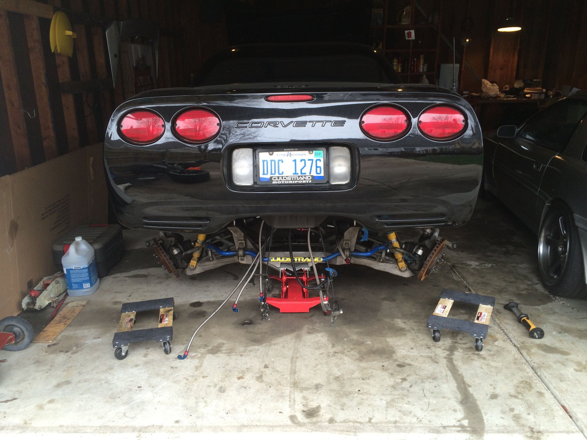

I'm in the process of doing a transmission swap on my Guldstrand/ Katech C5z, and I'm coming down the home stretch. While buttoning things up, such as reconnecting the brakes, I have run into a major pickle. Who would have thought that after having the car COMPLETELY APART, this would be my big hangup:

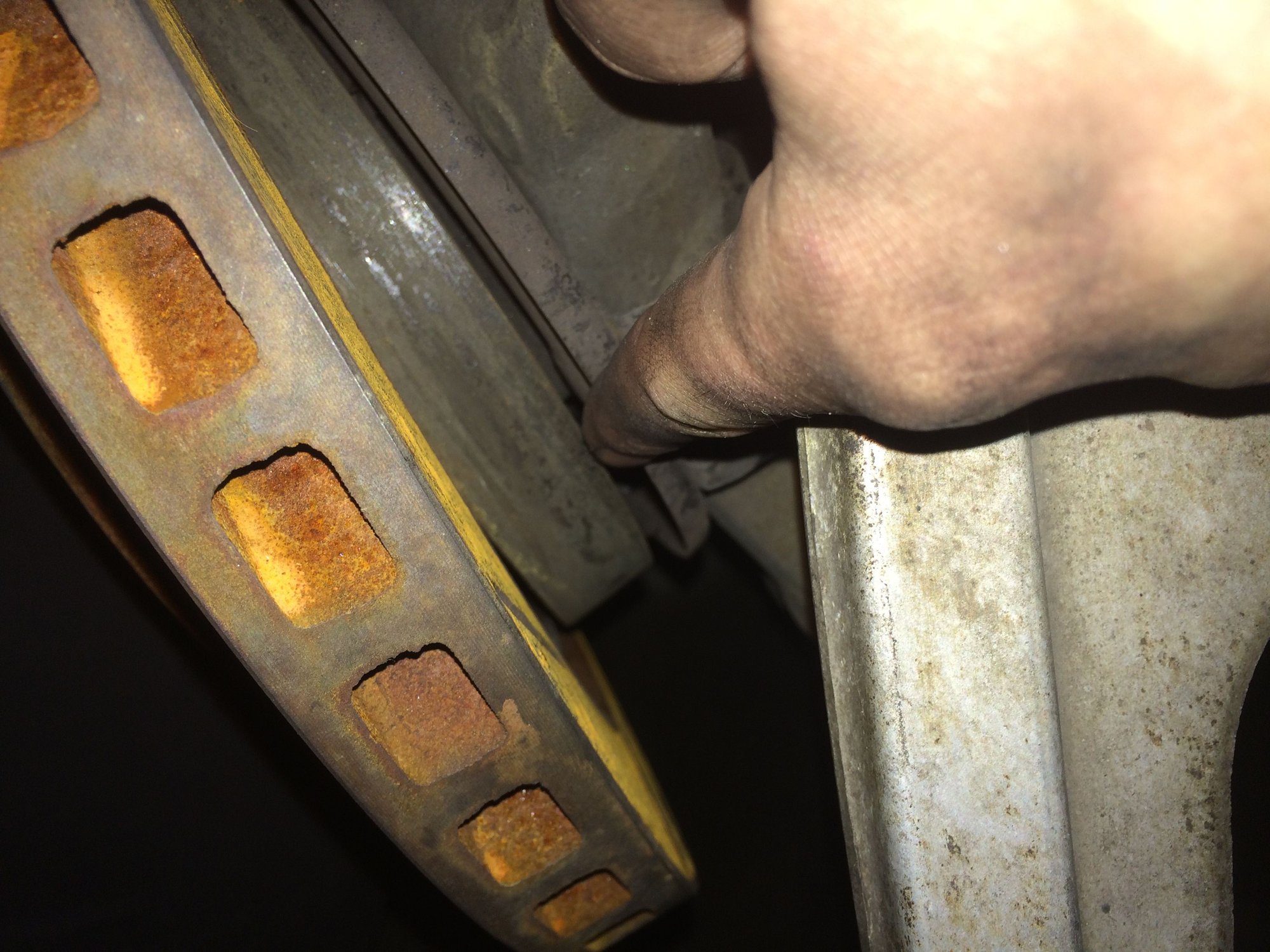

I cannot get the bolts that reconnect this Ebrake cable bracket to grab the threads in the Ebrake shoe inside the rotor, and therefore I cannot reconnect the Ebrake. All of the tutorials I found said to disconnect the line FROM the bracket, but that proved to be nearly impossible because of that ridiculous radial compression connector thing. However, I noticed I could very easily just disconnect those two bolts, disconnecting the bracket- should I not have done this for some reason?? Because these things are NOT grabbing. I have tried jacking up the suspension to find new potential geometries, slightly pulling back the rotor and prying against it with a screwdriver to get a nice square relationship between the bolt and ebrake shoe, keeping pressure on it:

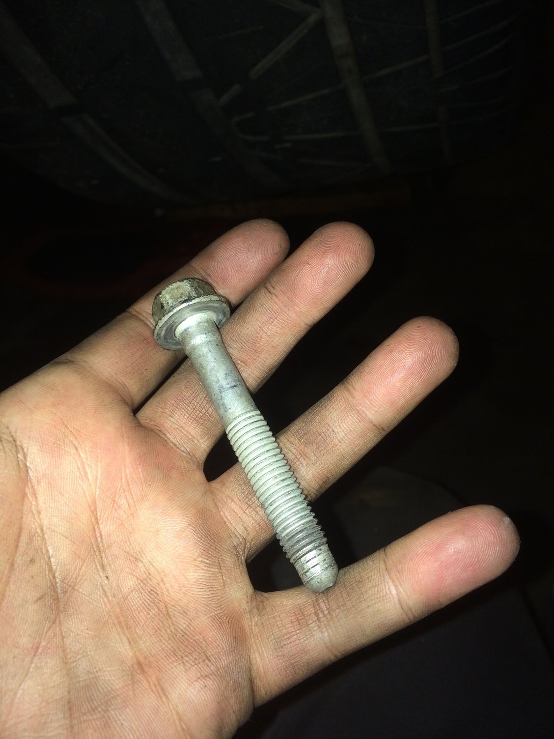

..But nothing seems to work! The only thing I can think is that the ends of these bolts are ALL stripped, because there are four of these things, and theyALL look like this:
However, they appear to be designed this way.

make sure the parking brake inside the car is released... those bolts are designed that way to help center the bolt in the threads so there is less chance of stripping them... they should go in relatively easy as long as there is slack in the cable

Sure looks like first 2-3 threads are stripped
