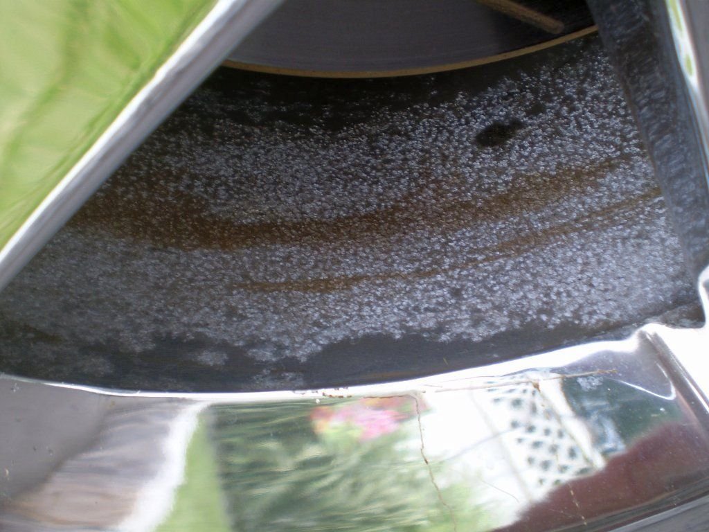

These wheels were less then 3 yrs old when i took these pictures. Take a look at the inside of the barrels.
And just in case you ask, yes they always get washed and waxed on the inside...still pitted.
i will NEVER buy from OE Wheels again !
