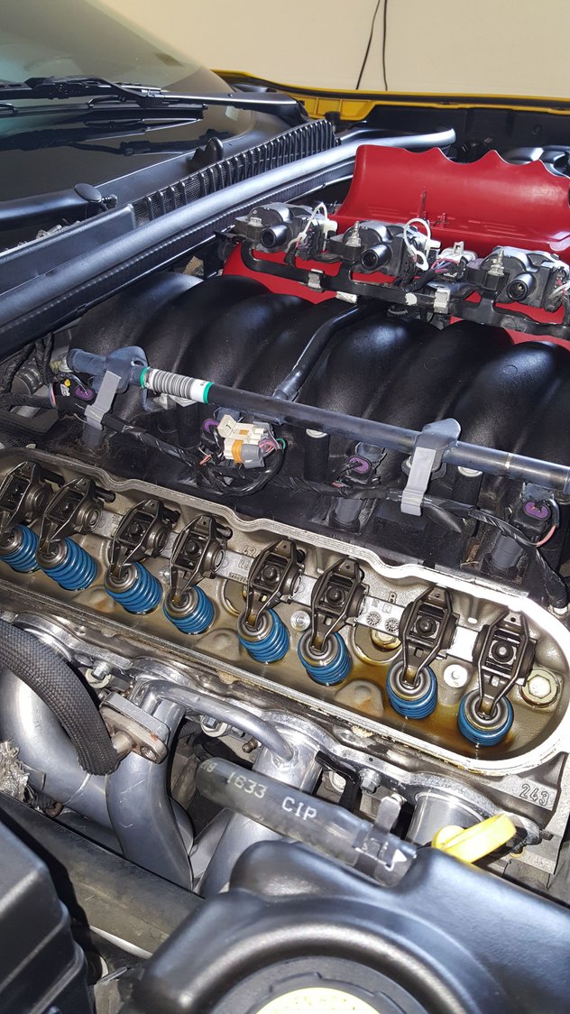

I'm going to do some work on it this weekend and try to find the source of this noise. Anyone heard a loose spark plug make this noise? I'm crossing my fingers thats what it is, but not likely.

Ah forgot that in my PM to you. Also if you pull a plug wire at a time while running you may be able to isolate the cylinder where the trouble lies if the noise changes when you do.
Good luck this weekend and let us know what you find

So far I have managed to remove all four pass plugs. They all looked exactly the same. I kind of expected one to be a little more discolored than the rest. Not only were all four tight, but they were torqued waaay the hell past 11ft lbs... which im not happy about

I pulled the pass valve cover again today and inspected. No needle bearings present, rocker bolts are tight, some rockers could move side to side a little but I believe that is normal, I couldn't manually push any of the rods back down... this is aggravating as hell. At least the top end looked really clean.
