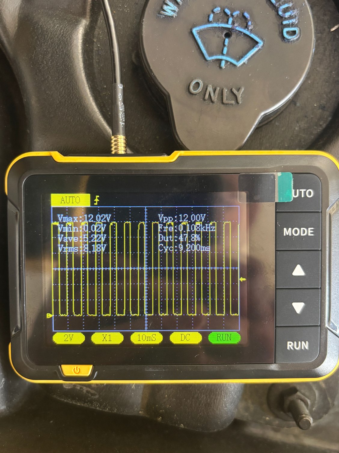

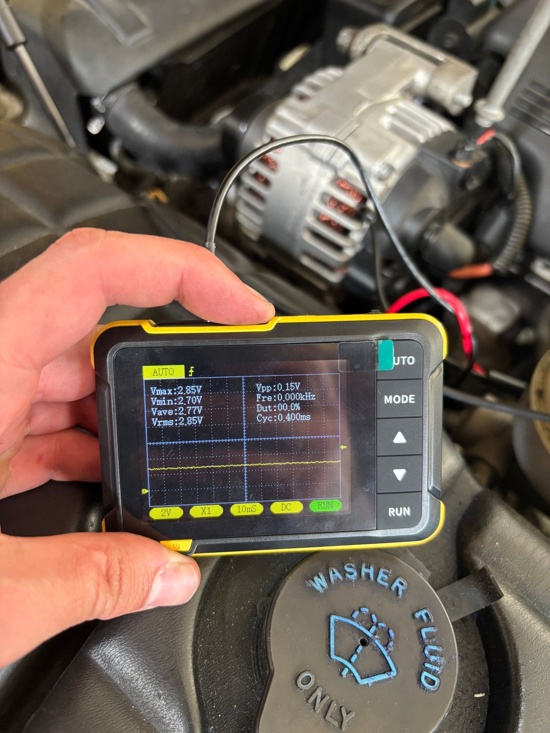

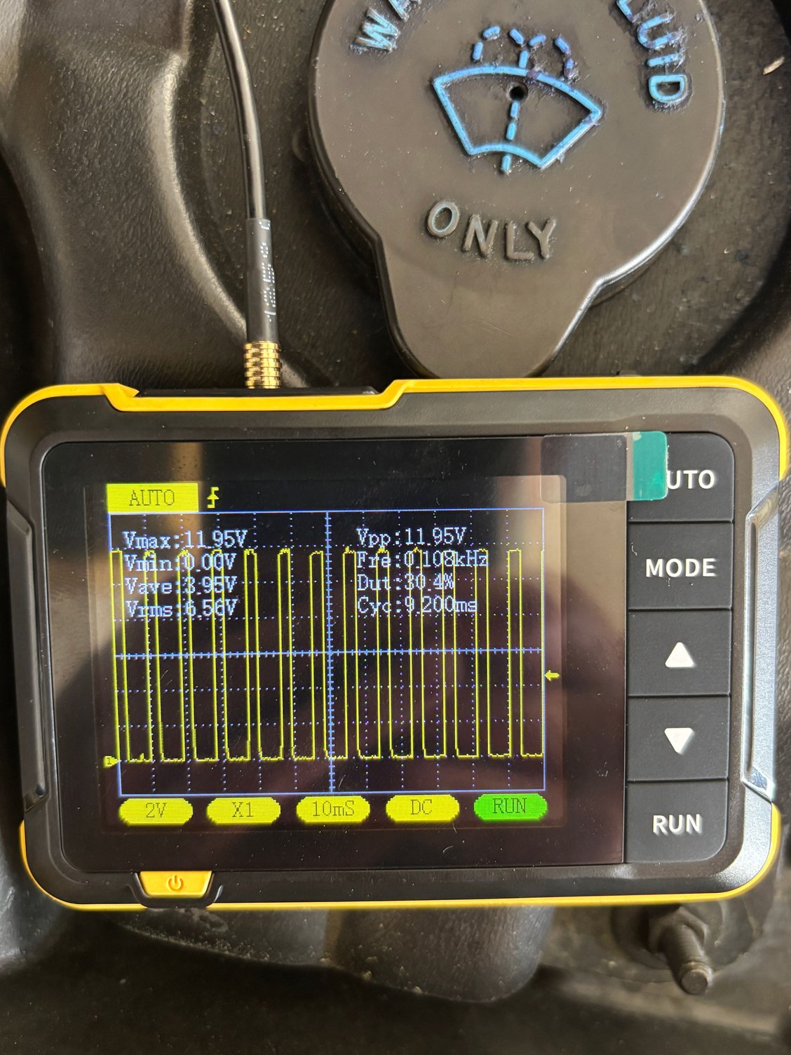

I am waiting for the car to cool down before checking the connections on the starter. I scoped the generator field winding duty cycle monitoring wire and got 30-50% depending on load. It was relatively stable. Not super concerned there. I checked the L terminal with the car running, the harness both unplugged and plugged-in. With the alternator harness connector unplugged and the car running, the "turn-on" pin reads ~10V from the PCM. With the car running and the harness plugged in, back-probing this same wire reads 2.8V. These readings are steady and unchanging. Should the L terminal "generator turn-on" circuit disengage after the field winding is started? This seems like a potential error state to me.
AC on, radio blasting, 50% duty cycle
Idle duty cycle around 30%
2.8V on the field winding circuit. Is this ok?
