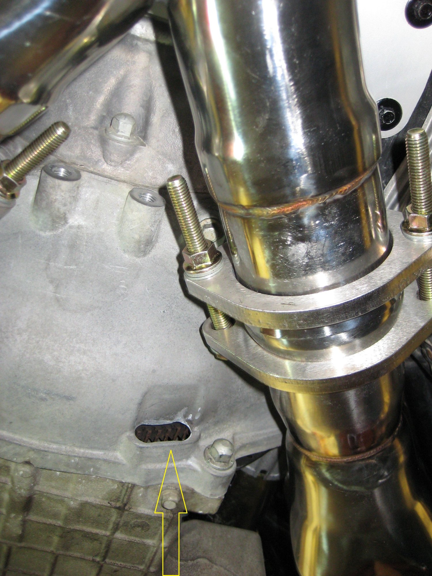

I read a tip somewhere that the bellhousing area was cleaned and they took off their plastic covers by the starter and oil filter. Then they opened up the two vent holes in the bellhousing lower. They Article mentioned that the GTO's had no vents and they went through clutches faster than the C 5 's mostly because of the heat ???? When I installed my headers I didn't think it would help but I used brake clean and cleaned out the housing area,and instead of leaving my covers off I drilled holes in them,and opened up my vent holes. I don't know if I added more life in my clutch or not. A side note I did use the Ranger method ( my fluid was dark) twice in a months time. Since then almost 15,000 miles my fluid remains clear !!! (I also am not hard a clutch)
This makes sense, the clutch dust will escape out instead of hang around in the housing.

It made sense to me and I'm not out anything for the effort !!!!
