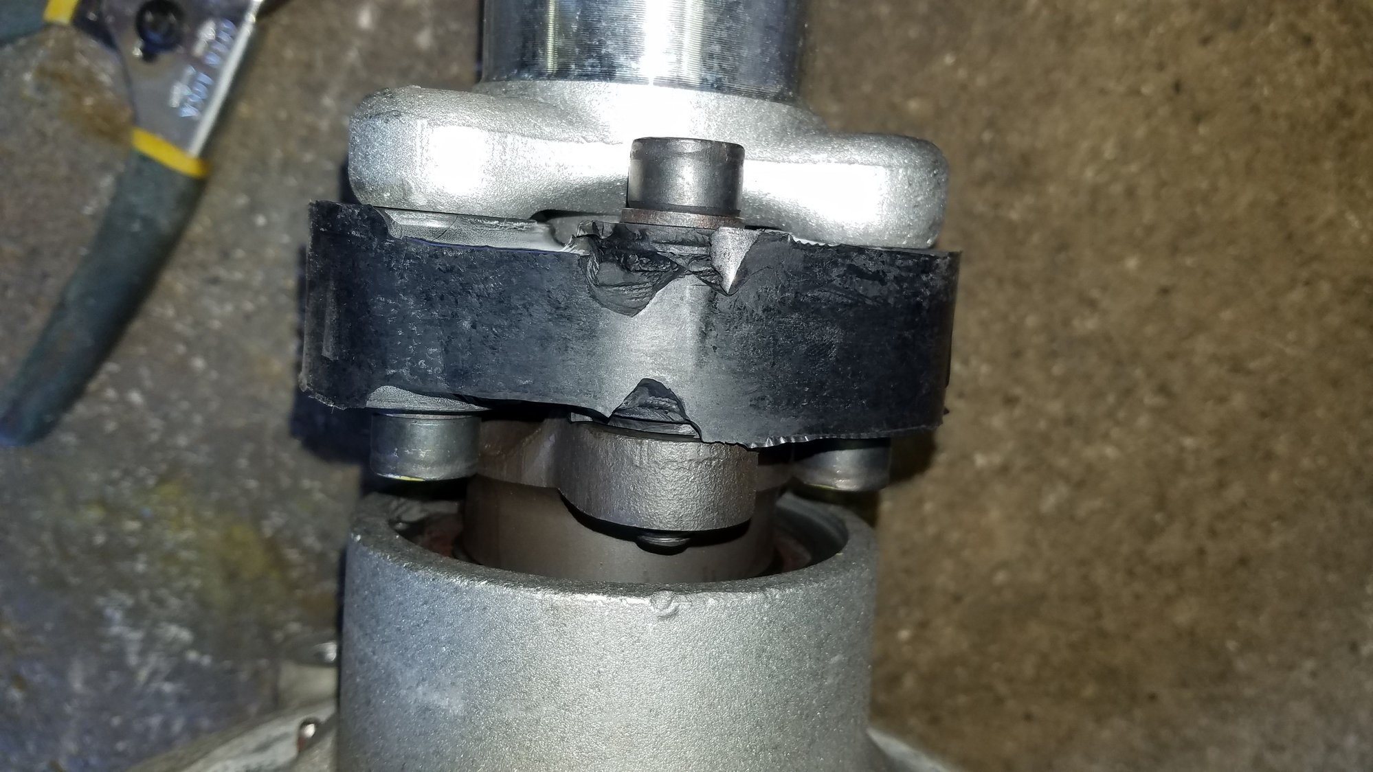

Has anyone used the torque tube couplers from Corvette Central lately? I am having a hard time swallowing the 130 dollar price of the factory GM ones. I dont even know if mine are bad but since I'm going to be digging into it. I wanted to have a couple on hand just in case they are.
Depends on the mileage and how it was driven, the rubber becomes hard on the couplers and they'll start to crumble. I would go with some dss poly couplers since you have the 10mm version, I believe the couplers used in most of those kits are bmw couplers. Also dont forget about the torque tube bearings. Another thing, don't overlook price if you could have only two out of cheap, fast, reliable which would they be.

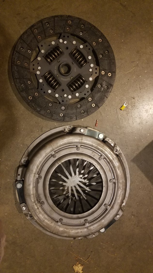

I checked tonight. It is not a tick. So what what I can figure is the clutch, pressure plate, and master were changed. Probably by some meathead who didnt know what they were doing. So I have purchased already a GM factory slave, master and a LUK pro gold clutch kit. Also a remote bleeder and 2 new factory GM drive shaft couplers. I only want to do this once. It has a vibration that we can only assume is coming from a misaligned clutch plate done by a hack. Like I said my brother is a GM Master Tech and he is starting to work on a few Vettes. Most of the ones he works on now are garage queens with really low miles. He is getting to know the higher mileage ones now while working on mine. I'll keep posting as we work on it. Thanks to all who have chimed in with tech and opinions. This forum rocks! And I love my Vette!!!

So this weekend I did the clutch in the Vette. Bought a LUK Z06 clutch kit with flywheel. Had it balanced at a local engine shop. 2 New torque tube couplers, factory GM. New clutch master and slave, both factory GM also. Replaced the fluid in tranny and rear diff with Amzoil. And put in my c6 shifter with my C5 ball. What a difference! Drives like a completely different car now and way smoother and more responsive. Glad I finally got this done. Thank you for all of the advice.

Any idea what clutch came out of it?
It was a kit from O'reilly Auto Parts from what I can figure. I don't think it's bad just was not installed properly. Anyway it has been replaced. The LUK kit I got off of ebay is much nicer!

The LuK is the OE supplier and the pro gold is the self adjusting factory design, unlike the lesser expensive version you removed.

I went with the ls6 clutch and flywheel. The ls7 flywheel is way heavier , from what I've read and it sucks up power. All I have is exhaust and a dual cone intake filter. I can't afford to do a bunch of upgrades. Plan on fixing a bunch of stuff while you got it apart..cause it's a lot of work. Glad I bought the TT bushings, cause mine were beat as you could see. And pay close attention when disassembling and reassembling. Arrows on the bushings and mark it how it comes apart and make sure it goes back together the same way. I just wanted it to work properly. And now it does.
