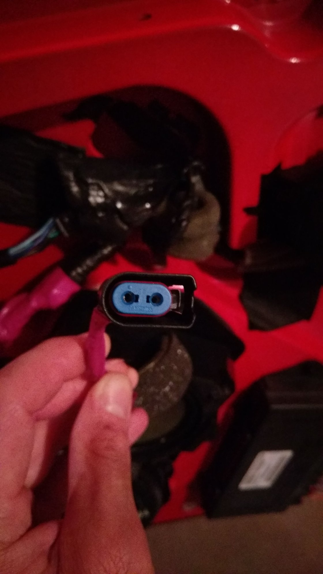

Factory wiring harness in the passenger door

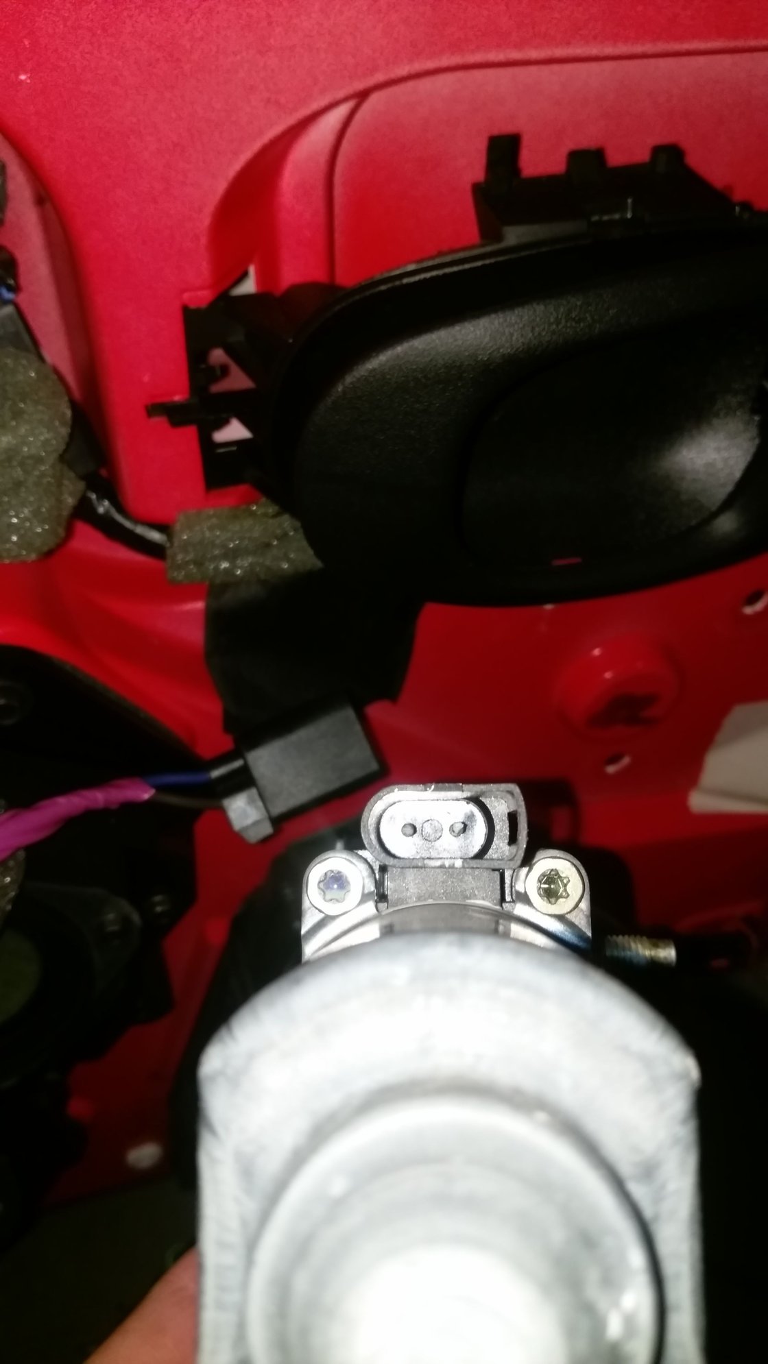

Original motor female side with plug in background

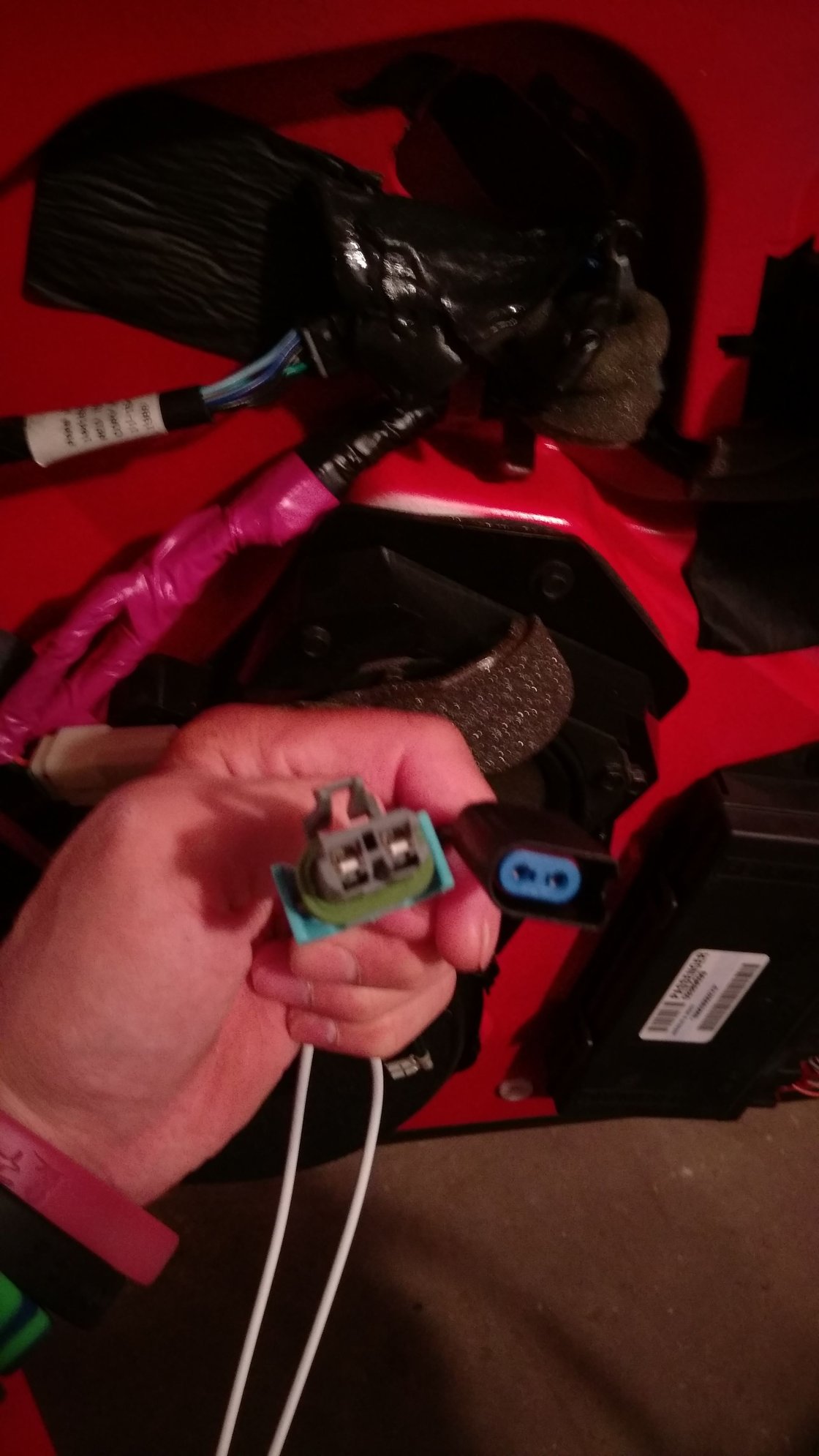

Original regulator plugged in

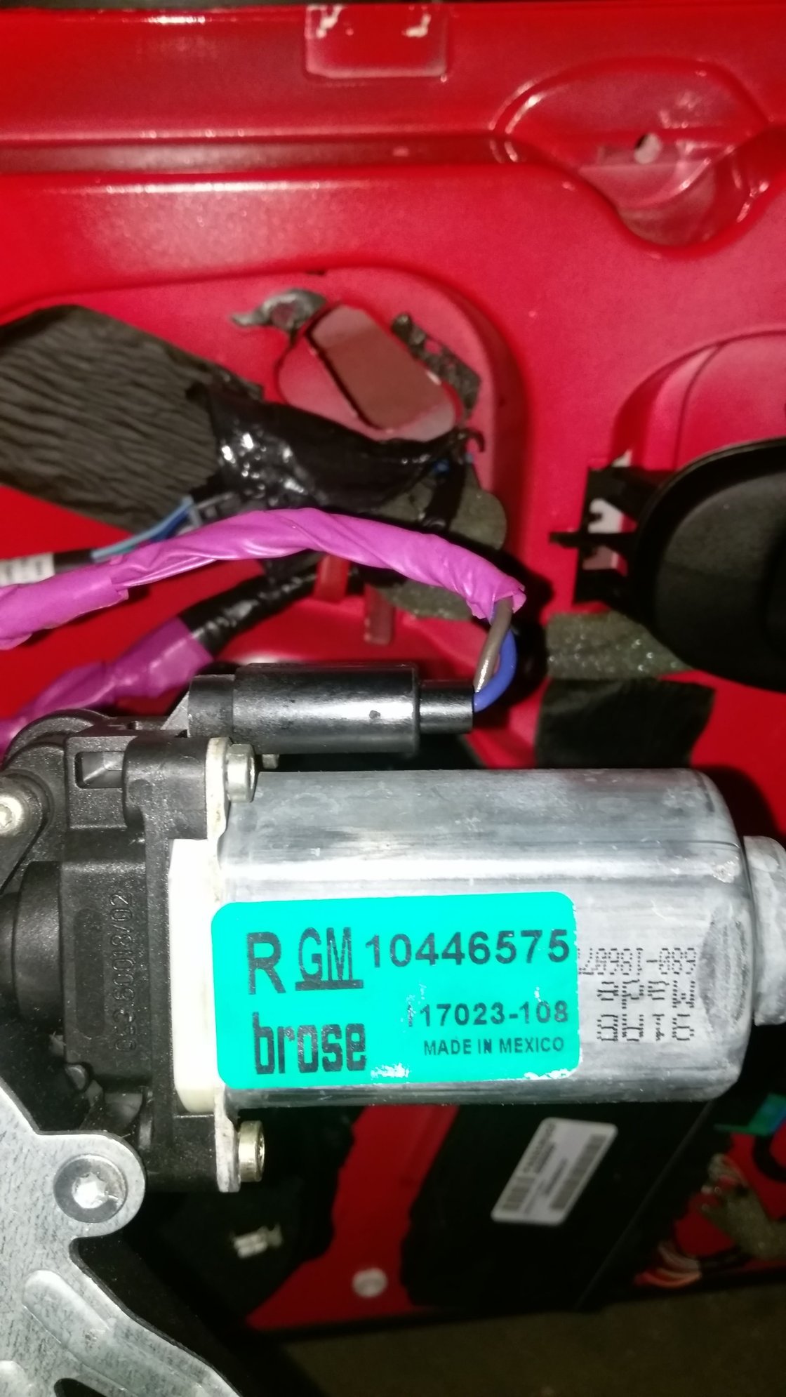

New Brose replacement regulator and pigtail from AC Delco
Brose replacement regulator female plug on the motor

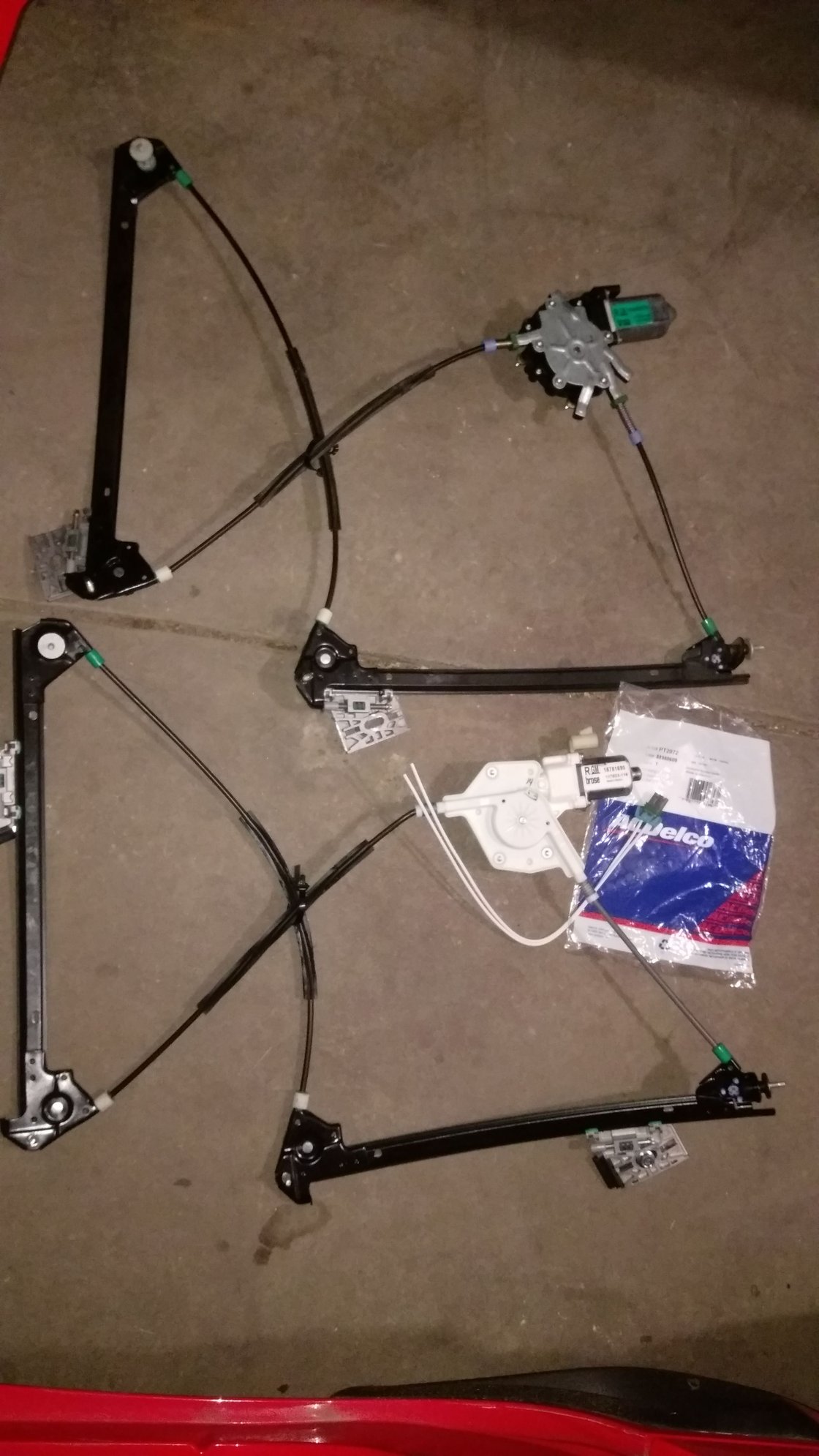

Grey is the new pigtail end <br/>Black is the factory end

that very first picture does not look like o.e.m. to me. Well, at least not like on my driver's side.
So it seems like you pay the full-freight price for the set-up they send you the new and improved plug with pigtail.
I bought a lower-priced knock-up part and the connector matched my o.e.m. So my factory connector looks like the replacement you got from AC Delco.
Not sure if this is a Z06 "oddity", or if the passenger side is different.
