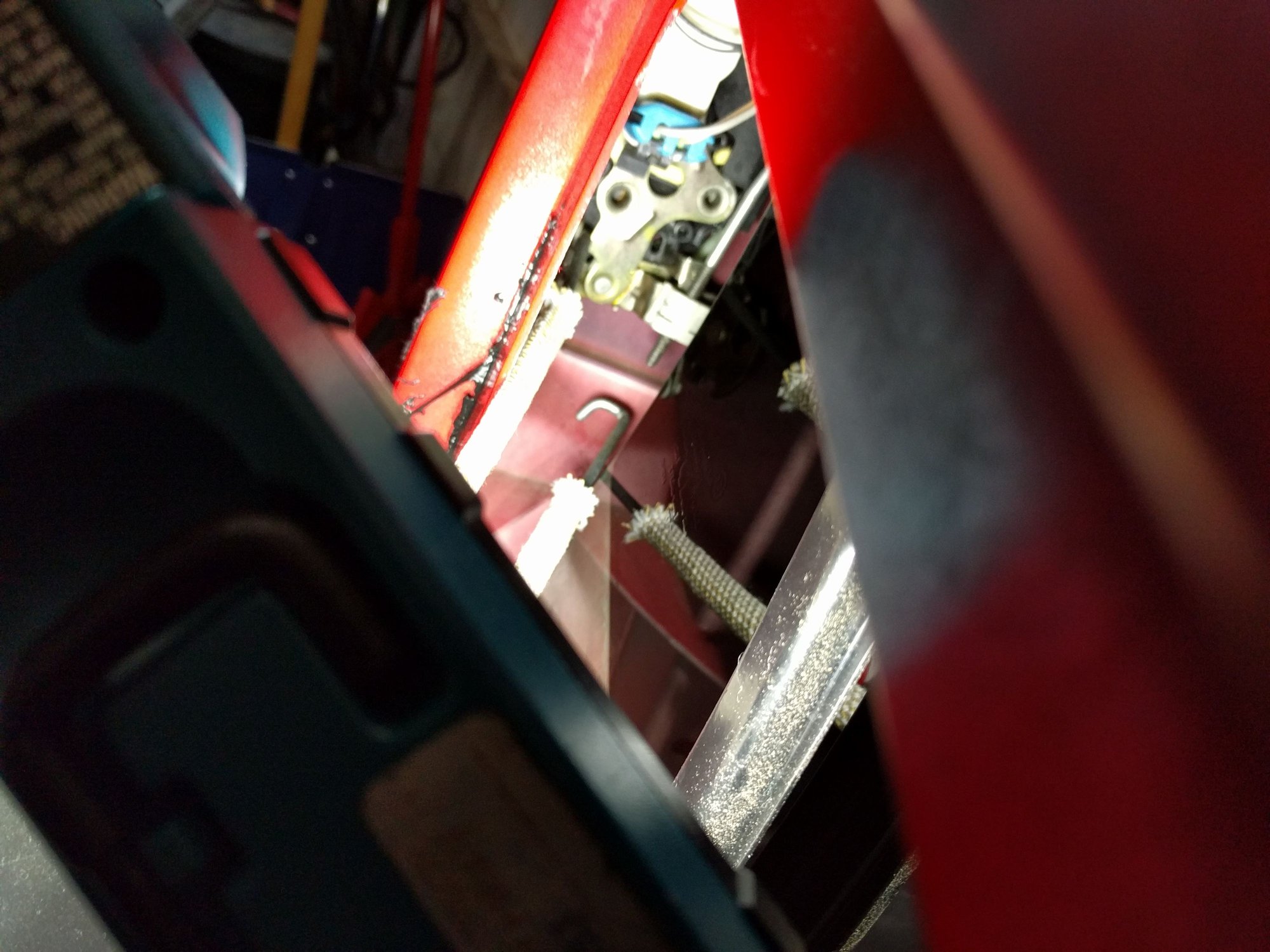

Background:Hey guys, I'm doing a a tweeter relocation in my c5 to the door handle/latch spot as pictured. My work looks decent but I was able to go buy another set of both door handle/latches for 20$ on ebay so I figured I would do a better job and swap them out.
Question:I see there are two rods connected to the inside door handle/latch. One rod is for the lock and outer handle. If I try and depress the rods, at least on the bottom there is a plastic tab that prevents the rod from lifting high enough to clear the hole it's mounted in. Not sure if I needed to something else first but was hoping you guys could tell me what I'm missing so I don't break tabs on my existing handle/latches. Thanks.

Ok, this worked out much better, definitely have your window rolled up so if a rod dislodges from the latch/lock you don't damage tint or your window. I was fortunate I didn't but could have. I will add some more detail after getting my new door handles and redoing the passenger side.
After getting the door panel off. Remove the T15 hex screw.
Then as the manual says you push the from the rear most of the door handle against the two tabs holding it into the door forward and then pull the handle away from the door so the tabs clear the door and pull it back and remove it from it's holes. Afterward you just need to swing the door handle/latch in a counter clockwise motion so you can dislodge the rods and clear the retaining tabs.
If the rods dislodge from the door striker/latch you just need to slide them back in their holes, pics for reference....
