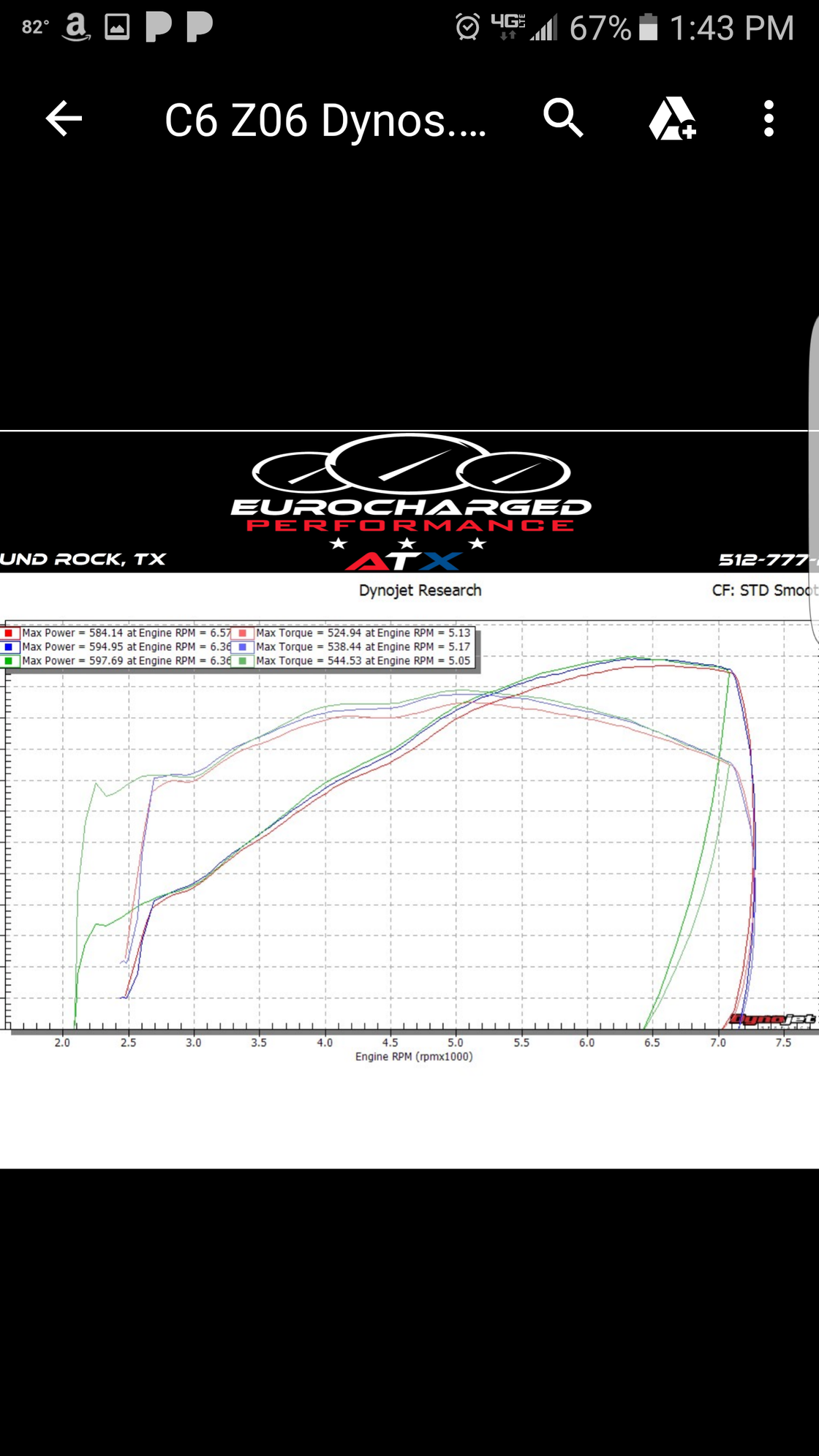

Another option is a stand alone controller. We're working on getting it setup and testing on my c6z right now and will be making a harness to run on the c5 as well. As long as your pump gas 93/91 ocane tune is correct and your fuel system will be able to keep up, this is a simple plug and play controller and takes about 5 min to install. It uses a gm flex fuel sensor and corrects fuel trims according to ethanol content.
Here's a dyno graph from a 06 c6z test car we are doing. The car is already setup with flex fuel (pined the factory pcm) so we have a comparison for the c6 market. The red line is the 93 octane tune, blue line is with flex fuel turned on, factory pcm adjusting for ethanol content, green line is the stand alone flex fuel controller running on the 93 tune only (flex fuel turned off on factory pcm. Even on the test car it picked up a significant amount through the mid range over the factory corrections. On the later pcm's 09+ have a flex fuel PE table you can fine tune and achieve similar gains however the earlier pcm do not have the ability which is why the stand alone picked up so much.
Have you made any progress with this and the C5s?
