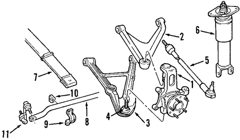

so while I was replacing shocks I noticed both rear tie rod boots were torn (its part #5 on diagram below). I've searched the forum but i don't see any information on how hard it is to replace them. I plan on replacing brake pads in a few weeks and would like to do this at same time. Any help would be greatly appreciated.

Part 5 is actually 2 parts. The inner part has a socket joint and the rod. The outer part threads onto the rod and attaches to the spindle.
If is easy to change the outer joint. Not too bad on the inner but a little more work.
The main thing is you have to try and keep the assembly the same length and then you'll have to get the car aligned after you are done.

As far as alignment goes, you and count the turns as you remove the balljoint, and as a back up measure the distance before removal and after install.
