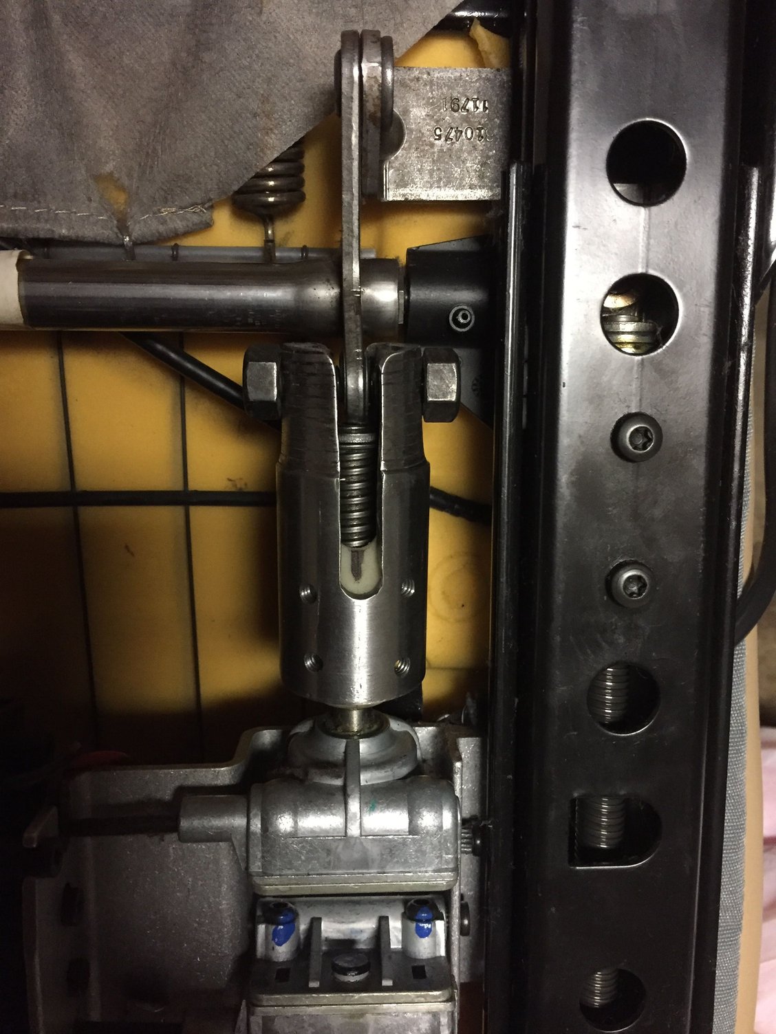

Anyone have this problem?
broken power seat raise and lower yolk broke.

What you posted is not what is broke. I do not know how to post a picture, their is a plastic piece that runs on a screw that is attached to the drive motor that operates the up and down movement of the seat that is broke.

If I am understanding what you have described correctly, you will have to replace the whole seat track assembly. The plastic pieces are not available separately as far as I can find.
I have 2 broken seats from a 98 C5 that I have been using for parts that these plastic yokes are kind of OK on but are riveted to the threaded shaft.

Default Metal clevis repair kit
http://www.parts123.com/parts123/yb....0c~Z5Z5Z51HIDK

Default My fix
This is what I came up with for a fix
