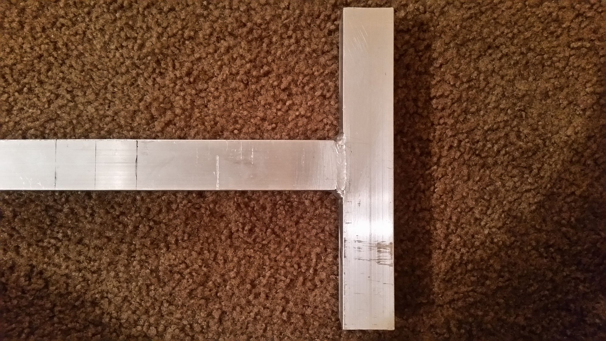

Got the T's made up today for the mount
The three drawn lines are the thickness of the frame section they'll mount to (2"). Middle line being the center where the bolt will run through. I'm going to chop the tube at the line to the left for a total length of 8 1/4".

UPDATE: I attempted to install the light mount and my first attempt was a failure. It's going to be harder than I had anticipated to get the mount centered and spaced right on the frame.
The sheet the lights mount to is also too large.
Back to the drawing board.

UPDATE: I've decided to create a mount that is adjustable and can be taken apart for adjustments to the square tubing. This way I can get the perfect length forward, into the open space in the bumper.
I've found it difficult to measure the correct length of the T's combined with how far the lights stick out from the mount. Once they're welded up, they're either right or wrong. Thus the adjustable practice mount. I'll be building it this weekend, as well as getting a new light mounting plate made up. Sorry for the delays! I've not given up on this project and I'm even more eager than anyone to get it finished.
Once it's done and all of the measurements are recorded, this would be easy to duplicate.
