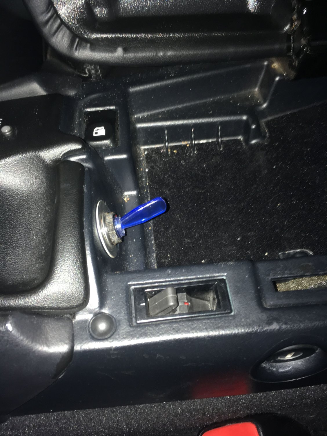

Got whole system in, the hardest part was punching thru the tub to route the wiring and nitrous line into the engine compartment. WOT switch was mounted to the gas pedal and I used the cigarette lighter power and ground for the arm switch. Also installed new spec lll clutch and drag radials. Wonder what the 1/4 mile times will be with a 100 shot? It's M6 with vararam Ti exhaust LS6 cam.

Nicely done. Ought to be a real kick in the pants when you flip the switch.

Nice. Did you get it tuned?
In the 1/8, I ran 7.9@ 96.3 mph, 2.0 60 ft, with my 100 dry shot Z06 using a push button switch. Looking for 7.3 with a better 60 ft.
