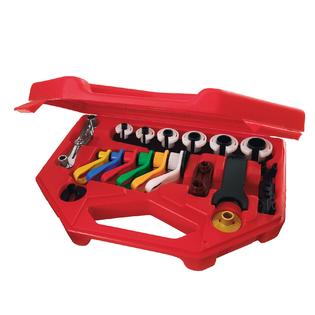

Just be sure you have the correct fuel line disconnect tool on hand before getting started. You don't need a complete set such as this one by Lisle, but you will need at least a basic tool to get the job done.
