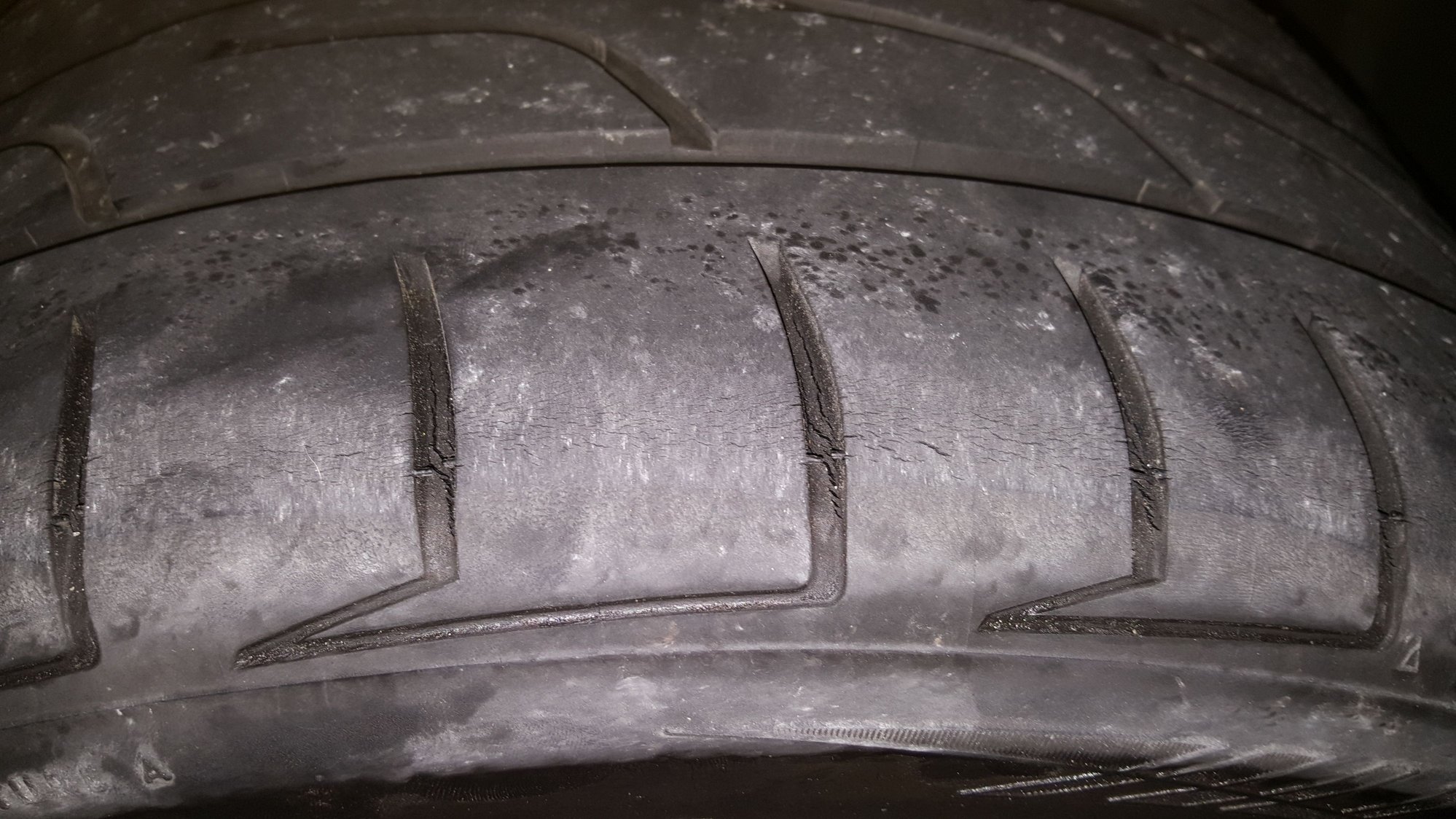

I hope so, it's a very slow leak. Check out this pic though, I noticed they are dry rotting and cracking some.. do you think these need to be replaced?

I would replace those if they were on my car, either do a rear pair or all 4 if they all look like that

Here is a front tire. All 4 look very similar, the rears are a little worse though.

Likes: 265
Originally Posted by 8VETTE7
I would not drive on that tire even if the cause of the leak is repairable. That tire and any others that look like it need to be replaced.
How old is the tire? What brand??
Bridgestone potenza re760. On the car when I bought it five years ago. I don't know how long they had been on the car but looked brand new as far as tread
Branded on the sidewall of each tire (hopefully tire is not mounted so it is facing the center of the car) is a manufacture date. Here is how to read the date:
http://www.tirerack.com/tires/tirete...161211031329:s
Sounds like they are at least 6 years old and therefore the manufacturer is not likely to do much if anything for you. Worth a try as the worst they can say is no.
Looks like mine were made in 2010 then...
Old Dec 10, 2016 | 10:52 PM
bwill03z's Avatar
bwill03z
Joined: Nov 2011
Posts: 3,185
Likes: 265
I would take them to a Bridgestone dealer and see if they will give you some type of prorate on replacements. Press them if at first they say no. Those were decent tires when new and should have stood up much better than that......................
I can give that a try, all 4 look like that so it's a possibility. If that doesn't work I believe I will wait til spring and order 4 of the continental extreme contact dw. Those seem like nice tires.

I agree. I am going to buy some tires for my truck today and prob wait til spring to get new tires for the vette. I got a better look at them today outside, even worse than i thought.

Originally Posted by huesmann
Looks like your PO might've rode 'em hard and put 'em away wet.
Nah the tires were brand new when I bought the car, other than a few joyride test drives I'm sure. I've never really pushed the car in curves since I bought it. I would say the dry rotting is from me not driving it enough. :/
