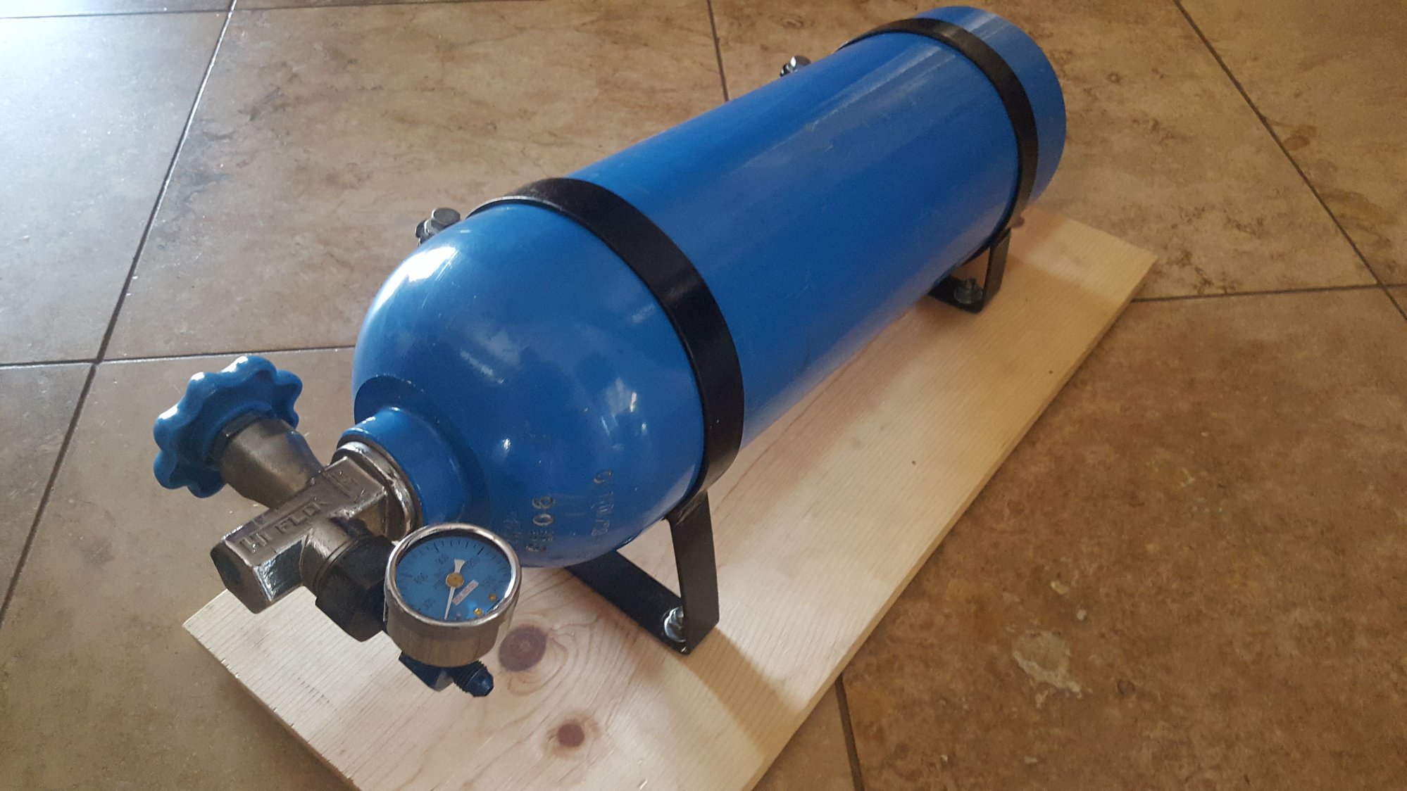

I used gorilla glue and glued it on the flat section right behind the seats, and drilled into the wood.

that looks good, might just go this route and to make it looks nice might throw a fabric around the base.

The wood is underneath the carpet, so you shouldn't need to cover it.

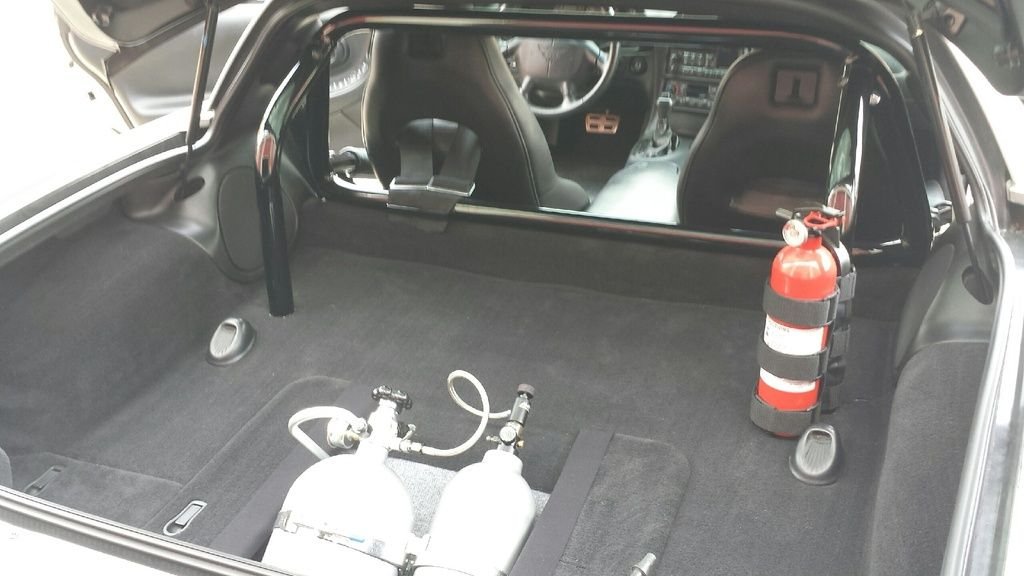

I understand you not wanting to drill holes in the rear compartment cubby but keep in mind that glue may not hold the bottle and mounting plate in the case of a car accident and they become projectiles inside your cabin that can cause serious injury or death.
I made an thin metal plate, covered it in carpet and after properly bending it bolted it in. I know the bottles aren't going anywhere. We race ours so a rollover, crash, etc. was on my mind with safely securing it.
Scott
I was going to mount mine horizontal but I am starting to like the way you did it.
