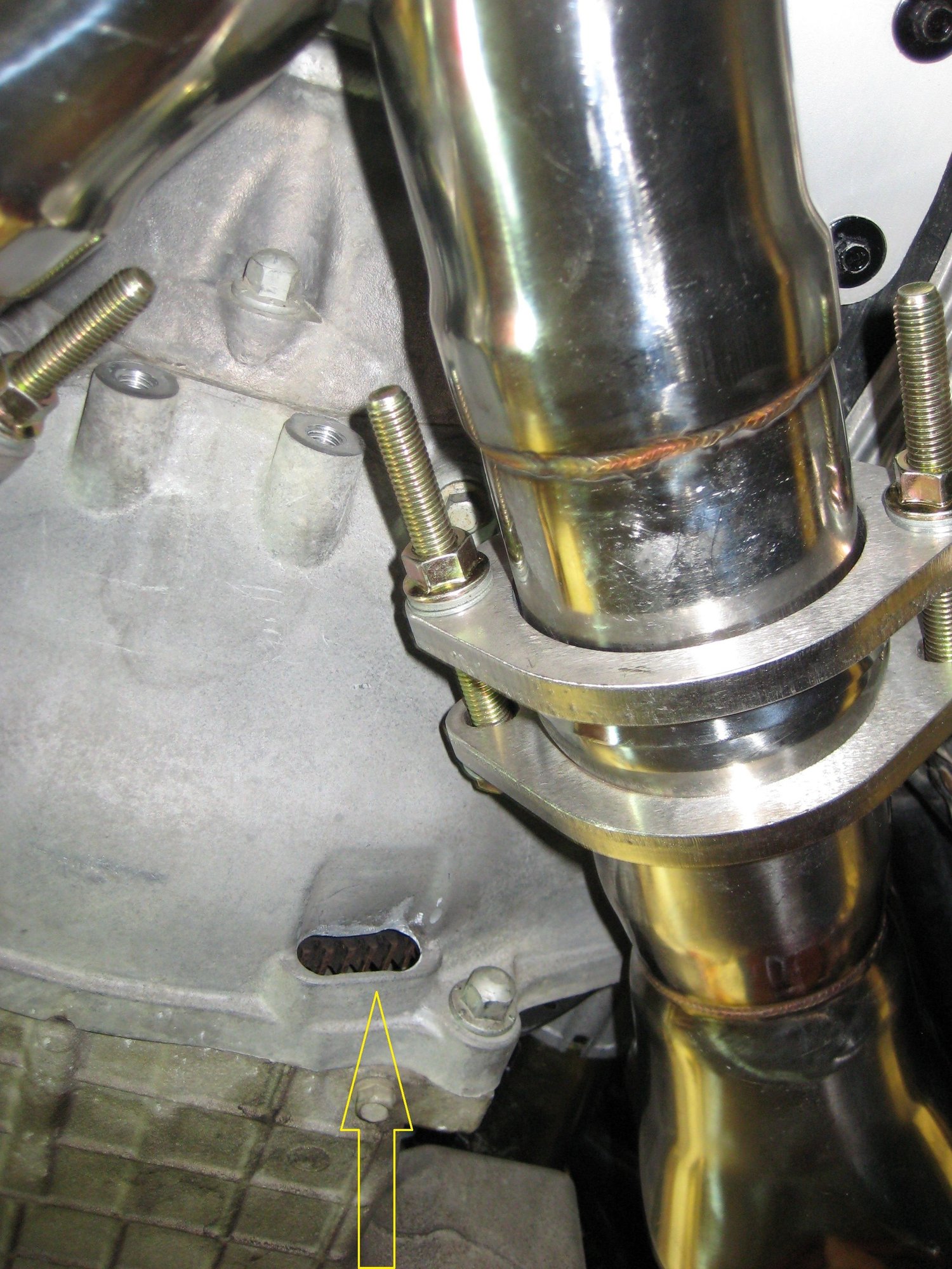

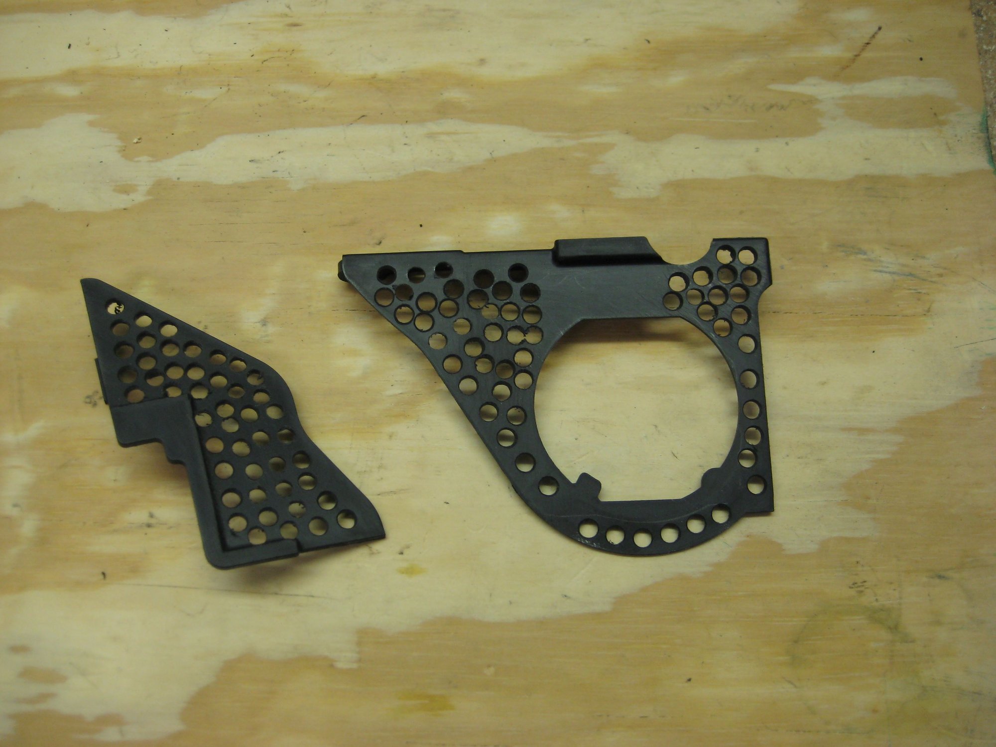

I have done mine twice and the fluid has stayed clean, 50,000 when I got the cat now 72,000 !! I also cleaned out the bellhousing when I did my header install, plus opened up the vent holes and drilled holes in my plastic covers (starter and by the oil filter)

Old Mar 11, 2017 | 07:08 PM
Pounder's Avatar
Pounder
1/4 mile/AutoX
Joined: Jun 2014
Posts: 11,439
Likes: 2,184
From: Buffalo Texas
