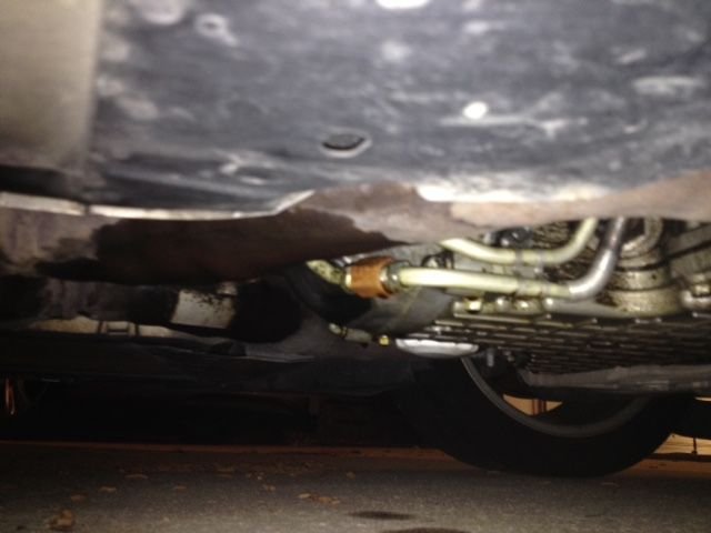

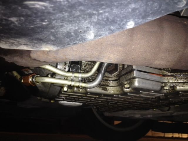

I found a little oil leak on the new purchase. I'm not mechanically inclined automotively but I have been trying to find old threads with photos that resemble whats going on with mine. Not much luck.
This is what I saw and tried to take a pic as best I could. I am hoping this is a common issue and someone can point me in the right direction as to what the problem is:

Can you tell if it's engine oil or transmission fluid, the 2 steel lines are transmission cooler lines

As you can tell I took the photo last night. I will try to get under there today and see if its trans or oil. Thanks

Yes it does look like the Trans cooler line fittings. You can clean it, try to see if you can tighten them up a bit and monitor it to see if it stays dry.
