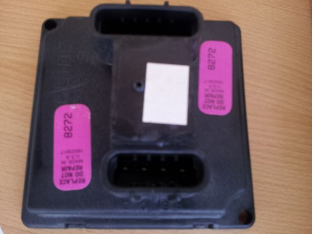

Yes, you don't need to take the headlight asm out to remove the module. Believe 2 nuts hold the module to the metal frame.
I don't have my C5 book in front of me, (can take a photo and send it later) - but you can take couple wires and tap the connector that goes directly to the motor - reversing the polarities will make the motor move in the opposite direction.
Two mounting holes for the module
