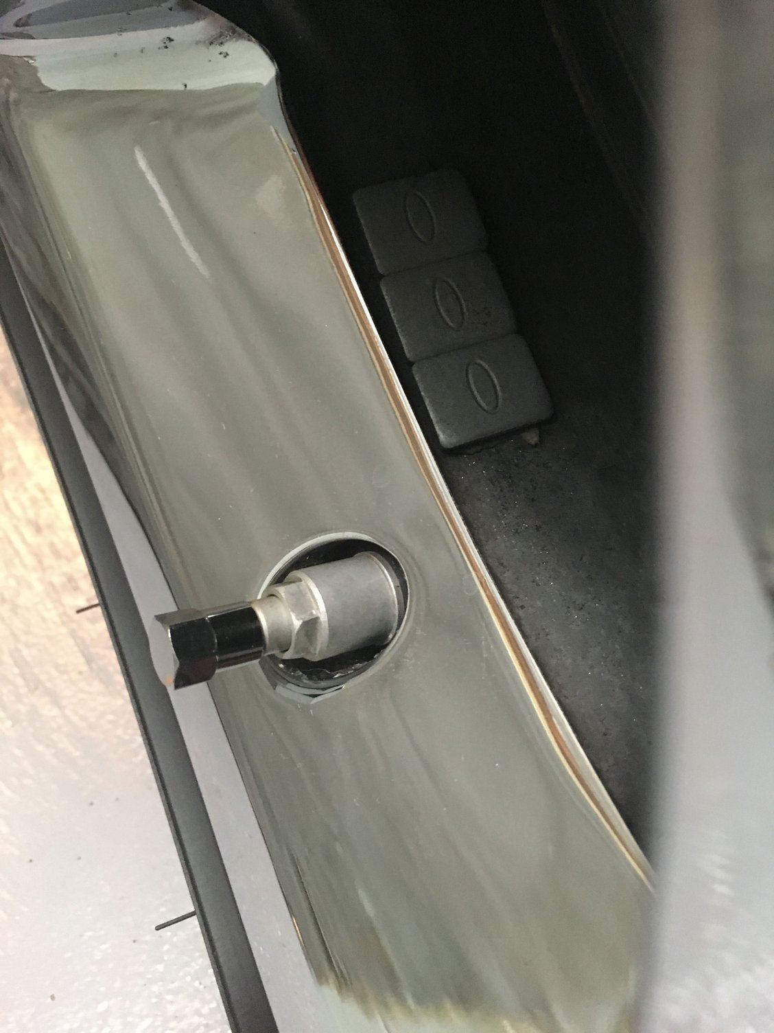

The valve stems all have that nut on them, how odd would all of them be bad? Could it be a bad module ?

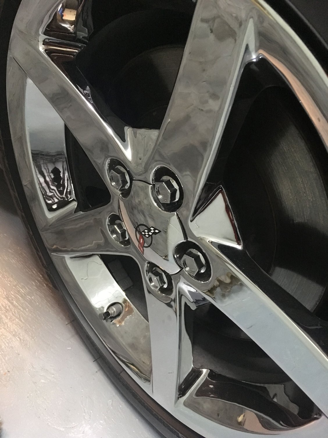

Originally Posted by 8VETTE7
Does the car have key FOB's and do they work???? If they work then it is highly unlikely that the receiver module is bad for just the TPMS. The same receiver module receives transmissions from the FOB's and the TPMS. Unlikely that it would fail for TPMS and not FOB's.
The wheels on the car do NOT look like the OEM wheels that came on a 99. If the wheels are from a 2001 or later C5 and have the TPMS for the later year car, that could be the problem. The TPMS for the 2001 - 2004 C5 operate at a different frequency than does the correct TPMS for 1997 - 2000. They might just be the wrong TPMS.
Could also be that the TPMS are original for a 1999 and if that is the case the batteries in all 4 could be bad. No way to know for certain without removing the TPMS and examining them compared to the PIC's in the link above. Should be pretty easy to see if they are early year TPMS or later year TPMS.
Either way I suggest that you are looking at new TPMS for the car.
brilliant! I think you nailed it!, my fob works fine, I recently did the solder job on it.
The previous owner told me he changed the rims out to an 03 I think so it makes a whole lot of sense now.
I owe you a beer!
