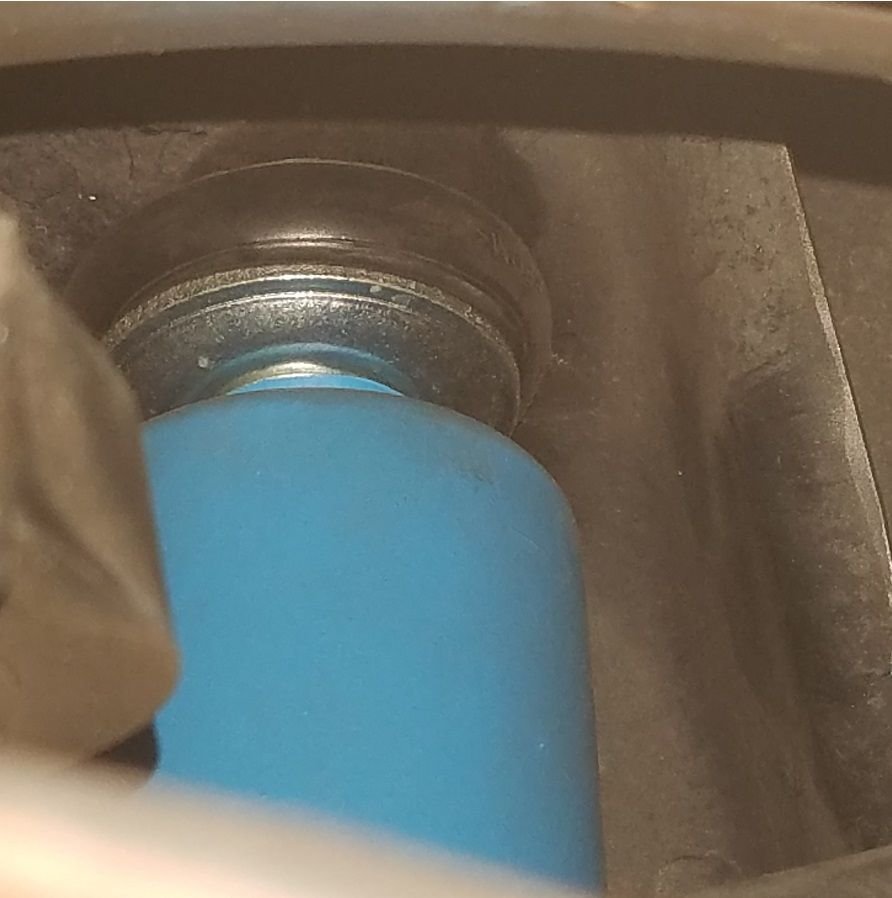

Hey Guys,
So this is my first time installing shocks, and have a couple questions.
I have the car sitting on the ground and I'm trying to tighten the front upper shock mounting nut on a Bilstein BE52977H1 (24-029773).
The torque spec I've seen is 19lbs, so on my 12 inch torque wrench with a 7 inch extension, after doing some conversions that means I should torque the nut down to 12lbs.
Now I'm worried with how much the rubber has compressed from under the washer. I don't like how it's squeezing out from under it...
Do I need to worry about this? After driving will the rubber sit better?
Top view of front shock mount
Bottom view of front shock mount

The rubber bushing is over compressed in your photo. Forget the torque wrench on the upper nut. Just tighten the nut until the rubber bushing is about the same diameter as the two washers and your good to go. Torque wrench is OK on the lower fasteners but it doesn't work well on the uppers.

Thanks for the reply!
That was my thought too... I'll back the nut out some until the rubber looks better.
