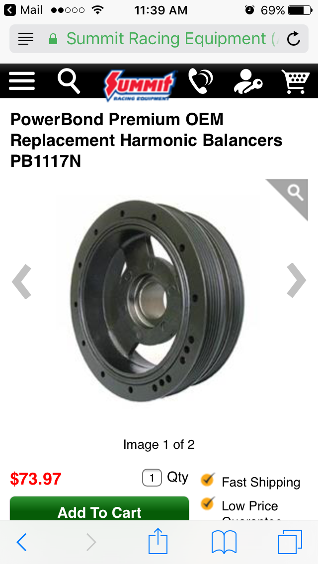

Here is the one that I ordered, can't help you with the bolt part number, I went with a gm bolt from the dealership (parts store did not have one on hand) and the bolt was less then $5.00.

PB1117N is the stock size
ARP Pn 234-2503 is the bolt and yes the front crank seal is also a good idea.
