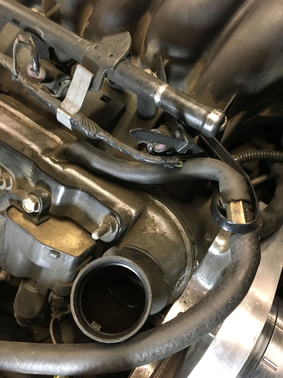

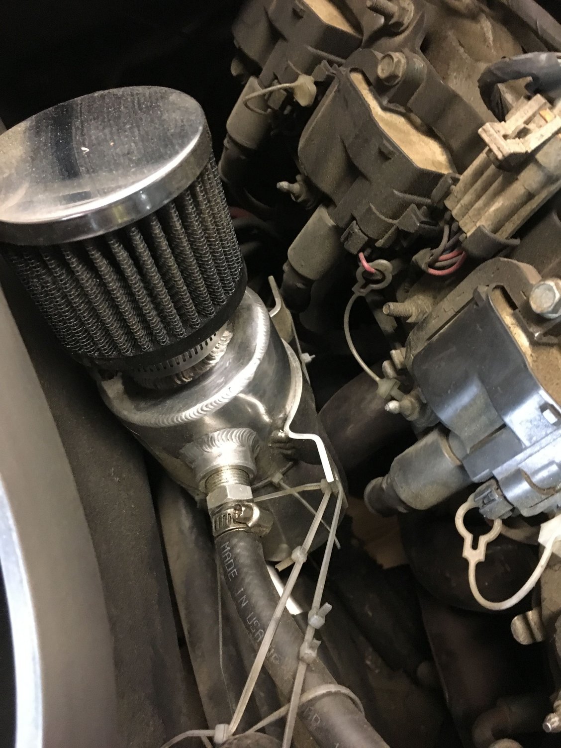

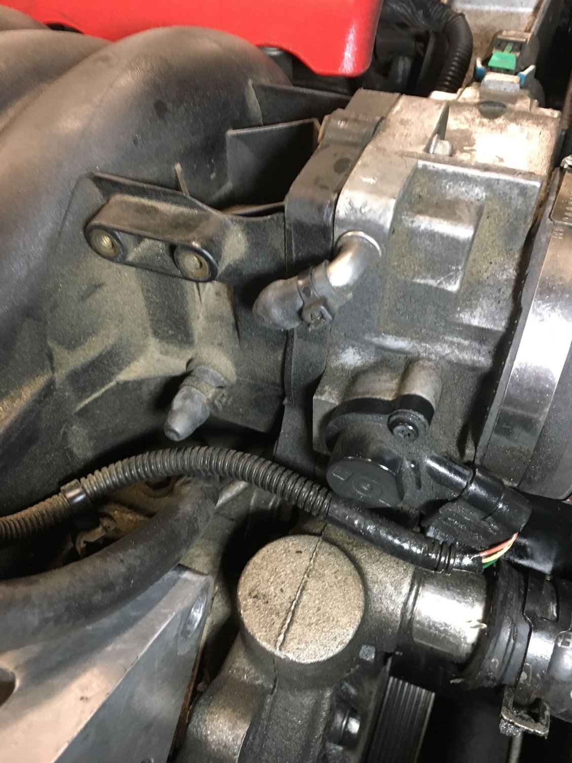

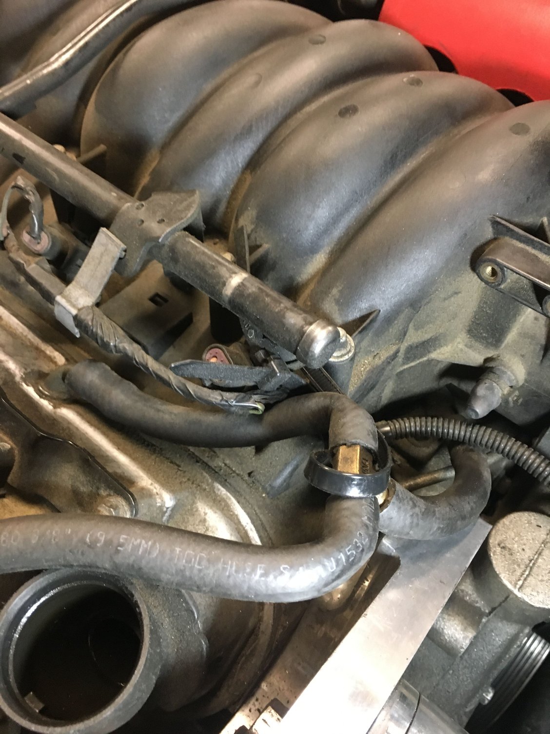

Ok thanks for the info. Yeah def stock lines. I will get bigger lines. I just took some pics of the setup can someone tell me what I should change?
