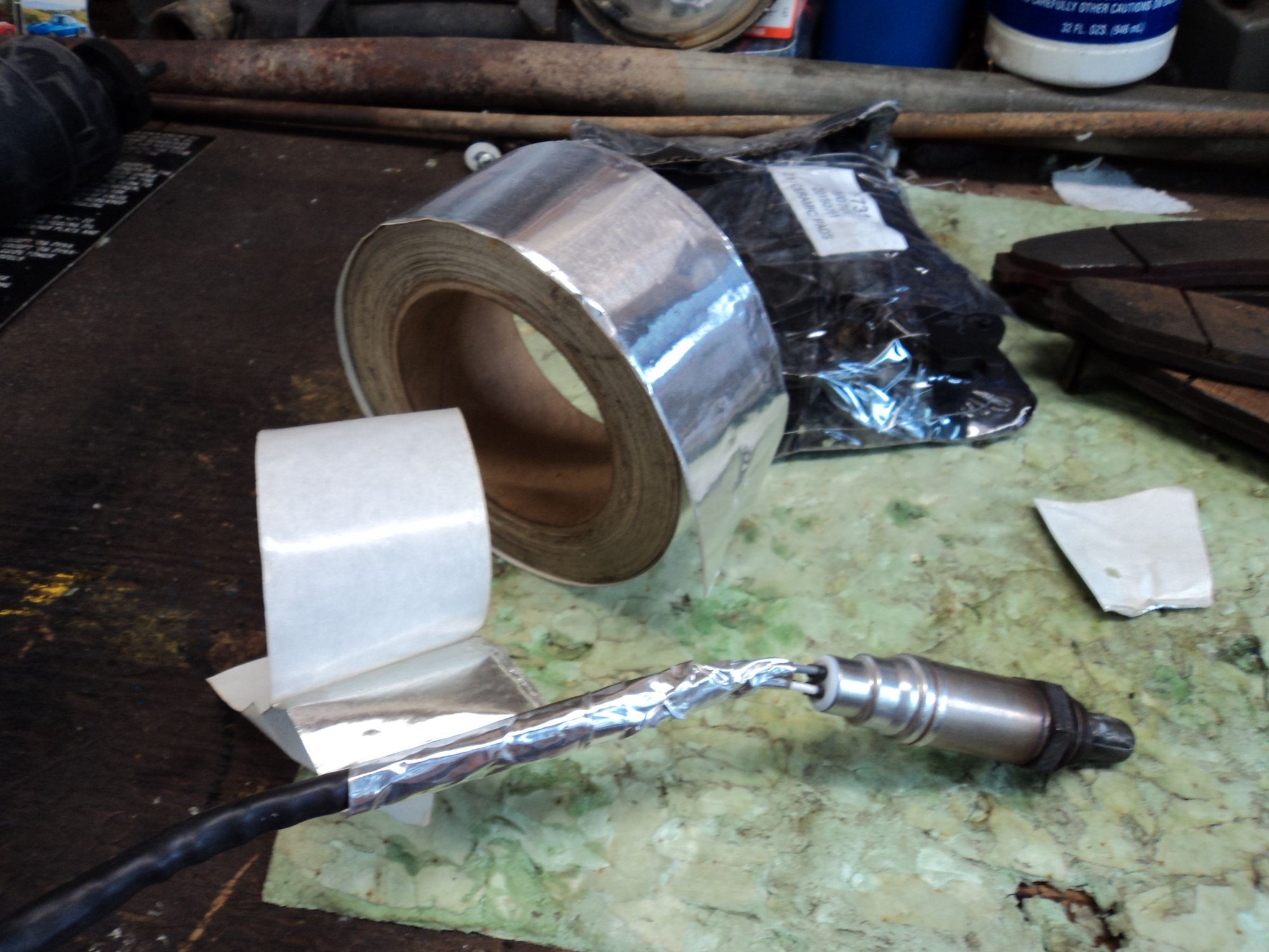

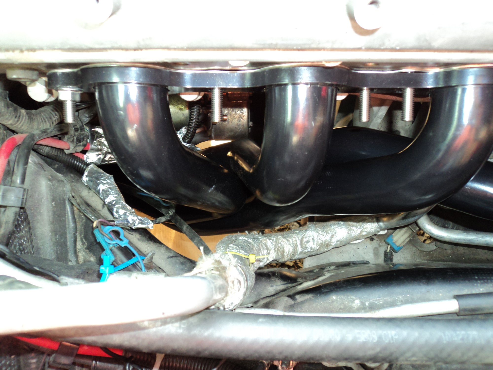

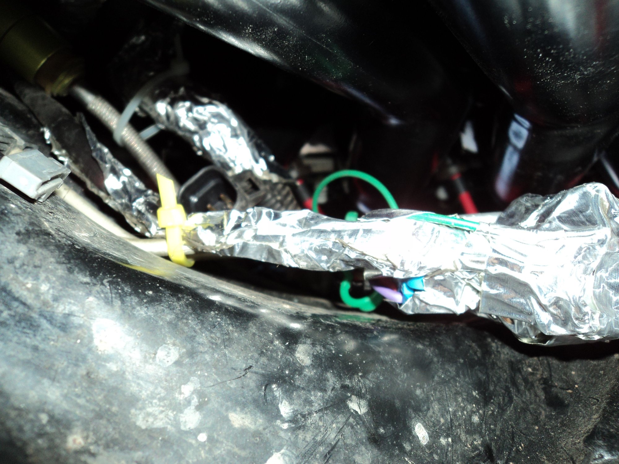

I moved my rears to the front and tuned out the rears. I also used heat wrap on the wires to protect them.
Got it at Lowe's
There have been times when headers have cooked, burnt coatings, and shorted other wires.
Not that hard to do, and did both sides of Eng.
Connector for rear's to front 02's::Racetronix -LS1-O2 - Rear to front O2 adapter
2 @ $10.00 USD
$20.00 USD
I hope this helps, also I did not loosen the headers, took a little more time. I have Hinsonmotorsports, purchased their complete set-up. Headers to the rear, coated, Xpipe all hardware ect.
