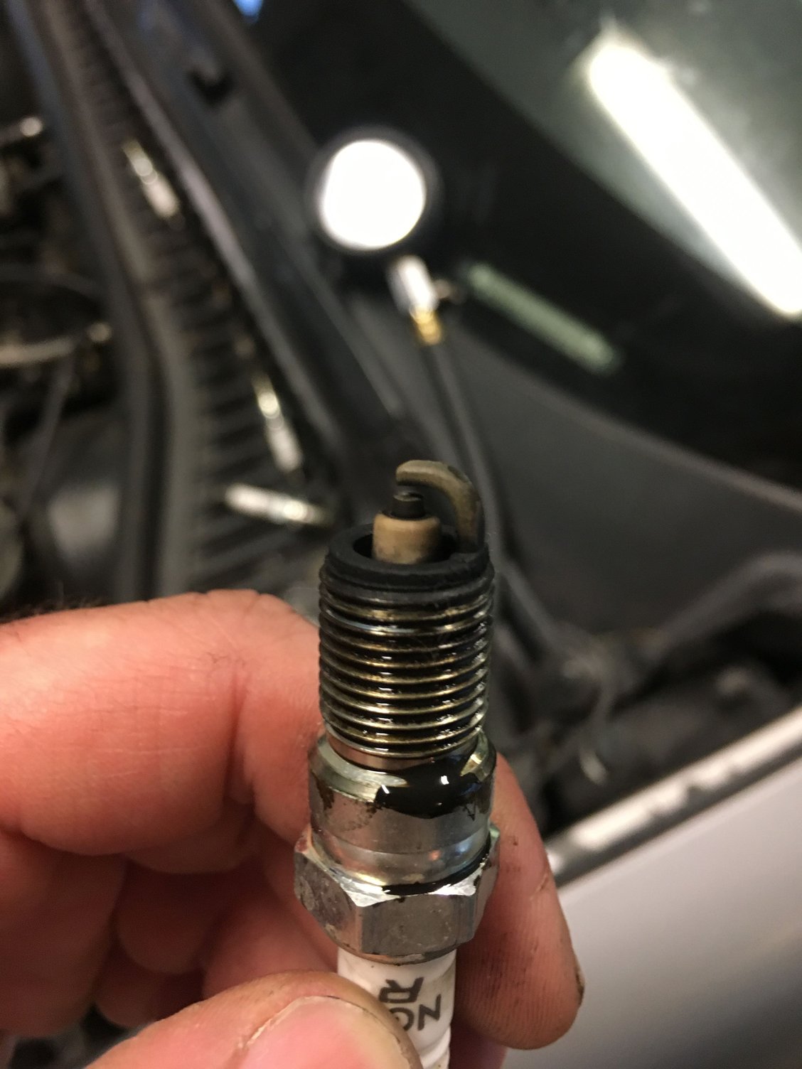

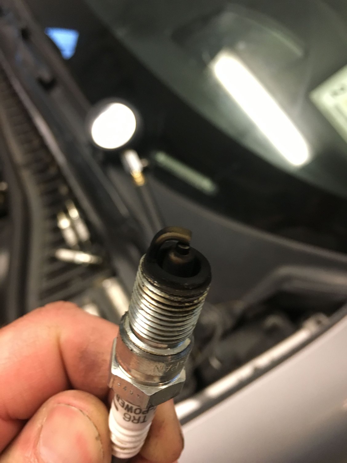

So I'm getting masssive blow by and smoke out of pcv. Just did a compression test and I forgot to write everything down so I'll do it again later but I had 3 or 4 cylinders that were 85-90psi and the others were between 150-170. Could I have that many bad cylinders? Car is 2002 z06 cammed and procharged and the rest of the bolt ons. How do these spark plugs look?

Here is a chart.

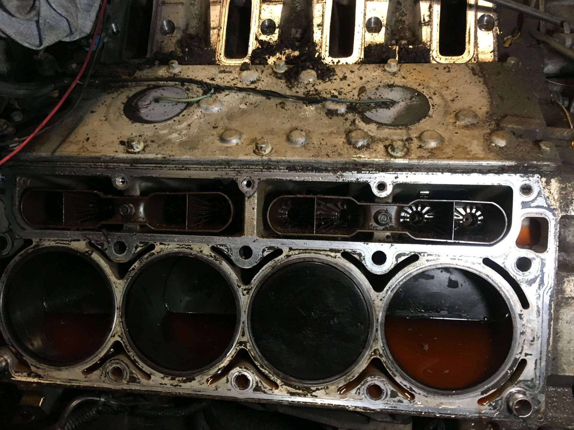

I got the valve covers off and there is oil in where the rockers are. See pic. Is that normal? Hoping I have the heads off by tonight. Maybe tomorrow.

Rockers need oil too.
You have a service manual, right?

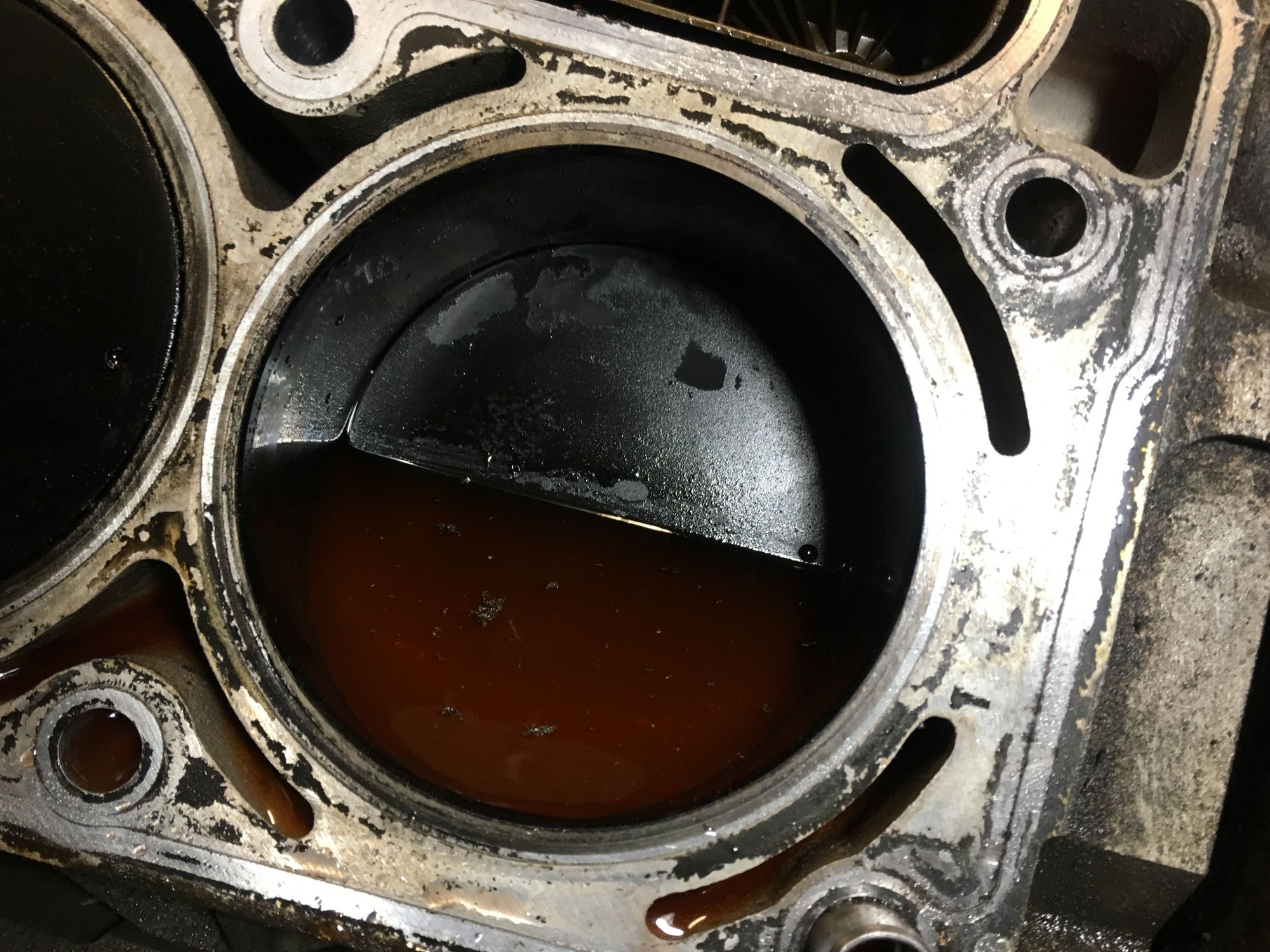

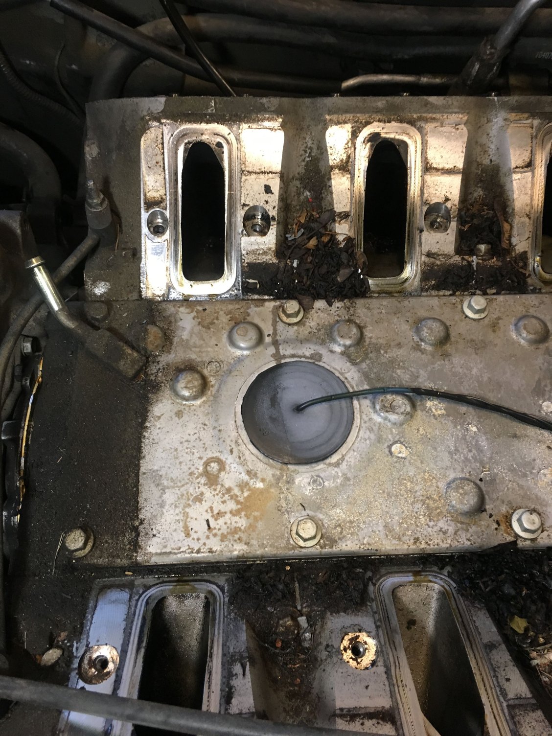

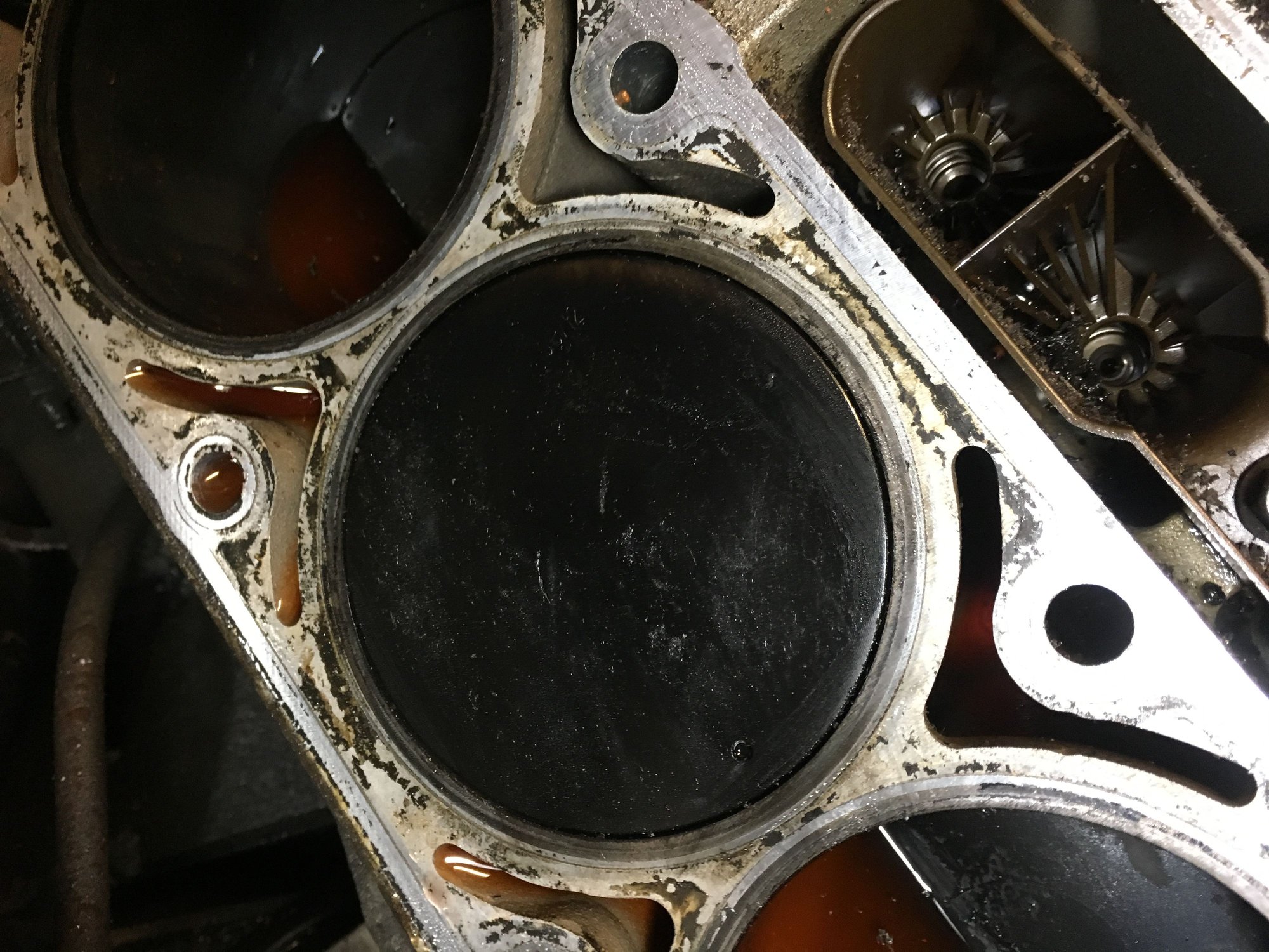

Passenger head off. I can't believe how much dirt was under the intake manifold.

Mine was like that. I spent time cleaning it.
