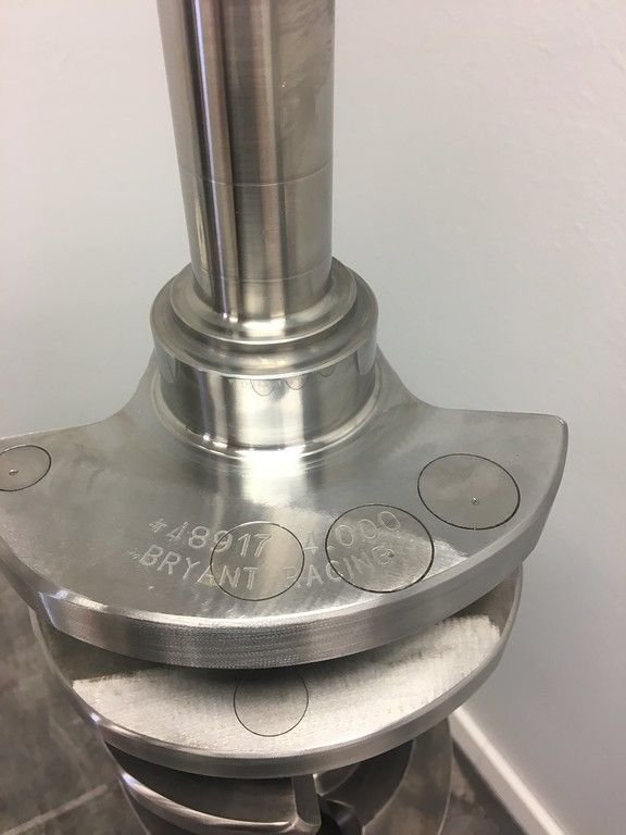

#1 Crankshafts
There are a number of different ways to make and design crankshafts, the three main ways are; casting, forging, and billet. Depending on the budget, power level, use, and number of units being built what might be the best way to go about it.

Our build.
This LS turbo build is using both a billet, and CCW crankshaft by Sonny Bryant. Because of the high HP requirements of the build by the customer (topping 2000hp) the crankshaft needs to be a strong as it possibly can as it will see a lot of load by the power demands and also continued high RPM use while making passes. This, the center piece of the engine, needs to be one of the most reliable parts of the build.
This particular crankshaft topped the $4000 mark by being a billet piece as well as a CCW design. Another interesting feature using two thrust bearings which I will cover in the next installment as we go over the block as well.
In closing, there are a number of ways you can build your engine and many price points to choose from as well as design. Just the crankshaft costs can range $400-$8000 before ever assembling the engine. While it would be IDEAL for every engine to use a billet CCW crankshaft, in reality, most builds it is not needed. Speak to your engine builder as what be right for your particular build.

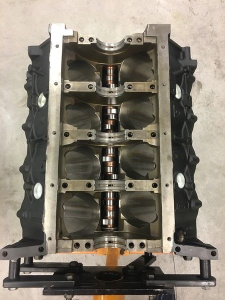

#2 Thrust
High HP builds can place a lot of stress on internal components of the engine. Many of us think to forged pistons, or better connecting rods but something that might be overlooked is as simple as thrust.
All engines have some thrust pressure against them, be it from a simple stock clutch or big stall converter. This is one reason you need to take steps during the assembly process to measure thrust and make sure it is enough for your particular build process.
checking thrust
You check thrust just after the crankshaft is placed in the block to see how much movement you have. To much and you inspect bearings and the crankshaft for issues, to little and you again..inspect and correct. Install all caps, other than thrust and measure again, install thrust bearing/cap measure before and after the cap is tight. All of this is done to make sure the crank has enough clearance to maintain oil between surfaces when it is loaded. This distance can vary again depending on transmission type, engine use and the loads it is going to see.
The problem can lie however, when loads exceed what this small amount of oil and bearing surface can handle. While LS engines have 5 main bearings to support the crankshaft in rotation there is only one small surface to keep the crankshaft from moving to far fore or aft. Big stall converters, and a lot of HP can quickly lead to excessive pressure on the crankshaft and damaged / spun thrust bearings. So what are you to do?
You could increase the space, or modify the bearing to allow more oil but this in turn will create an internal oil leak and drop oil pressure to the engine causing other issues.
One of the ways to go about solving this issue is using a roller thrust bearing in addition to the standard thrust. In this build we felt the roller front thrust will give us the protection needed to not spin the normal thrust and keep clearances closer to normal as to not create an oil pressure issue.

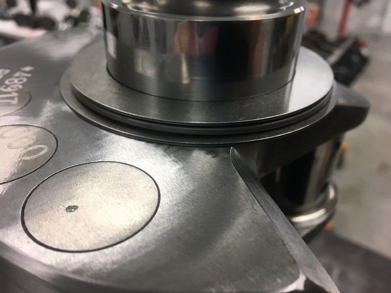

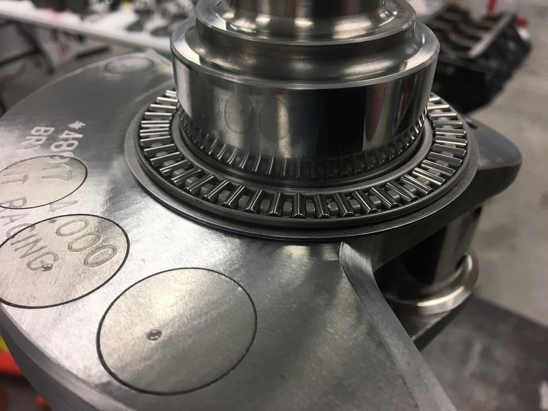

Below you can see the roller thrust as it is installed on the nose of the crankshaft itself.
base plate and rollers installed
complete roller thrust assembly

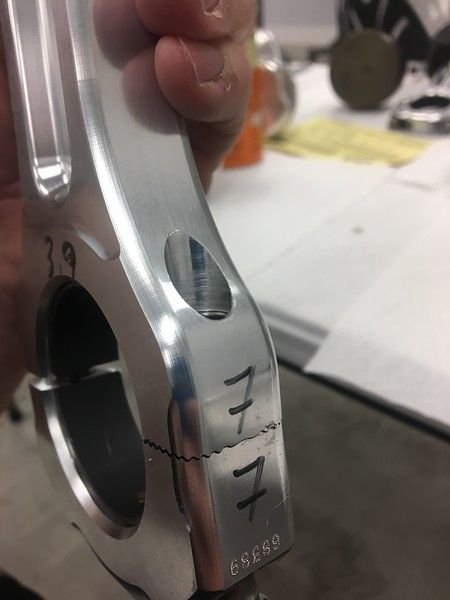

Now for our build, we are going to be using aluminum because it is light, strong, and less expensive for an engine that is torn down very often, replacing them is not of a concern. This actually maybe one of the lowest cost items in this particular build, at least the first purchase as these can be found for $1000 or less a set, but remember they will need to be replaced.
Here you can see the main components used. Aluminum GRP connecting rods, tool steel Wiseco piston pins, hard anodized Wiseco Pistons, and the aluminum pin buttons (more on those later).
Because aluminum does move around so much with heat and load, you will notice a number of differences when using aluminum rods in your engine. One of the biggest is how the cap is held in place. They will use a large bolt typically, and also the two pieces are split with an interlocking design to keep deflection at a bare minimum.
big end cap design
Another part that changes here, is that the bearings must be held in place with dowels. Again due to material growth, sometimes bearing crush can be an issue so small dowels are placed in the rods, with mating holes in the bearing to keep them from spinning in the housing bores.
Here you can see better of the interlocking design of the cap as well as the bearing dowel.
Bearing dowel in cap.
You will also notice that the small end is much bigger than most, again to cut down on deflection during use and provide more support to the piston pin.
small end
You may have noticed that these are of a slight I beam design, which most billet aluminum rods are going to be, as they only remove material from which it would do the least amount of reduction in strength but most in weight reduction.
Some with a keen eye may have also noticed that there is no bushing in the top of the rod as there would be in a Ti or steel rod. Due to the short life cycle, large clearances, and oiling system used there is no need to have a bronze bushing inserted into the small end of the rods.

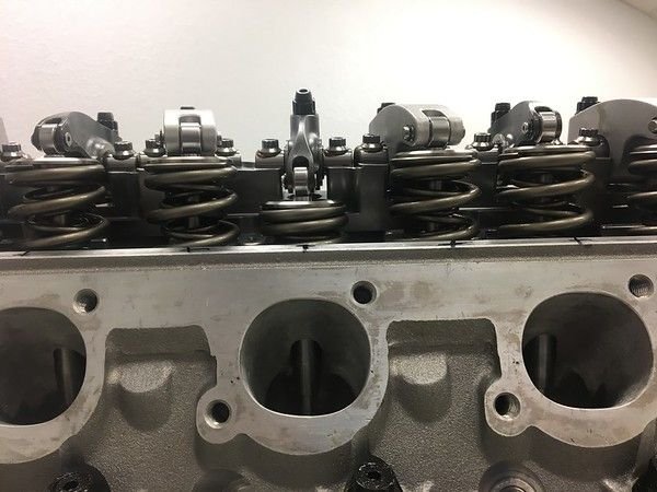

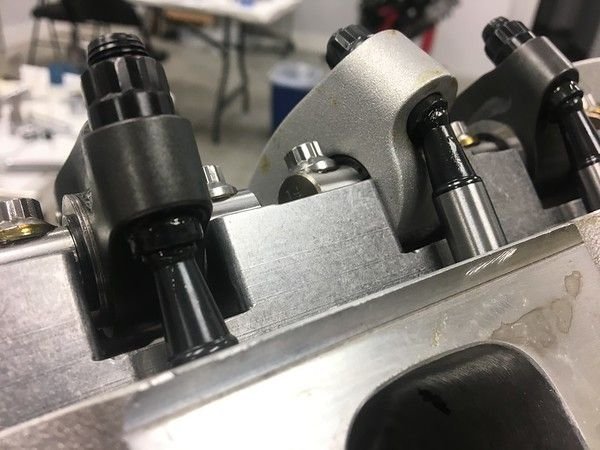

#5 Valvetrain

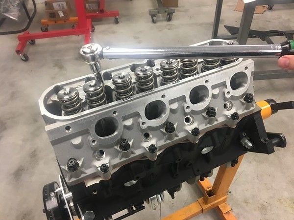

Because this is going to encompass the valves, rockers, heads, gaskets.....this update is going to have a lot of material thrown at you all at one time. So much of the next steps tie into the next part more so than earlier so bare with us.
The cylinder heads and valve train can sometimes turn into a mystery for a lot of people on their builds. There are a number of steps that you can take to try and cover as many basis as you can if you are trying something new but it does boil down to having a combo that is proven and tested to work together. Picking pieces here and there sometimes can result in very poor performance even though each individual part can be quite good....they just might not work well together.
Some points of this section I will not go into great deal with spec wise as to this particular build.
So off we go..

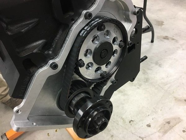

There are a number of ways the camshaft can be driven and timed to the crankshaft. The most common way for a traditional American V8 has been the timing chain. Of course there are different styles from non adjustable to adjustable, single or dual row chains. There is the every popular gear drive with the hot rodders that love the whine of the gears at speed and almost zero slack in the system. However with high RPM and race use engines, the belt is still one of the best ways to go. These tend to dampen out some harmonics and give an almost shock absorber application when running extremely high spring pressures. Because of the solid roller, high spring pressures, high RPM use and the face that we would like to be able to make adjustments to cam timing....a Jesel belt drive will be used on this engine.
Jesel belt drive front cover
You can see the bolt pattern of the Jesel is exactly the same as any LS front cover so the system can be used on almost any number of LS engine blocks, given you take the time to machine the front of the block for clearance for the cover to fit.
There are quite a number of parts included in the system.
Jesel belt drive
  • front cover
  • crank drive pulley
  • cam adjustable pulley
  • belt
  • cam plate with thrust bearing
  • hardware
The front cover bolts in using a o-ring seal to the block (after the block has been machined). You may notice the large hole in it, the cam retainer plate is o-ring sealed to this and bolted directly to the cam with the traditional three bolts. Now what makes this nice is that cam swaps can be done without pulling the entire front cover off. The cam pulley is then held on with one very large left hand nut, with the pulley slotted to allow for cam timing adjustments without tearing the front cover off the engine.
Below you will see the final assembly installed waiting on the balancer.
Belt drive installed along with ATI drive hub
Now you might be asking why not run a belt all of the time? Well they do stretch over time and will have to be serviced. In this case they are exposed to the elements so street use where rocks and debris can damage the belt and pulleys would not make it the best choice for a daily driver. For most builds out there, a chain is still the best of both worlds. The other piece to notice when applying this to an LS engine, there is zero room for an "internal" oil pump. When using the Jesel the engine must be a dry sump oiling system.
Timing is very critical on not only degreeing in the cam but also the balancer. Before the driver side head is placed onto the engine, we must make sure the timing marks on the balancer are correct and that we have the cam timing that we would like to see and locked in.

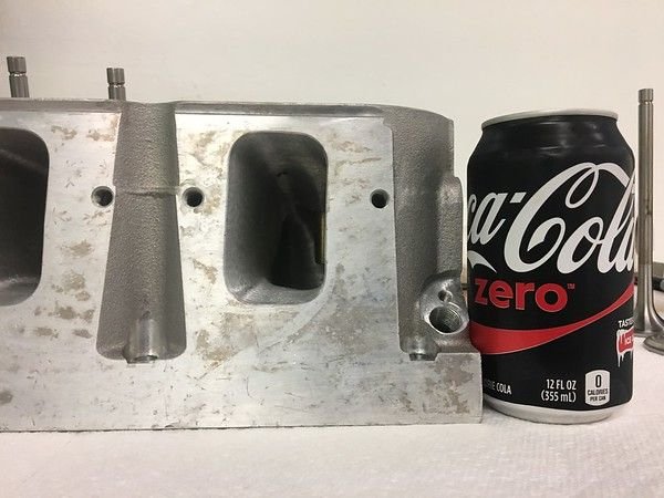

Cylinder Heads

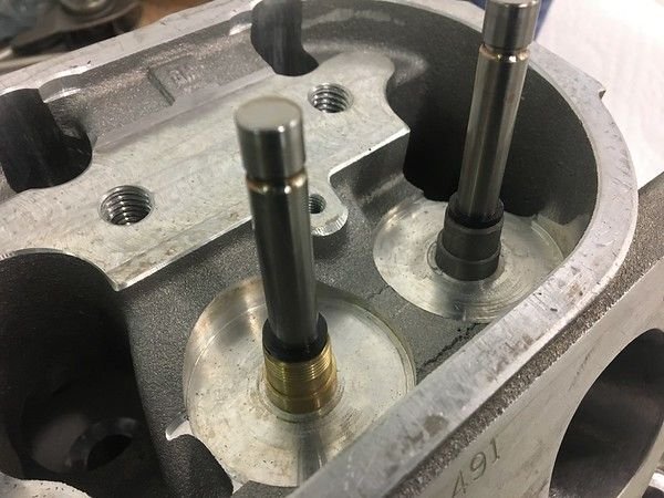

Here we could devote an entire book on, so we are not going to go into who's head is better than who's or the details of head porting. Cylinder heads in many ways are one key item in to knowing how much an engine will make, at least NA wise. The size of the intake valve, the intake runner size, and how much CFM it can actually flow will give you a good idea of what the potential of the engine is. Air flow velocity must also be taken into account along with the total air flow. This one is slightly different in that we are force feeding it, but never the less, the heads have to be able to flow air. So lets look at a few key components that make this one different. The heads we are using in this build are a 6 bolt GM LSx DR head ported and worked over by Greg Good with final assembly done here in house.
Bronze intake guide, steel exhaust guide

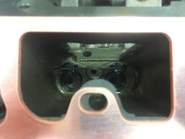

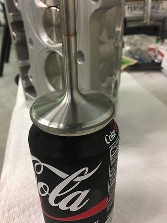

Because this engine is going to be forced induction, and a turbo at that, there is going to be a lot of exhaust heat in the head. A bronze guide will just not hold up to very high EGT's so in this case a steel valve guide is used. You will also notice a really small o-ring...that is pretty much the only valve seal that will be used. Since the engine will never see street use and will be torn down for rebuilds more often than your street car, the traditional seals are left off. This also allows slightly more oil to keep the valves lubed and cooled.
Both the intake and exhaust valves are made from solid Titanium and are longer than normal to accept the big springs and adjustable rocker arms that will be used.
Ti intake valve
Ti exhaust valve
For an idea of size
Intake valve
intake port
exhaust port

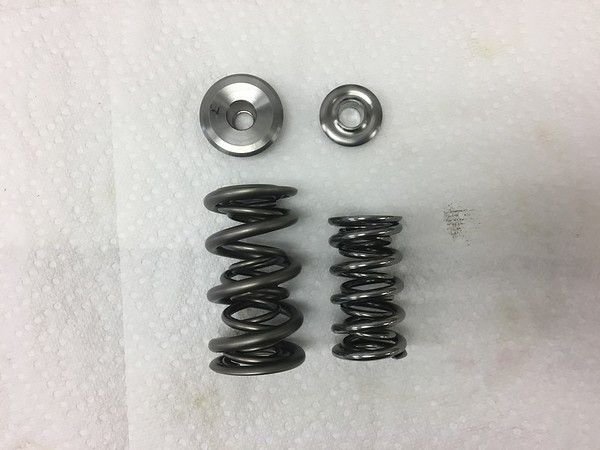

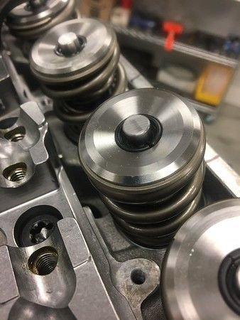

To keep the valves under control we are using a triple valve spring from PSI. High RPM, high boost, and a solid roller cam is going to require a higher than "normal" performance valve spring. Seat pressure on these springs is a little over 450 lbs which is more open pressure than what you will find in a common place hyd cam kit for your street car. Open pressures can exceed 1200 lbs and the springs are able to support over 1" of lift without coil bind issues. Here you can see them apart compared to a popular dual spring package commonly sold online. These are required for the extreme lift, rpm, and boost even when using a very light valve as we have shown above.
Assembled springs
Springs apart
Big springs....require big spring compressors as well.
Once the heads are cleaned, springs setup for height, they are assembled and will be installed.

Once the lifters are installed, and the gaskets embossed we take to bolting the heads down for the final time.
Cylinder head install for final time

Since we had taken the time to measure the pushods during the head gasket seating procedure they arrived without much delay in doing assembly for the final time. We checked for not only the correct length but also for the correct diameter. Again, due to the extreme valve spring loads, using a strong pushrod to fight against deflection in the valve train is very important. Intake and exhaust lengths are different as in most engines of this caliber, but we also strive to use a much larger diameter than most might think of. These are a dual taper 1/2" to 7/16" with dual tool steel tips to make sure they clear all components involved.
Custom double taper pushrods with tool steel tips on both ends.
Compared to a "beefy" stock LS7 3/8 pushrod

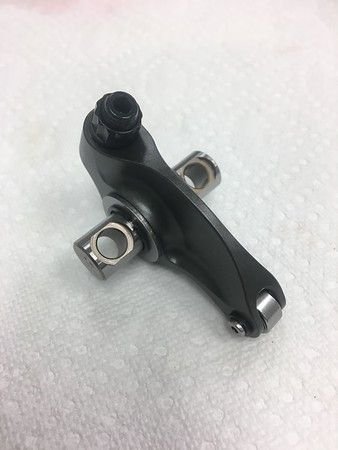

The pushrods will be operating a set of adjustable Jesel shaft mounted rocker arms setup for the LSx DR cylinder heads.
Aluminum 1.8 ratio intake rocker arm
Steel 1.8 ratio exhaust rocker arm
You are going to be quick to notice that those two arms do not look the same....and they are not. There are two main reasons we chose to run a dual style rocker. Cost and weight. Because the loads on the intake rocker arm will not be nearly as high as the exhaust, which is opening against high cylinder pressure, we can run a lighter aluminum bodied arm. The aluminum arms also reduce cost vs running steel arms on both intake and exhaust side.
Prior to install, each rocker is inspected, cleaned, and oiled at all pivot points. Assembly lube placed at both ends of the pushrods and at the bottom cup of the adjuster on the rocker so nothing is dry on start up.
Rocker arms installed, ready for lash
Here you can get a good idea of just how much these rockers are going to have to move. You will also notice how much you need to take care of your clearances, as some are very tight, as in the intake rocker to pushrod.
exhaust at full lift
intake at full lift.
Once all are installed we will spin the engine over by hand a few times and remove a couple rockers to check for a wear pattern on the tops of the valves.
Wear pattern right in the middle, even with over 0.9xx of lift

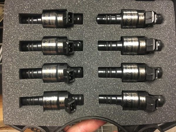

Yes you are reading that correctly, 700 lb/hr injectors

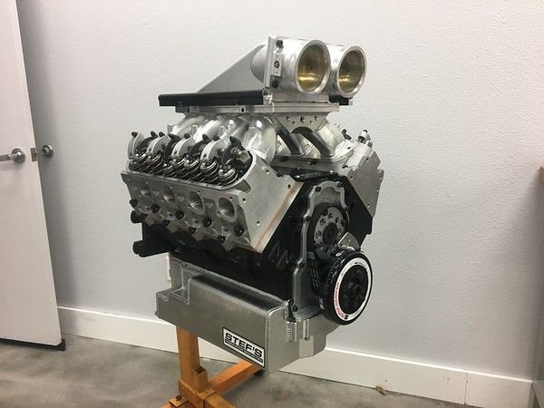

Intake manifold, rails, and TB's
Nice sized pair of TB's
Side shot
So, that should give you a quick look inside what is going on inside a big HP build. The parts you do not see is the time it takes to assemble something like this. Unlike most normal street and hot rod engines these typically will have to be assembled, a couple times during the build and torn back down as some parts may interfere with others requiring machine work, and re-cleaning before going together.
