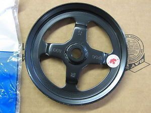

I didn't mention that I rebuilt the engine 700 miles ago and replaced all the accessories except for the tensioner. the belt didn't feel super tight. It doesn't slip during normal driving. only hard acceleration.
I will check the pulley alignment in the morning. The power steering pulley may be a little off.

You might want to upgrade your P/S pulley to the Z06 version before you put your car back together.
It won't help the belt squeal problem any - but you'll be saving yourself tons of headaches down the road if you ever need to replace your P/S pump or remove the accessory drive bracket later!
