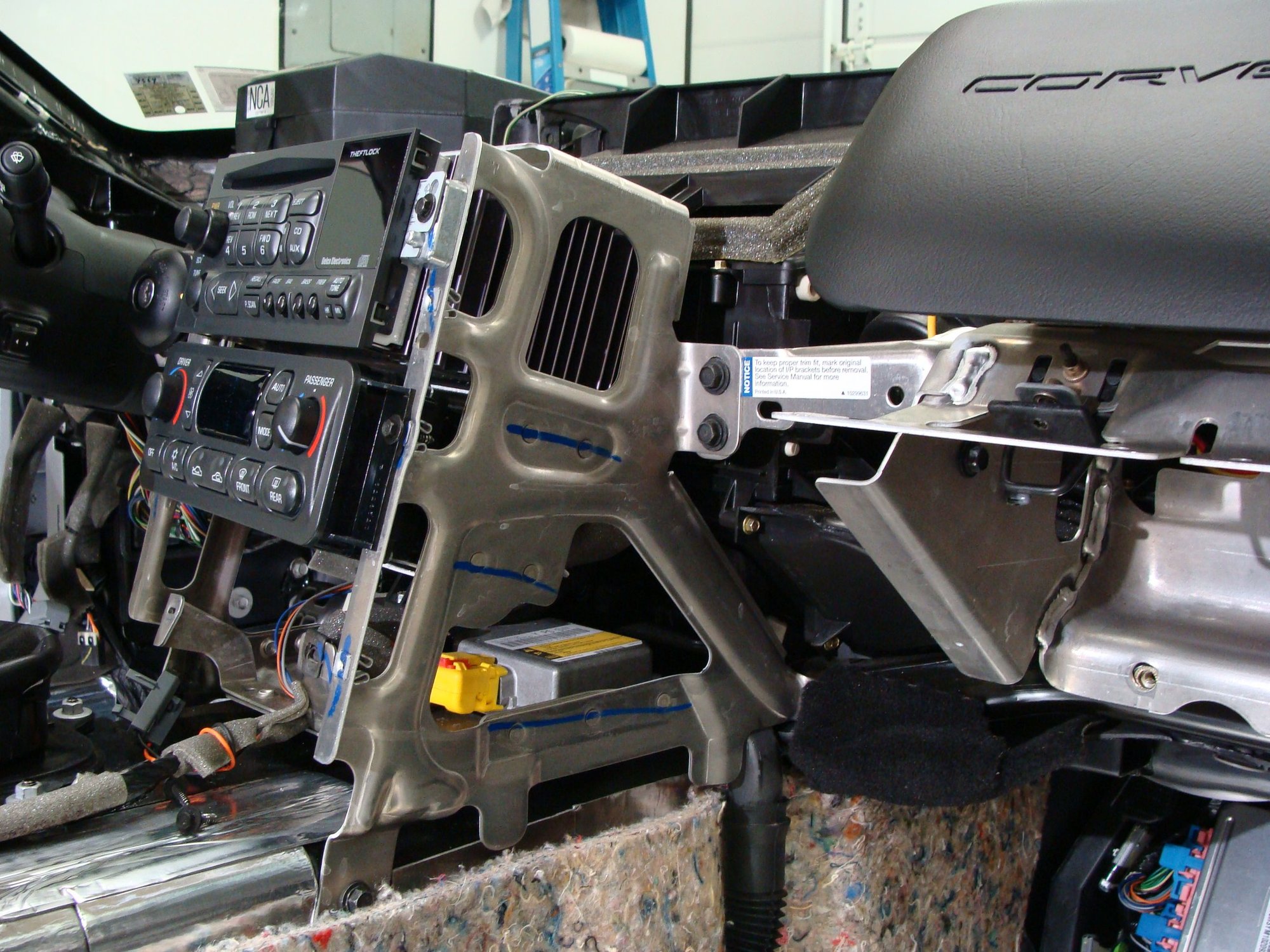

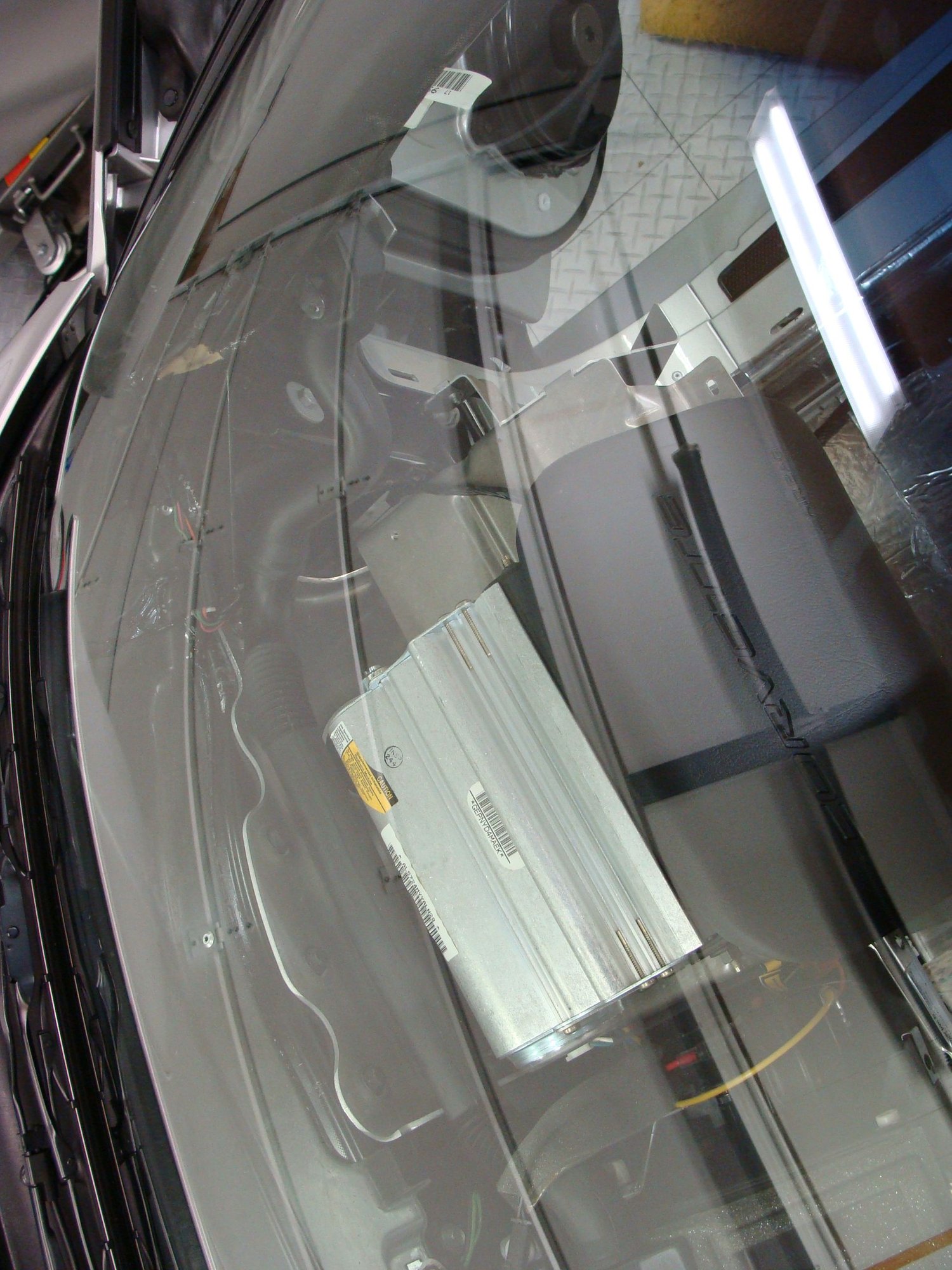

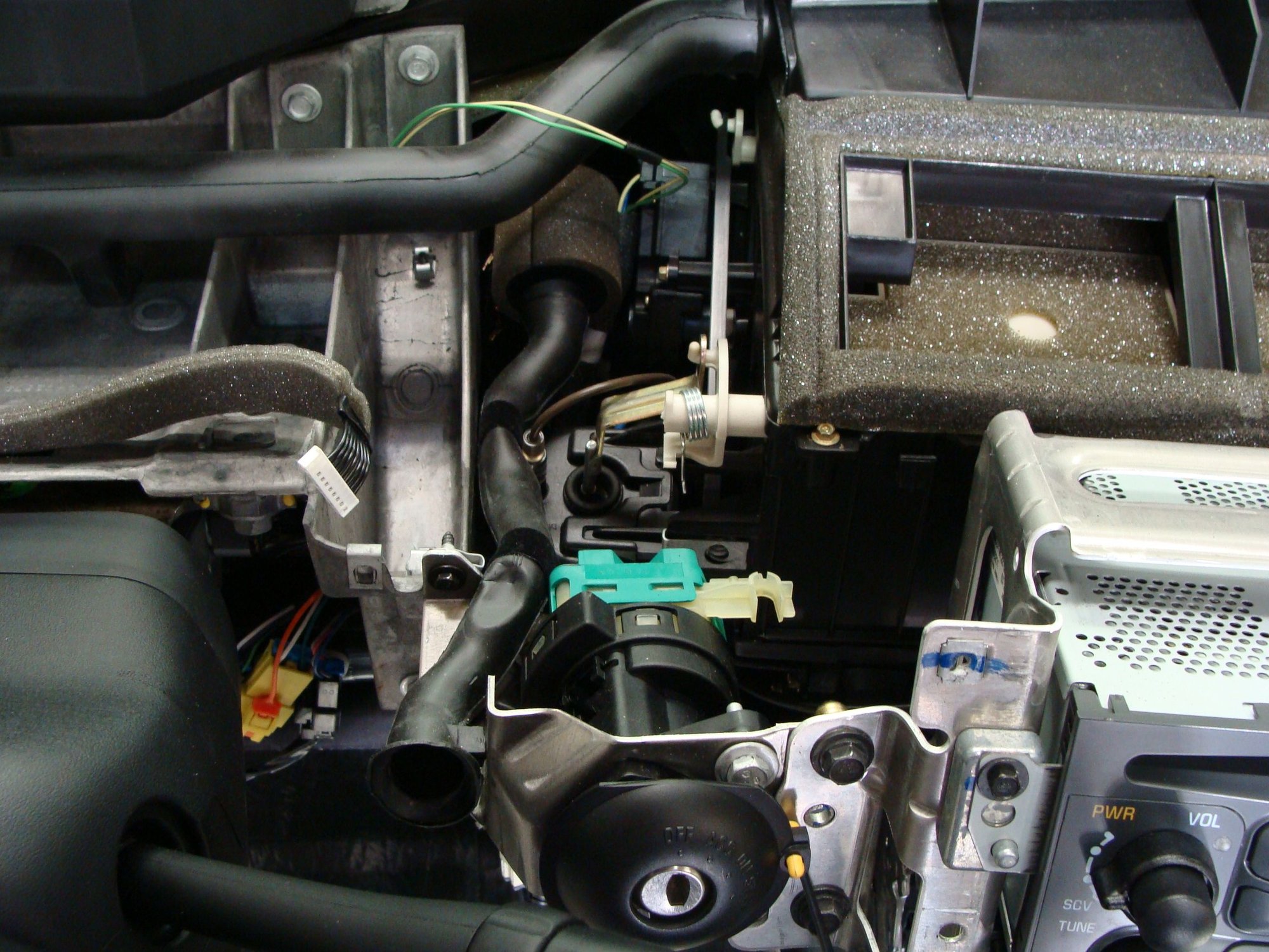

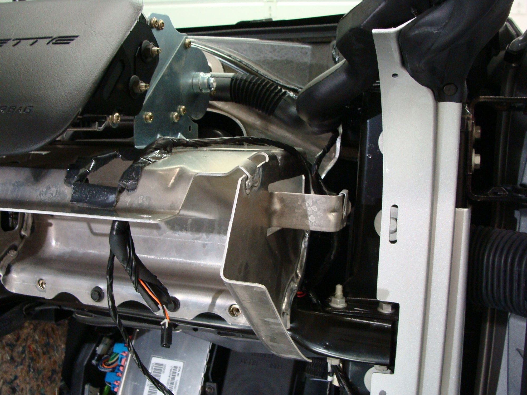

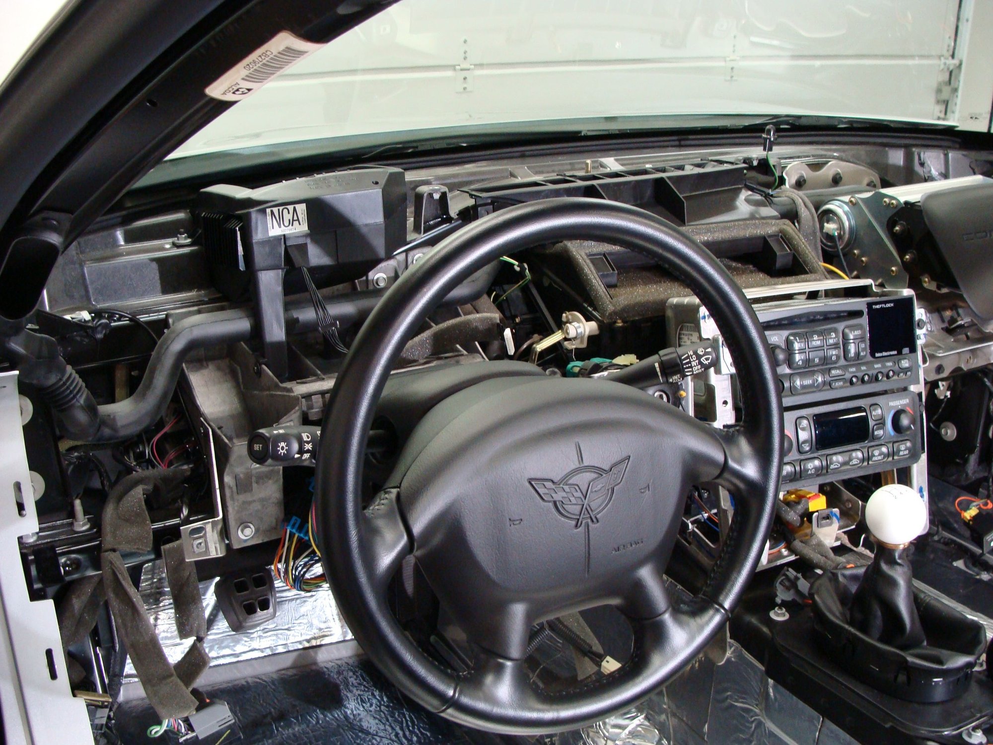

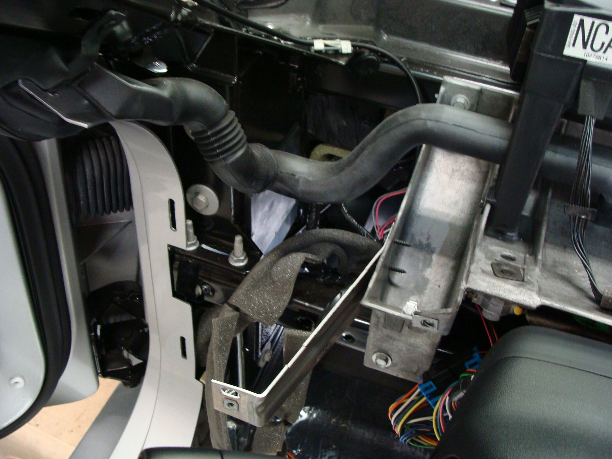

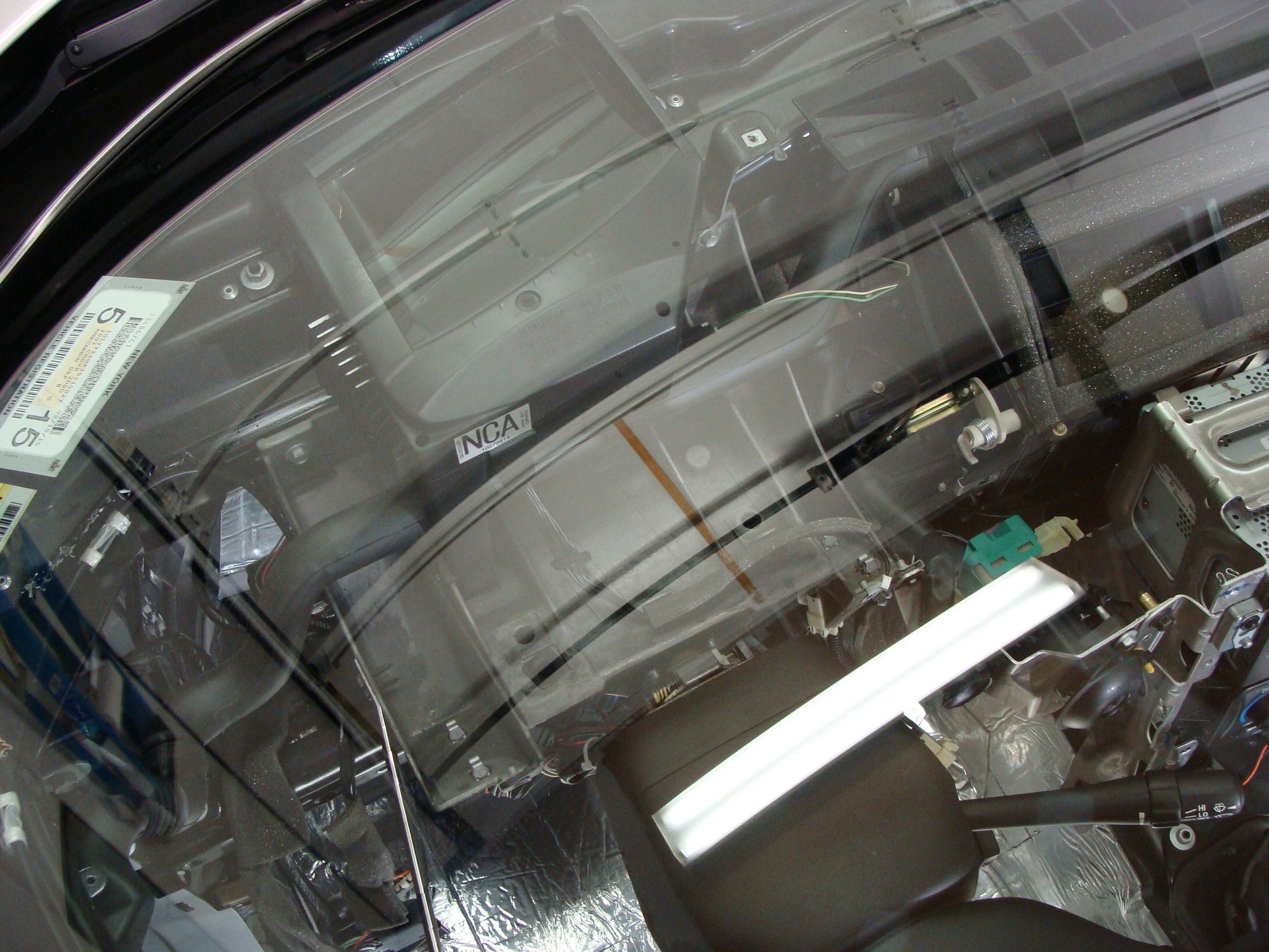

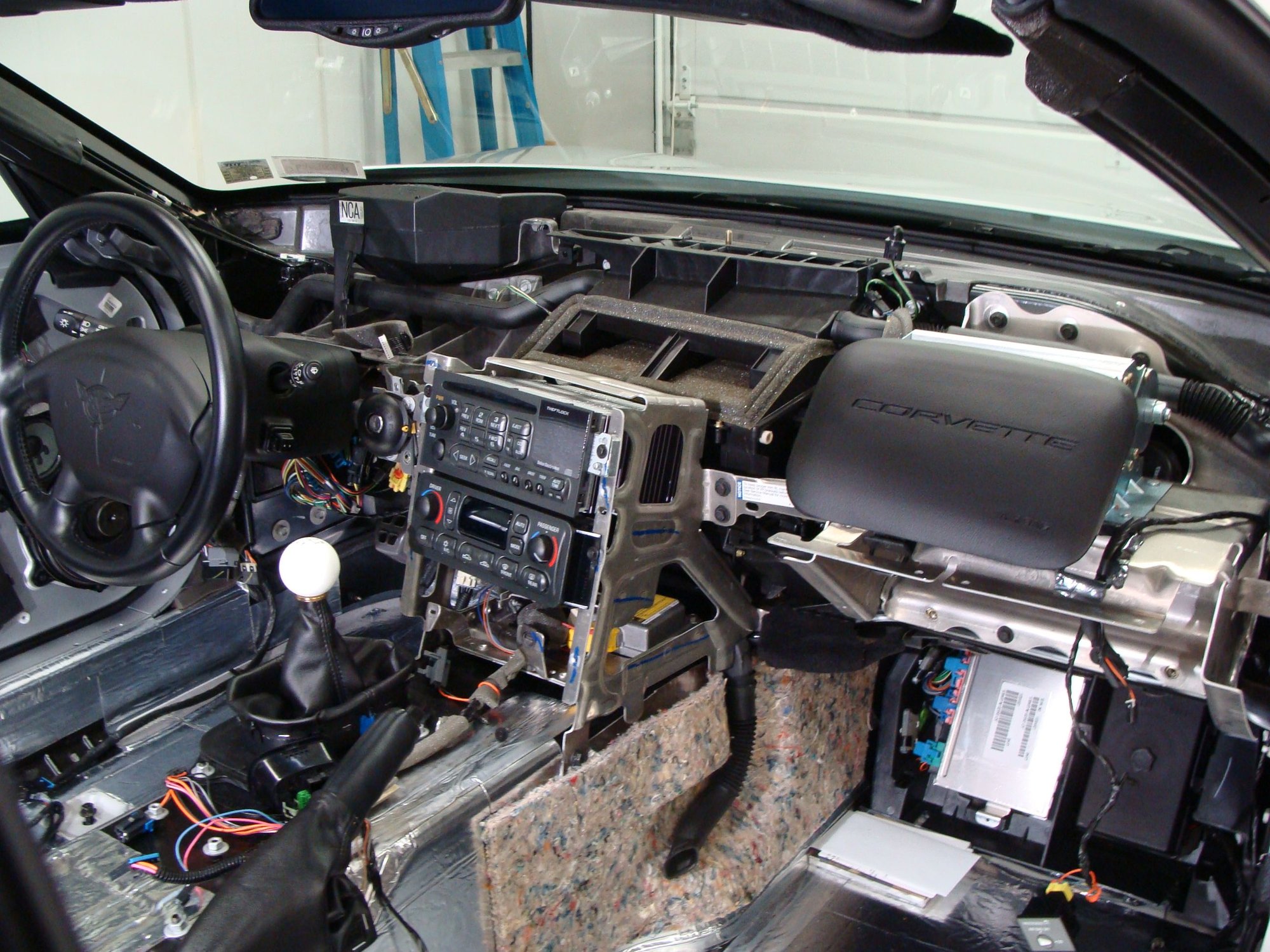

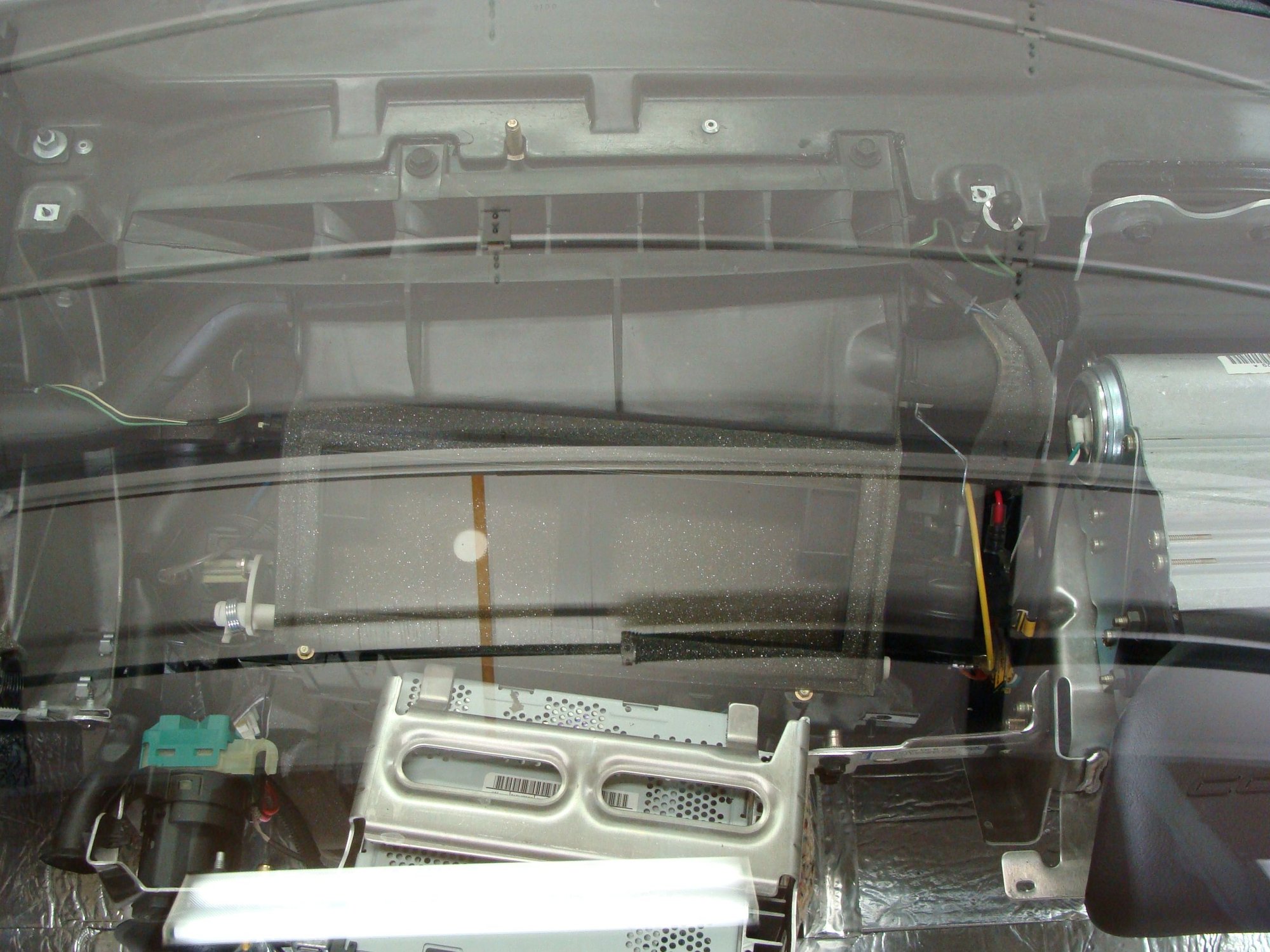

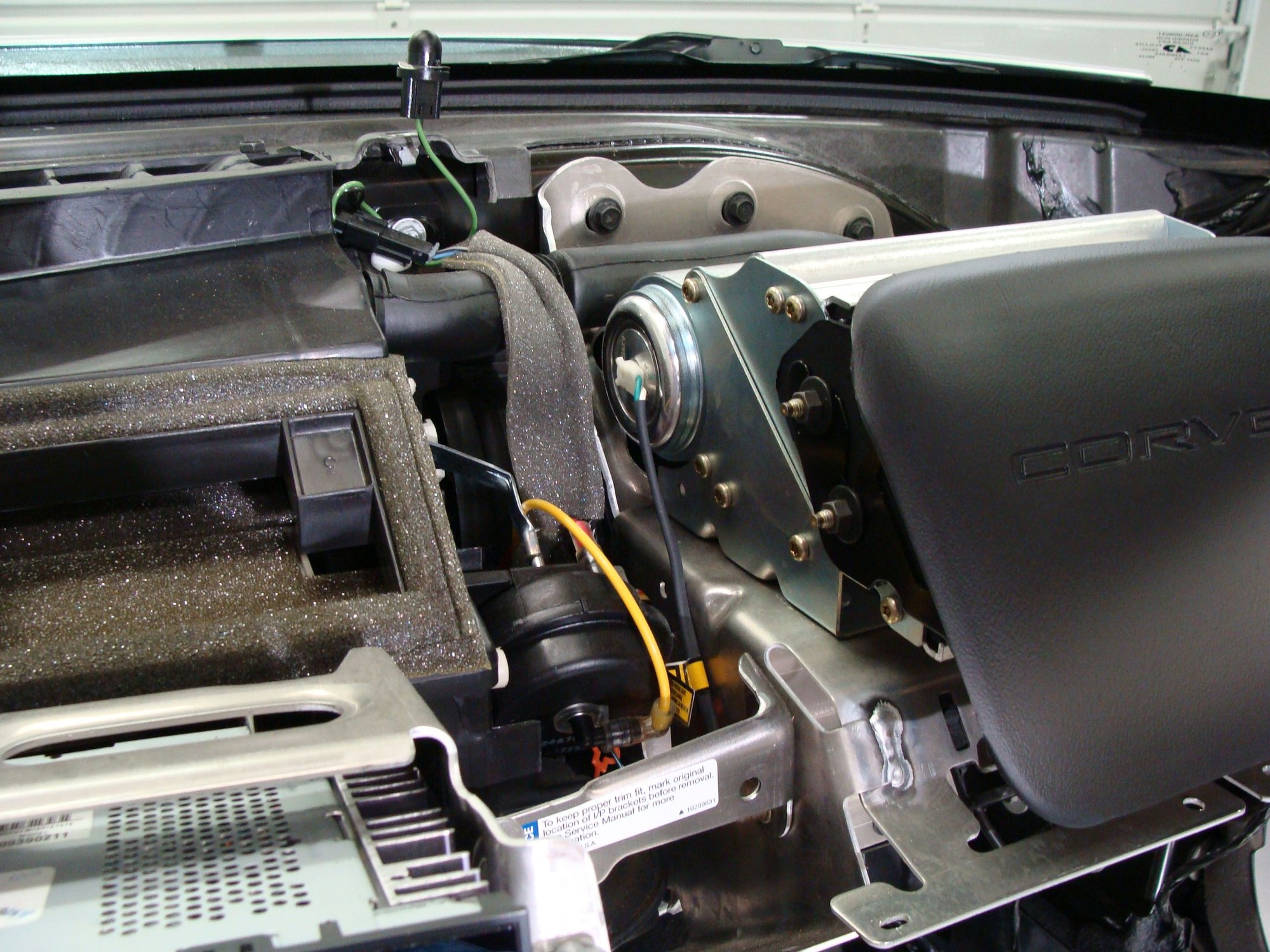

Some pictures with dash removed maybe these will help.
