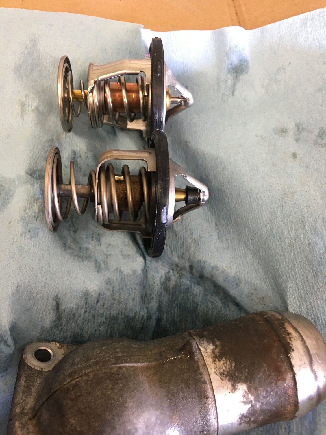

Okay so I just pulled the thermostat. I noticed that the oem one is slightly longer than the "oe" replacement 186 one I just bought from summit. Does this matter? Here's a few pics. Original on the left, new on the right.

Also I noticed that there's less resistance on the spring of the old thermostat than the new one. I don't know if that means it's wore out or not but I thought I'd mention it

You can easily test the thermostats. Put them in a pot with water completely covering them. Get a thermometer and make sure it covers the temperature range of the thermostats. Turn on the stove and, checking with the thermometer, make sure they open when the water reaches the right temperature.
Less spring pressure on a thermostat will usually allow it to open sooner, so I doubt that's your issue.
